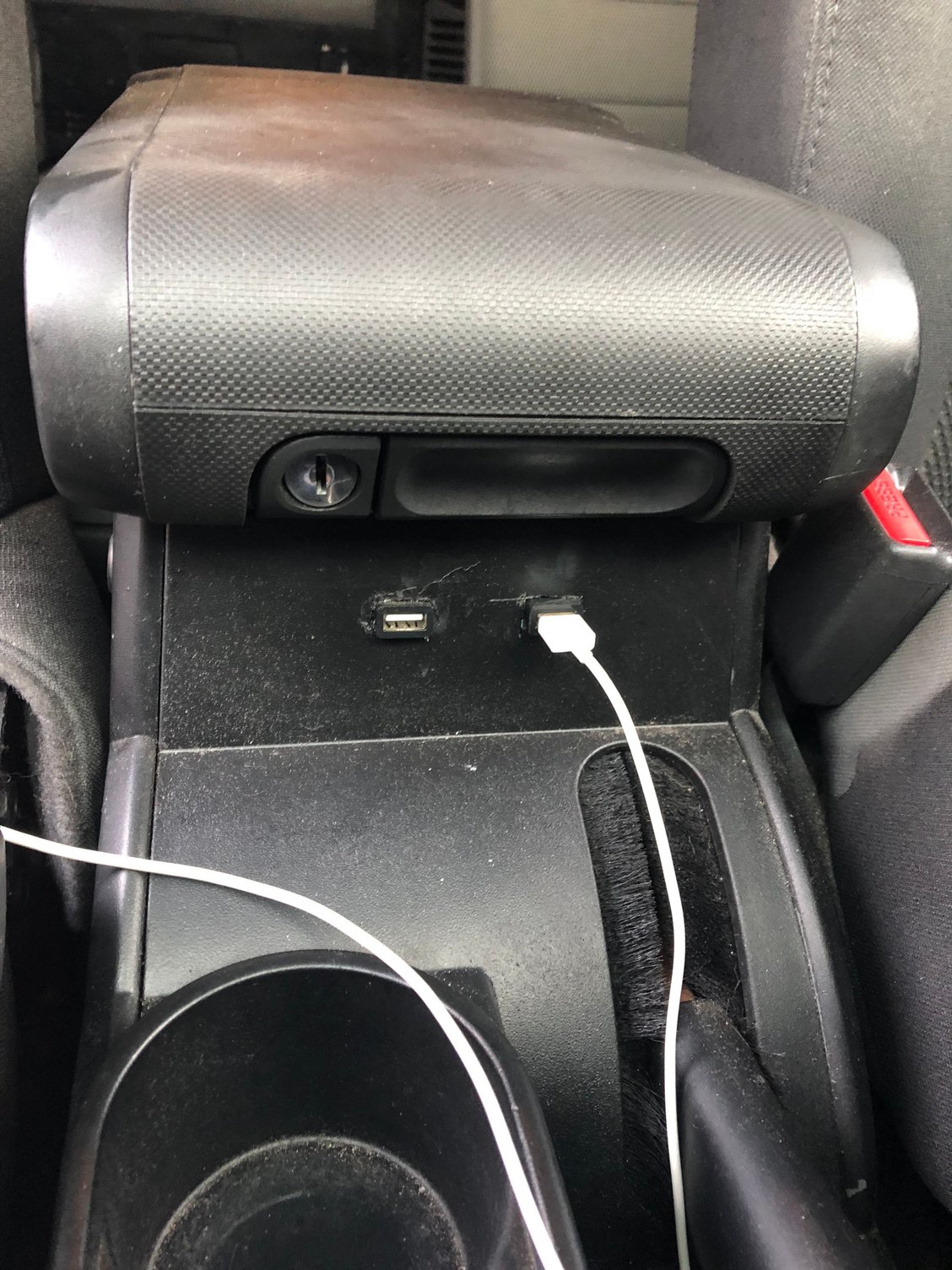

If you have a 2010 like me there is no usb female so i made mine. I bought a new headunit for my jku, there were 2 usb ports for it. One for apple carplay the other for android auto. I cut 2 usb size holes for into the centerconcel. bought a 10 usb cable and streched them the length to the 2 holes in the centerconcel, i added some liquid nail type stuff to leave them in place. The liquid nail took kinda a while to dry b/c i did this in the summer in Florida, and even though it sat in a garage it was about a week before it was completely stable. I love it, It works great and if someone in the passanger seat needs a charge i dont need to give up mine. Also love how its descrete it is. Taking everything out gave me a chance to paint it b/c i hated the gray and made it all black.
