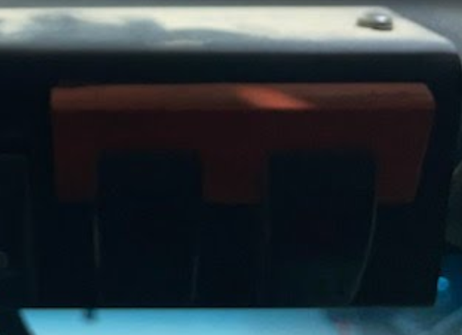

My "safety" solution is ultra high tech.
