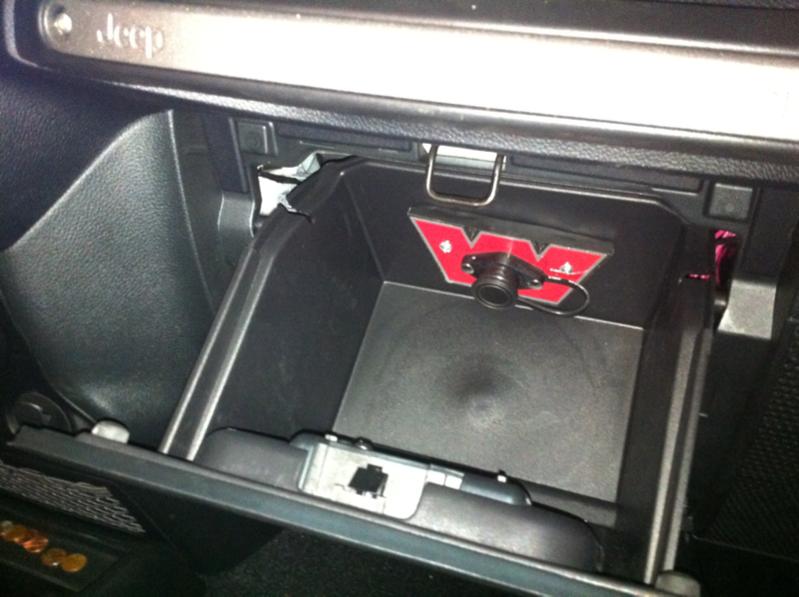

I moved mine (control box) under the hood and put the plug inside the glove box. This way the water would have to come up by my battery before the control box got too wet.
That is one good idea.
