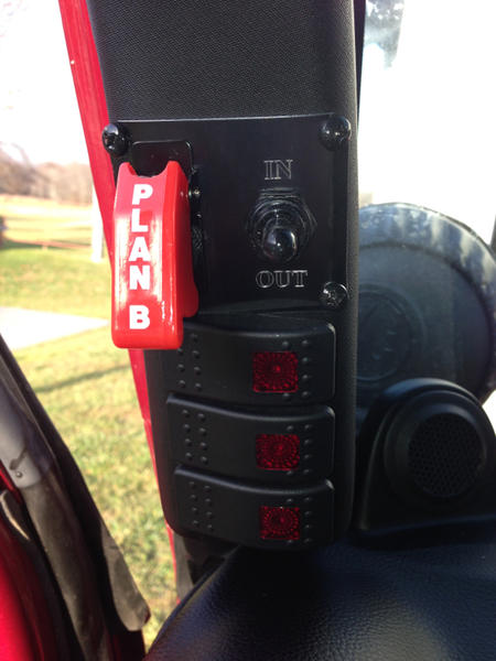

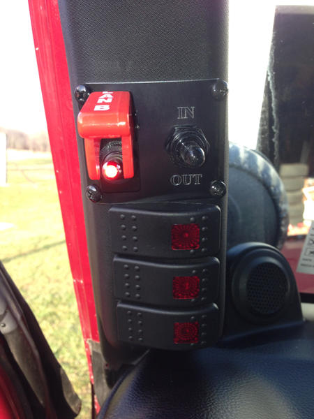

Here is mine, I left the solenoid box out on the winch, but connected controls into the cabin. Got the wiring kit and switches from 12voltguy.com
ID:	465442   Click image for larger version

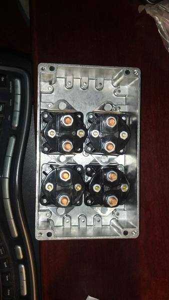

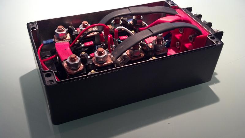

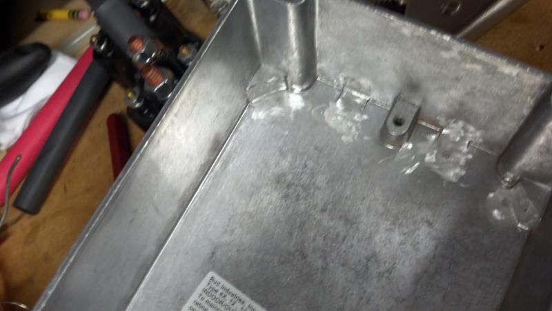

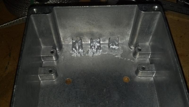

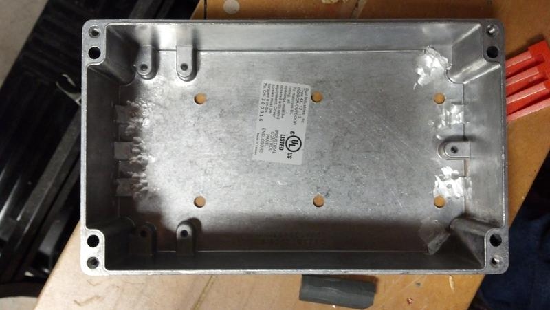

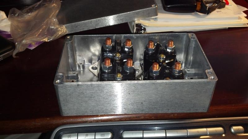

Here are some more pics of the winch solenoid box rebuild.
Name:	Step 01-test fit.jpg
ID:	472443Click image for larger version
Name:	Step 02-test fit.jpg
ID:	472444Click image for larger version
Name:	Step 03-remove-mounting lugs.jpg
ID:	472445Click image for larger version
Name:	Step 04-remove more lugs.jpg
ID:	472446Click image for larger version
Name:	Step 05-drill mounting holes.jpg
Old Jun 27, 2013 | 12:51 PM
maxspongebob's Avatar
Joined: Apr 2010
Posts: 265
From: Northern Virginia

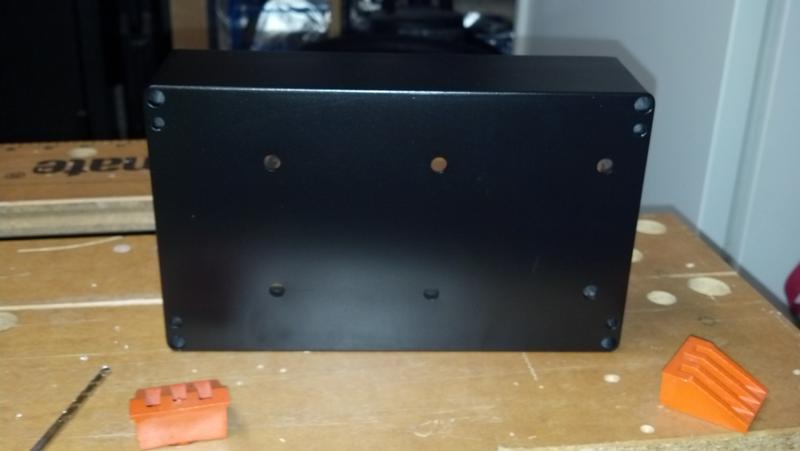

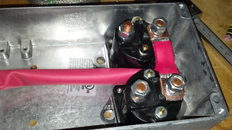

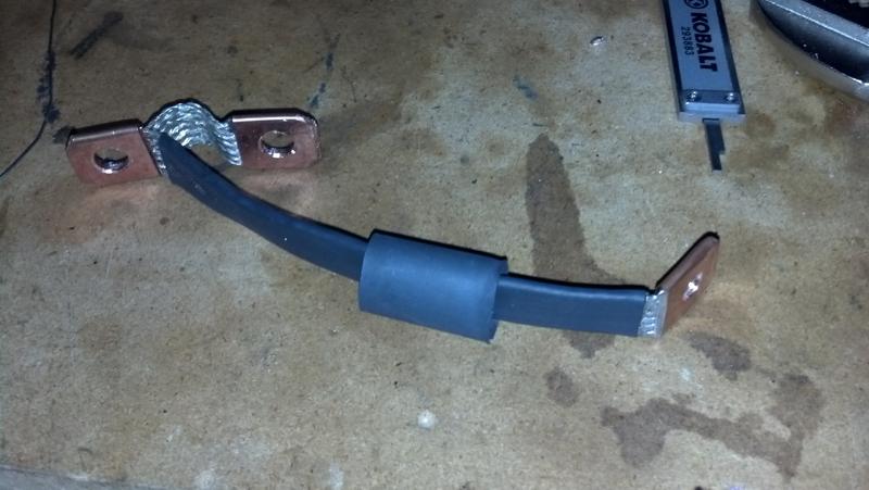

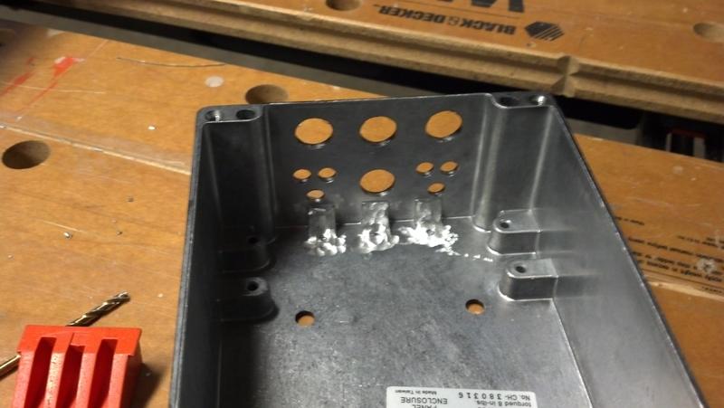

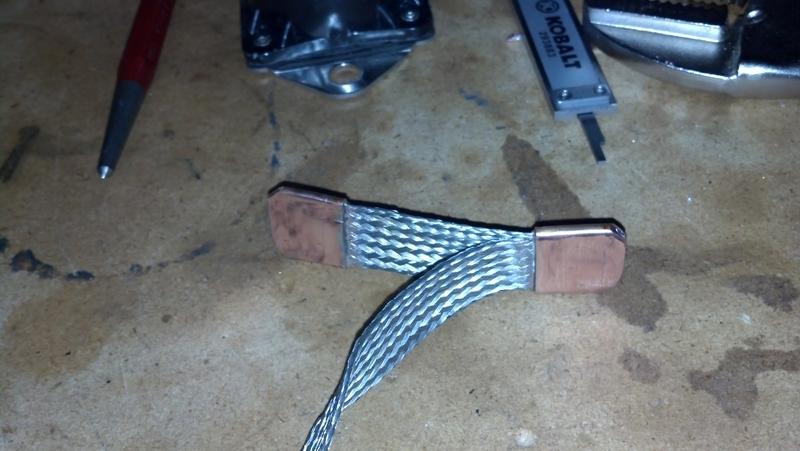

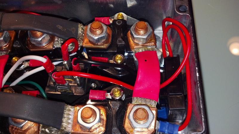

Steps 6-11
Name:	Step 06-drill holes for power feedthrough.jpg
ID:	472448Click image for larger version
Name:	Step 08-Build power cables from copper strap and pipe 1.jpg
ID:	472449Click image for larger version
Name:	Step 09-Holes in power cables and add heat shrink.jpg
ID:	472450Click image for larger version
Name:	Step 10-Test fit power cables and solenoids.jpg
ID:	472451Click image for larger version
Name:	Step 11-Test fit power calbes 2.jpg
Old Jun 27, 2013 | 12:53 PM
Joined: Apr 2010
Posts: 265

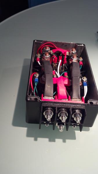

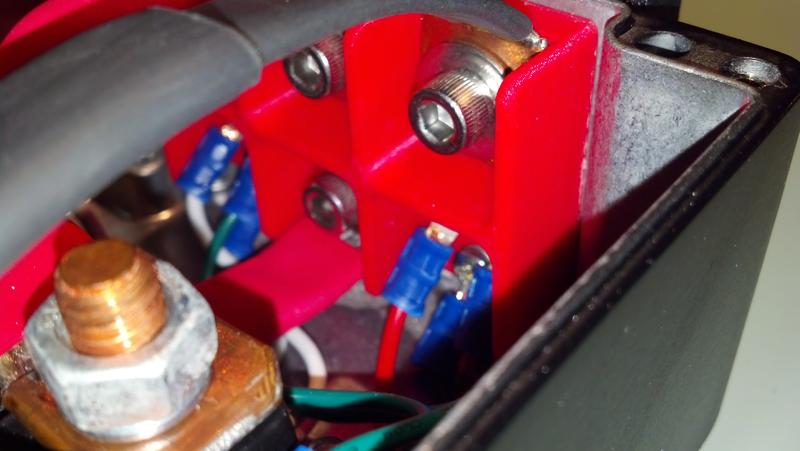

Steps 12-14
Name:	Step 12-Paint Enclosure.jpg
ID:	472453Click image for larger version
Name:	Step 13-Mount Power feedthrough on inside and outside and make all connections.jpg
ID:	472454Click image for larger version
Name:	Step 13-Mount power feedthrough on inside and outside and make connections 2.jpg
ID:	472455Click image for larger version
Name:	Step 13-Mount power feedthrough on inside and outside and make connections 3.jpg
ID:	472456Click image for larger version
Name:	Step 14-Done 1.jpg

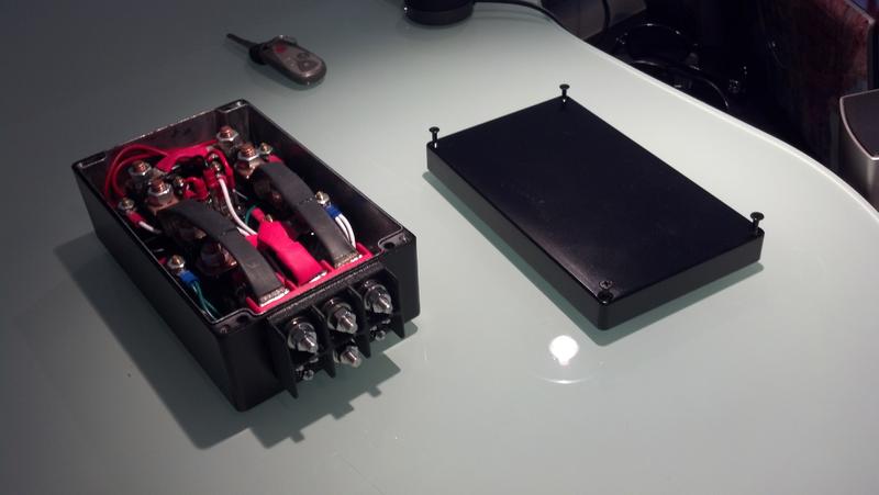

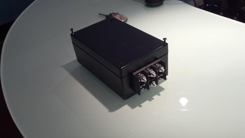

Old Jun 27, 2013 | 12:54 PM
Joined: Apr 2010
Posts: 265
Steps 14-finish
Name:	Step 14-Done 2.jpg
ID:	472458Click image for larger version
Name:	Step 14-Done 3.jpg
ID:	472459Click image for larger version
Name:	Step 14-Done 4.jpg
ID:	472460Click image for larger version

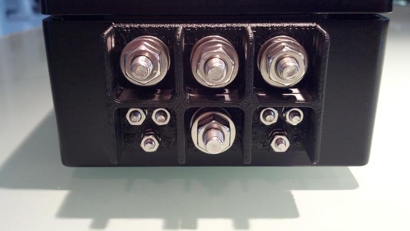

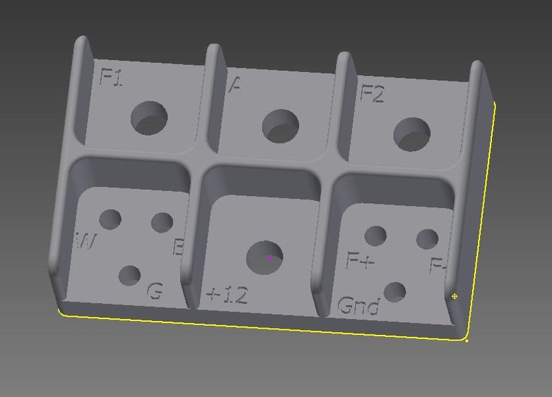

Name:	WinchPowerFeedthrough made with 3D printer.jpg
