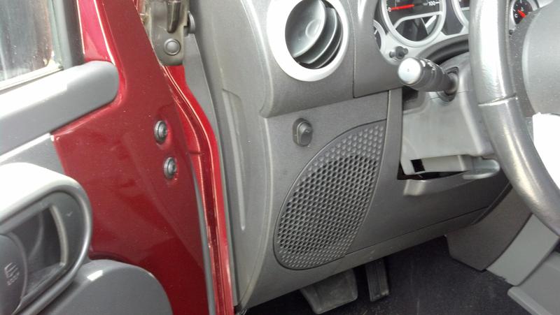

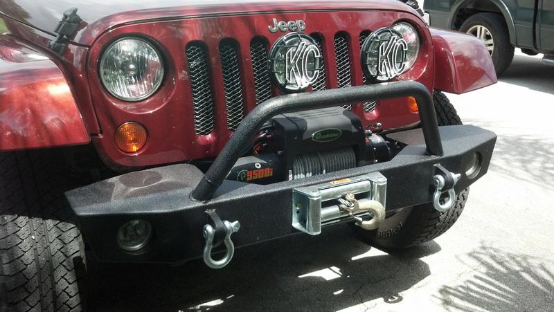

I recently installed the KC Apollo long rangers. Since I only wanted them on when my brights are on, I got power (white wire with 3 amp fuse to switch) from the high-beam light wire behind the passenger side lamp. I installed the KC switch in the dash above the driver side speaker. Now I have the option of leaving the switch on and have KCs come on with the brights or turning the switch off and having the brights on alone.
