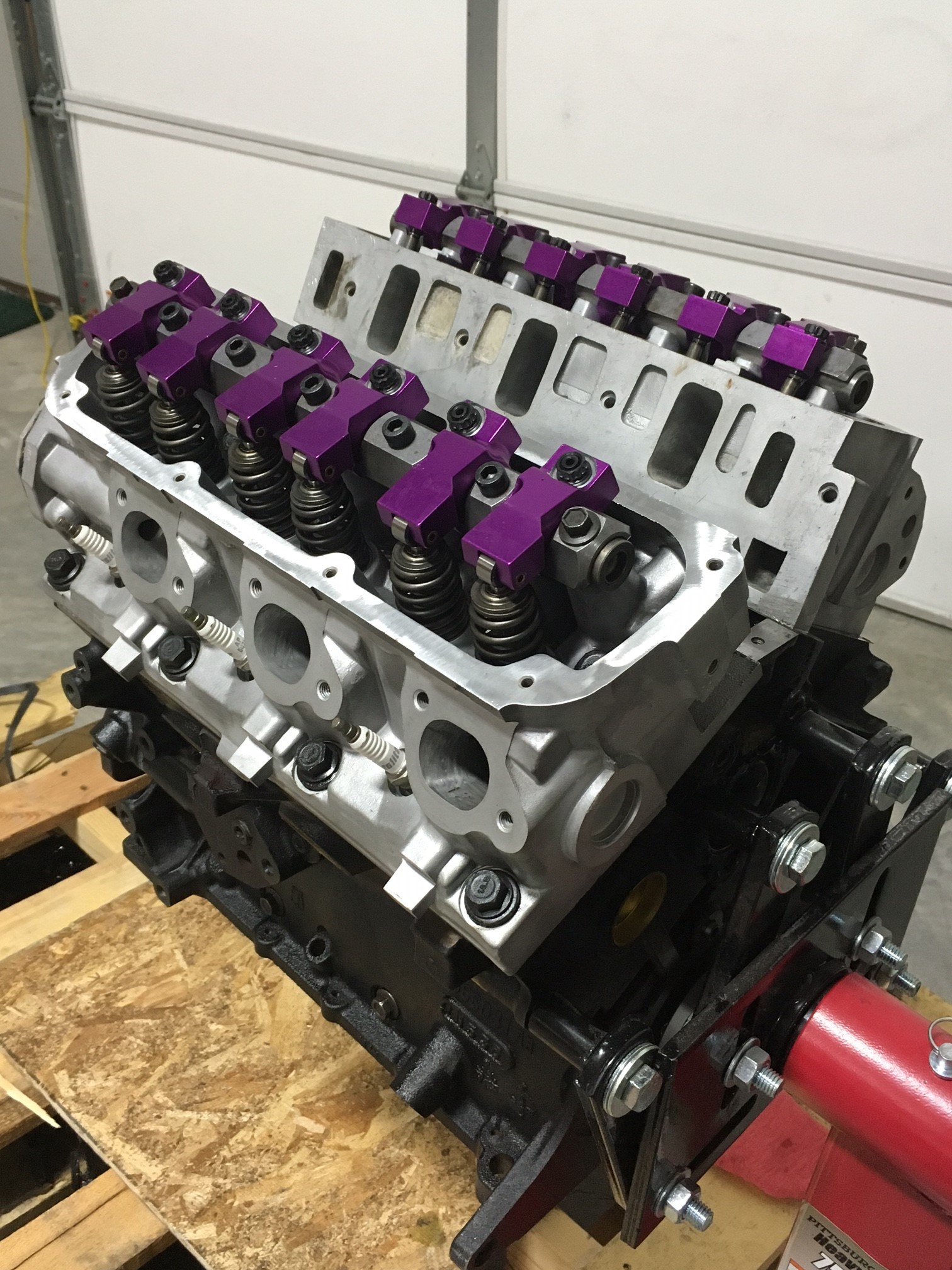

505 Performance 3.8 HO
Well , pulled the engine and tore it down...... Could not find an issue....
So, I have sent it off to 505 Performance to get them to rebuild. I have heard good and bad.
I talked to Zach and he told me everything I wanted to hear , so now we wait..
He told me it would be a short turnaround and I would be back on the road.

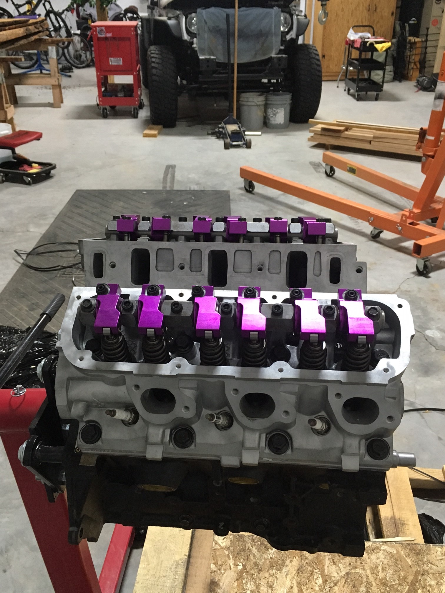

505 Performance rebuild
Engine installed and started ! going thru the break-in process. All seems well ....!
I had questions for Zach during the process , he answered them Promptly . Zach was a Great help to me
during this process. A Big THANK YOU to Zach @ 505 Performance !!

Super Moderator
With the 505 rebuild- did you elect to have them punch it out to the 4.1 or just do a rebuild on what was there? Any other upgraded posts besides what we can see in you're pics?
My motor doesn't peck but at 150k miles I know that a day will come where I'll have to do something about the motor. The only other person that had long-term experience with 505 (and bothered to report on it) was all negative.

I did not do the 4.1 stroker , I done the "3.8 Jeep JK HO 240hp Longblock" with the midrange cam .
I have only put about 100 miles on the new motor , but it is smooth and sounds good. I will be able to tell more about it in a few weeks. I am happy with it so far and happy with Zach's help during the process.
