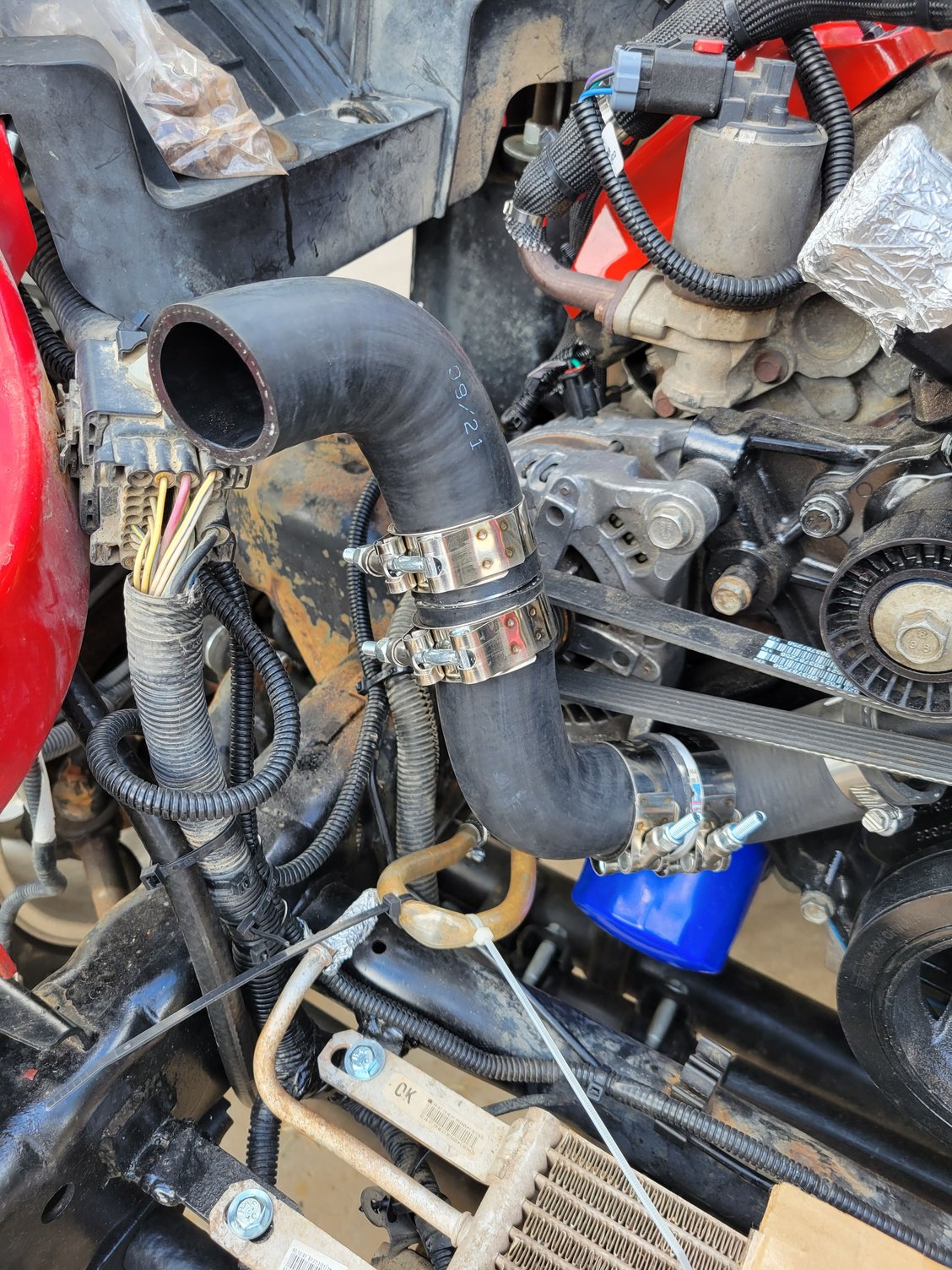

Main reason for this post is to show the lower radiator hose. It's a combination of 3 hoses, joined by two billet aluminum, barbed couplers and sealed by T-clamps. I've done this several times now in other projects and it works fine. The top hose is build similarly.
I try and get the best routing for the radiator hoses to eliminate kinks and rubbing.
T- clamps on the couplers and the water pump and radiator side are joined by regular worm clamps.
