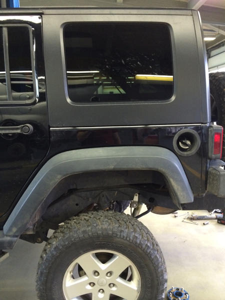

I have the bumpstop extensions down to an art form if you need help just hit me up. I'll post a pic of the back drop on a lift so you can see rear down travel.
