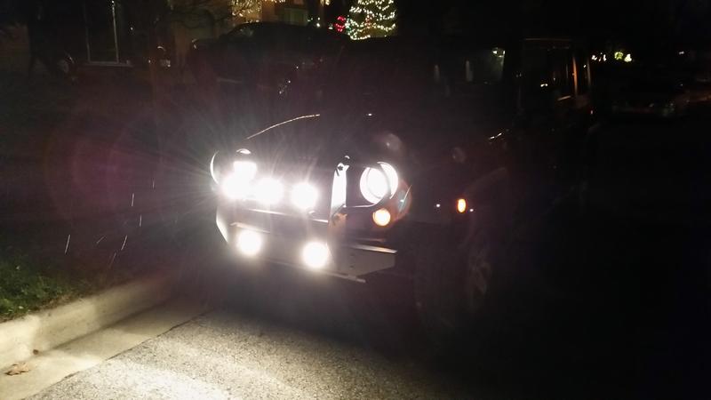

And this is the final product. Installed an Olympic 4x4 Products front Rock bumper with the grill guard and brush guards and three 5" 55W KC Apollo lights. The outer two are driving lights and the middle one is a long-range light. They're running through a KC relay I bought designed for two lights, but I built myself my own little custom splitter to handle the third light in the middle. The switch wiring doesn't actually run through the firewall and instead goes under that hood cowl up near the windshield and through the outer windshield bracket, where the switch is mounted on a half-inch hole I drilled in the interior a-pillar trim.

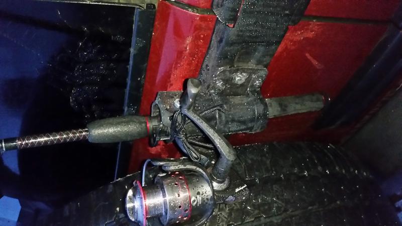

I built a simple fishing rod carrier from supplies you can find at the hardware store that attaches to the factory tailgate hinge bolts.
If you'd like to see how it's built so for inspiration to adapt your own design, go here: https://www.jk-forum.com/forums/jk-w...4/#post4032176
<img src="https://www.jk-forum.com/forums/attachment.php?attachmentid=590357"/> I built a simple fishing rod carrier from supplies you can find at the hardware store that attaches to the factory tailgate hinge bolts. If you'd like to see how it's built so for inspiration to adapt your own design, go here: https://www.jk-forum.com/forums/jk-w...4/#post4032176
