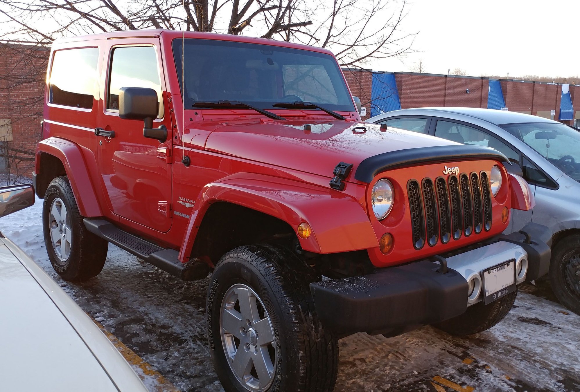

How it began, bought a used 2011 Jeep JK almost three years ago. Basically was stock other than a tire tread pad on the console, upgraded hood latches and a MORryde tailgate hinge upgrade.
First thing I added were Weathertech floor mats and while at the shop getting an oil change we discovered one bad shock and one bad spring. Also at the shop I changed all the fluids over to AMSoil. Some folks like the stuff, and others not so much. I ran AMSoil in my 77 Celica way back then because it stayed fluid in some really cold winters that killed the tranny with stock fluids. A friend owns the shop so and charges a fair price so I just go with what he has. Otherwise I usually run Mobil 1 in the other cars.

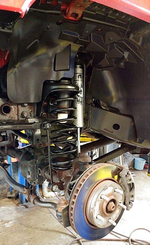

The Mopar Fox 2" lift kit installed. The kit for the 2011 and older JK does not come with the front drive shaft. No idea why, the 2012 and newer kit does.
So since I had time I decided to order in the Mopar kit, I also noticed that the clutch felt a bit worn and the Jeep has high mileage, over 200,000 kms and since they were quiet I decided to do the clutch. When we took out the original clutch, yup it was due for a replacement. Also since we were in there I did the rear main oil seal, it was wearing slightly so why not since we were in that far. So after the lift and internal work, ta-da! Well ok it was more like, yuk...

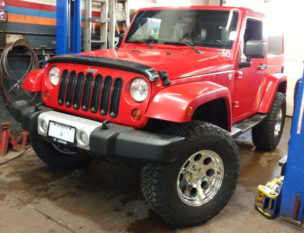

Yup the lift was nice but the look of the Jeep sucked. So off to the internet to look at wheels. I already had settled on BFG KO2's so the tire side was covered. But finding a good deal on wheels up here or even getting a decent variety is the real challenge! I spent hours looking at various sites plus 'trying out' different wheel styles on the various visualizers and eventually compromised on Pro Comp series 69 wheels. Yeah I'm old school....
Since I had the lift I went with BFG 315/70 17's.
Ok that looks better.....

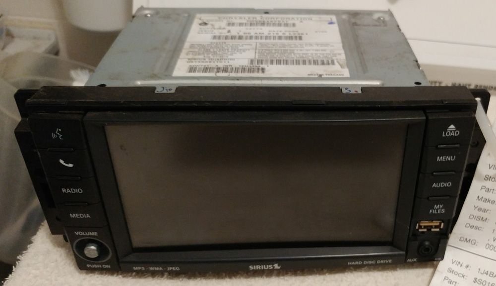

The fun began when the radio arrived and it was missing the volume knob. The seller refunded me the cost of the knob so picked one up from the dealer. Installed the radio, powered up but no volume, now I have the base radio but upgraded speakers with sub so after doing some research I discovered that I need to have my computer flashed to work with this radio. (note it looks like JScan can do this) So I uninstalled everything and set the radio aside until I had some time to work through this. I actually thought the stock radio sounded pretty good and it with the factory Infinity system was good enough for me. (note that it does indeed sound better than the Alpine premium system, I have this in my 2013 JKU).
So anyhow I set the radio aside and came back to it a few months ago. Now the radio goes into an endless loop of starting and crashing, I suspect the hard drive is bad though the RHB radio is supposed to be able to boot without the drive. Mine won't so back on the shelf it goes. Instead I decided to install my Garmin GPS system, one thing about them is if you get the right version you can get free lifetime map and traffic updates. Mine does, the code for it is LMT, and is located on the plate with the model number. The units came from a second hand store for $10! Also of note the units I have also have built in hands free although in the JKU with the wind noise it is useless on the highway. For some reason the JK is quieter inside even with the offload tires....

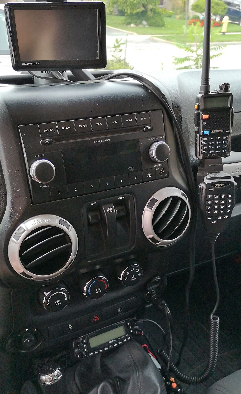

To mount the GPS I used the Rugged Ridge kit that fits in the dashboard tray. Works a lot better than a suction cup that tends to fall off all the time and it also has provision for accessories such as a web cam. Rugged Ridge also supplies a spring loaded mount for cell phones if you don't have a GPS.
At this point I'm happy with the front office though I may at some point torture myself again with the factory GPS radio but the Garmin works fine and in some ways is better especially since you have free map updates for life. The mic and hand held are mounted with the Jeepuniq grab bar mount kit. Holds tight even when bouncing around offload.
The little spot behind the shifter is handy for the head unit of the radio, doesn't hit the radio though depending on what gear I'm in it blocks the view of the display. I basically use this radio as a radio scanner even though it is a quad band transceiver as it can cover quite a broad frequency range in receive mod only and has 809 memory channels. The HH9000 quad band antenna isn't perfect but after a tiny modification it works fine.

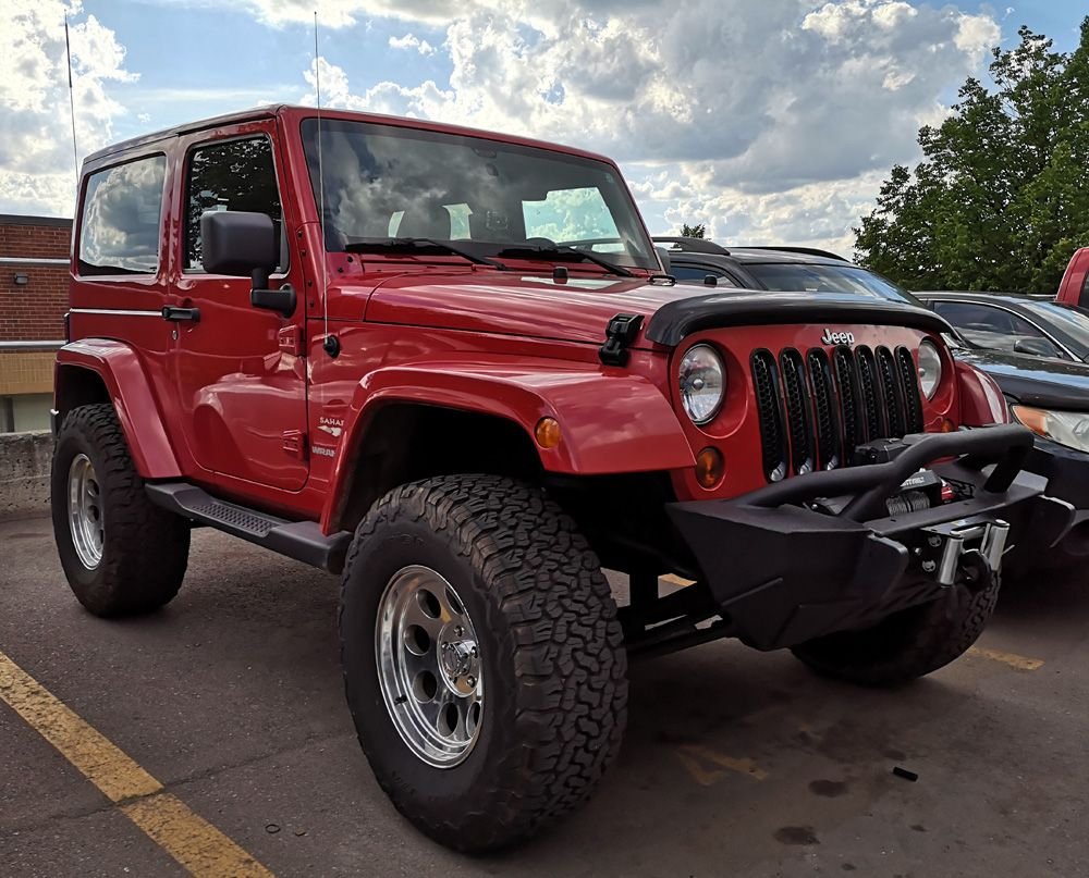

The final piece of the puzzle outside was a bumper upgrade and winch. I kept looking at the Jeep and thought it was missing something. I don't do a lot of offload driving but the trail into a buddy's cabin can get a bit exciting so figured it was a good investment.
Nothing fancy though. One thing of note, I think I should have installed the box to the side as the wiring blocks the front grill and will be a real challenge to remove. Keep that in mind with the XRC Gen II bumper and winch. Think I'm done for now.

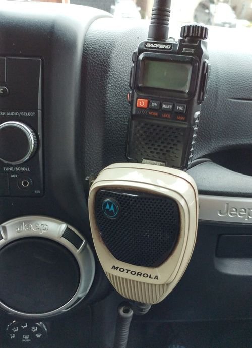

What type of mount are you using to hold the walkie on your grab bar?

I’m using the JeepUniq mount for standard mic and Baofeng UV-5r. It is very solid and holds everything in place off-road. https://jeepuniq.com

Thanks, I appreciate it. I'm not running a CB so would just need one to hold the walkie

I think all the JeepUniq mounts are walkie and mic but if you ever add an additional radio to your Jeep it would come in handy. I'm now trying to figure out where the least invasive spot will be for a second mic mount....

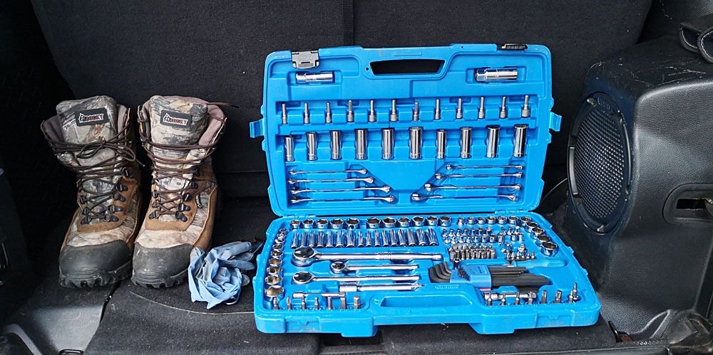

Most important is a decent tool kit, up here in Canada we have a chain of stores called Canadian Tire. They started out as primarily auto parts but have since expanded into a number of other product lines. They have some pretty good sales on their tool sets and their house brand carry a lifetime warranty. A couple things missing are a crescent wrench and a knife.

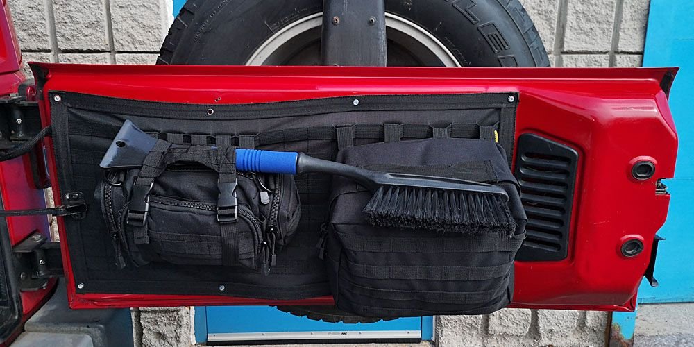

One downside of the JK is that there is not a lot of storage space, I already filled the bin under the floor with a tow strap, trailer hitch and booster cable. I added a Rugged Ridge tailgate MOLLE kit which gave me a bit more storage space for small items like gloves, first aid kit, tree strap, bungee cords rags and some other small odds and ends.

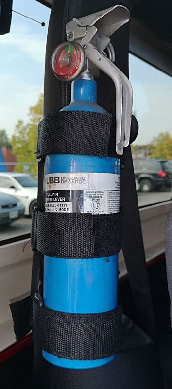

Also a small fire extinguisher.
