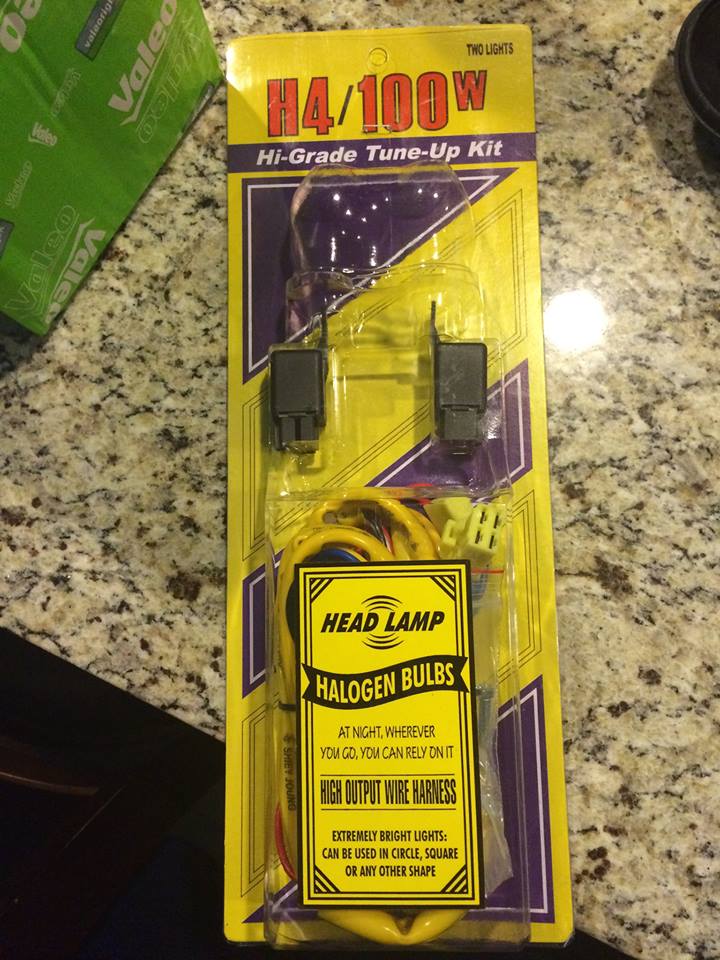

Last week I installed a headlight upgrade:
Cibie E code housing
Hella 80/100w bulbs
Putco harness with relays (Link to harness )
Initial impression was not as pleasing as I had hoped. I have been reading many review on this set up and was greatly dissapointed. Yes the light is directed better with the cibie housings but the brightness, sadly, is comparable to the stock sealed beam housings...
Now, I am noticing the lights dim/fluctuate as I accelerate and continue to fluctuate brightness as I maintain speed. this did not happen with the stock headlights.
I want to think it is the harness, but I checked all connections (which were tight).
So that leads me to the battery? Alternator?
Perhaps the method I have the leads connected to the battery?
i'm by no means an electrical guy, do the lights get power directly from battery or alternator while the car is running?
I am hoping if there is a fix for this fluctuation that it will also help with the overall brightness, as 80w low beam should be substantially brighter than the stock lowbeams.
Any thoughts/advise would be greatly appreciated.
Hella 80/100w bulbs
