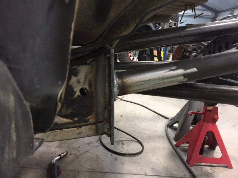

I am concerned about the lower links you have mounted on just a 2" dom without any other real support, with nearly a half ton hanging from those mounts with such little separation looks like a place of failure.

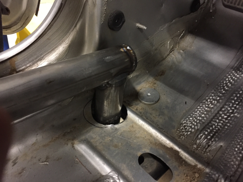

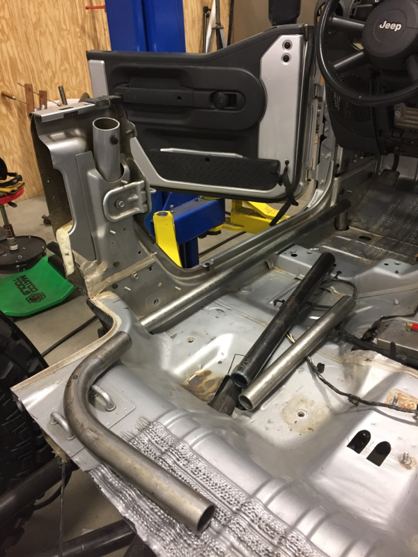

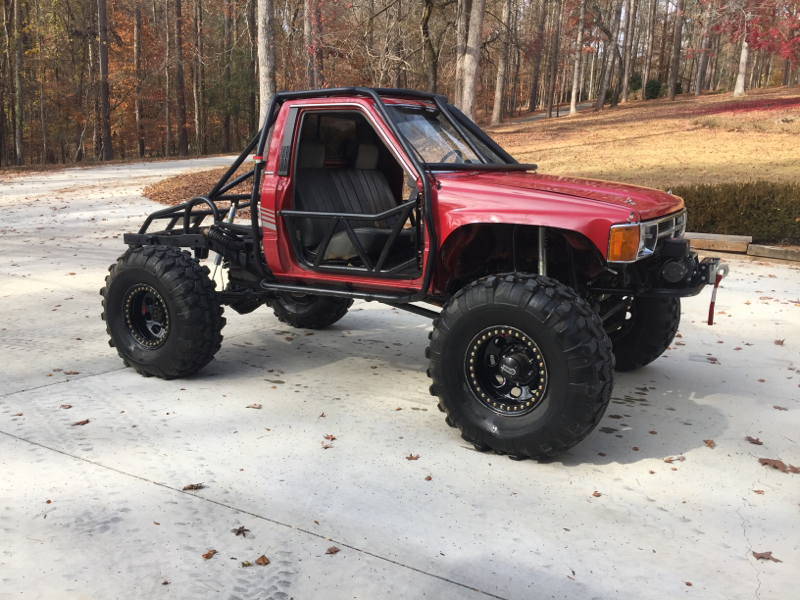

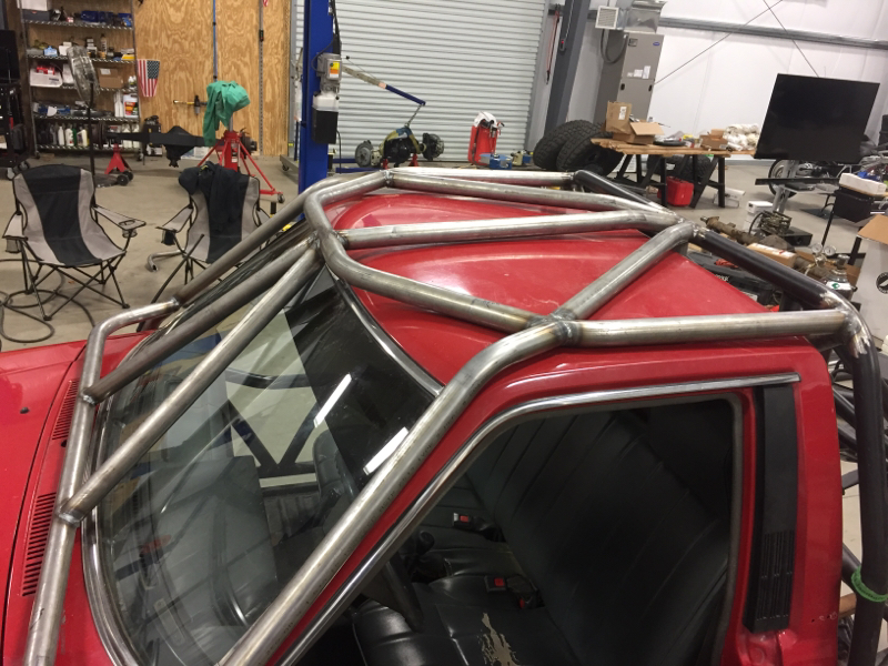

I am going to re-enforce and gusset the tube holding my lower link when i go to fully weld everything... And I honestly am not sure about my steering orbital. I got all the stuff PSC recommended for double ended full hydro on a jk. I built a toyota crawler over a years ago and its full hydro and honestly I wouldn't own another offroad rig that wasn't fully hydro. Makes suspension simple, effortless turning (1 finger in a rock garden), and it honestly is not that bad on the road. I'm wing-ing the rear cage honestly but I have a good idea in my head of what I plan on doing. Im sort of modeling it off of a friends cage but mostly using my creativity. I have build a roll cage before on my yota crawler so, I have a pretty good idea of whats do-able and what isn't. Heres a pic of what I'm kinda basing my cage on (simple and strong) And he is a couple pics of my yota build.

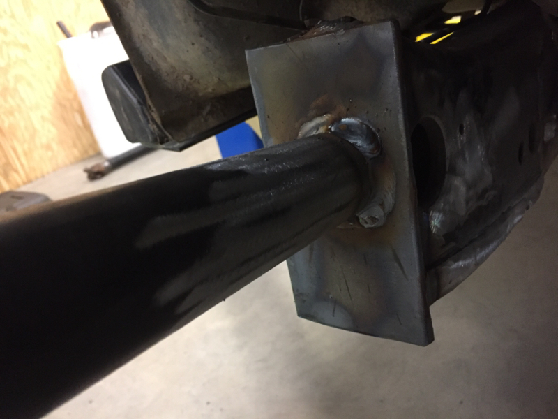

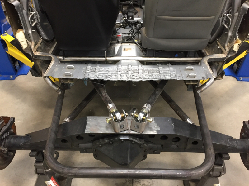

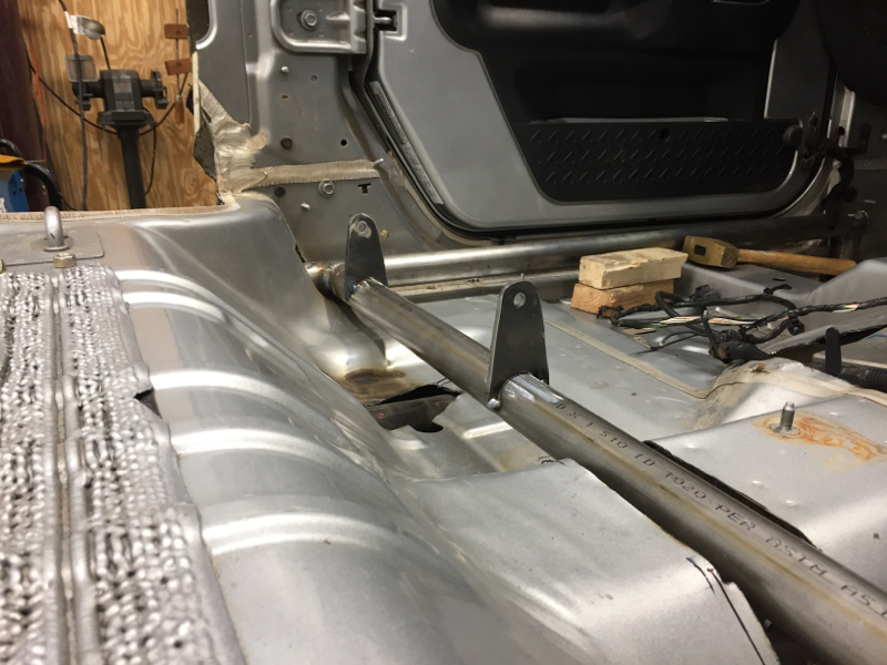

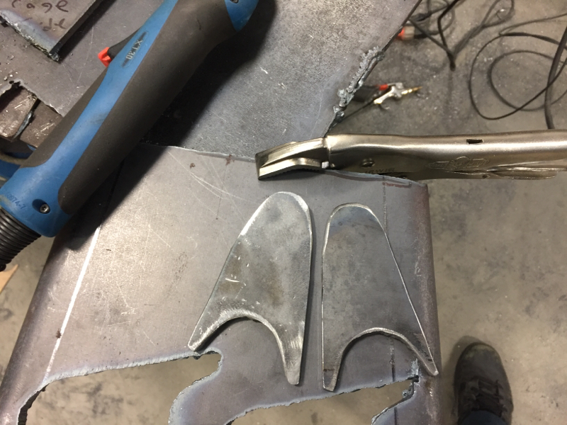

Main frame tube is welded into place. Im gonna clean up the edges of the 1/4" plates welded to the tube and frame. Now i need to build cage mount rear oris and ill have a rolling chassis.

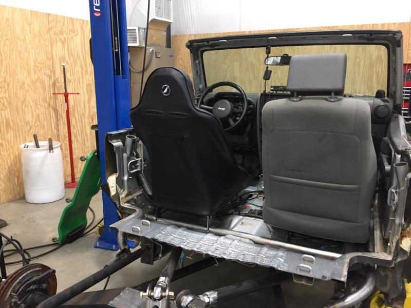

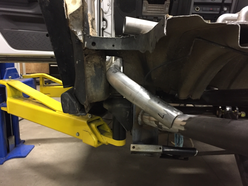

Making steady progress. Have the driver seat half way mounted.
