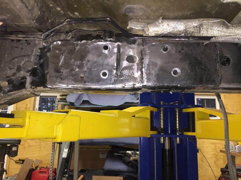

Project rear lower crossmember recap: after about 50 iterations on design, I finally came up with a solution that cleared the driveshaft, was at frame level, and gave me access to removing the transfer case.
Stats
- 2" x 4" x .250 wall tube
- 3/8" link tabs (I'll be fabbing some skids for them later, which will add support and box them in)
- Removable, with (4) 1/2" bolts per side
- Frame was partially plated with 3/16" steel to make it level as there is a transition in the frame
- Drilled 3/4' holes and sleeved the frame with DOM so the bolts can be cranked down (drilling through the 3/16" plate and frame pretty much ruined my day...)
- Cut the ends off the t-case so I could move the crossmember as far forward as possible so it would clear a driveshaft

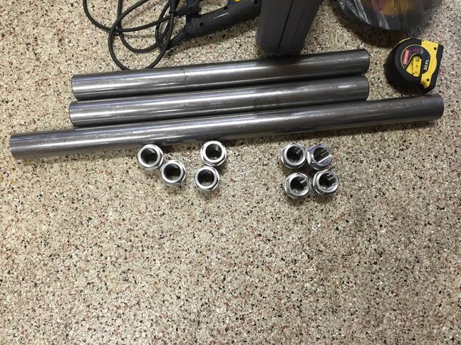

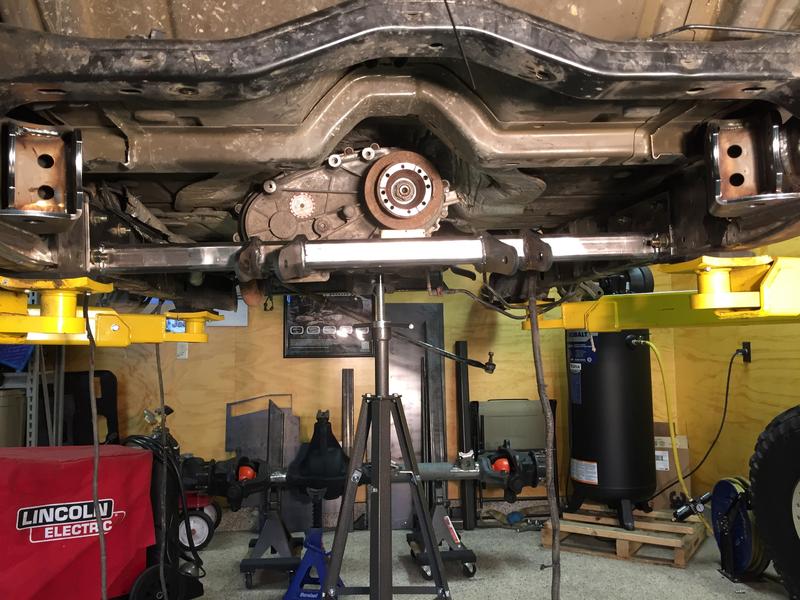

Have the rear links figured out and will be welding them up this week (there are 4, one is just MIA in the picture - not very photogenic I guess). I ended up with about 75% anti-squat, which is what I was looking for. Also ended up just shy of 8" of stretch. Would have liked a little more, but have a fuel tank to fit back there.
A friend of mine works at a large race/fab shop, which is very helpful. He lathed a bevel on the control arms for me. Nice work. Also bent some 1/4" plate for me (that is for project new trans crossmember - takes some imagination to figure that one out).

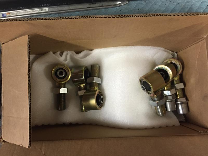

Following my experience with MetalCloak (Will and Matson kick a##), their Duroflex joints, and their customer service, it was a no brainer going with them again. It's like a box of gold.
