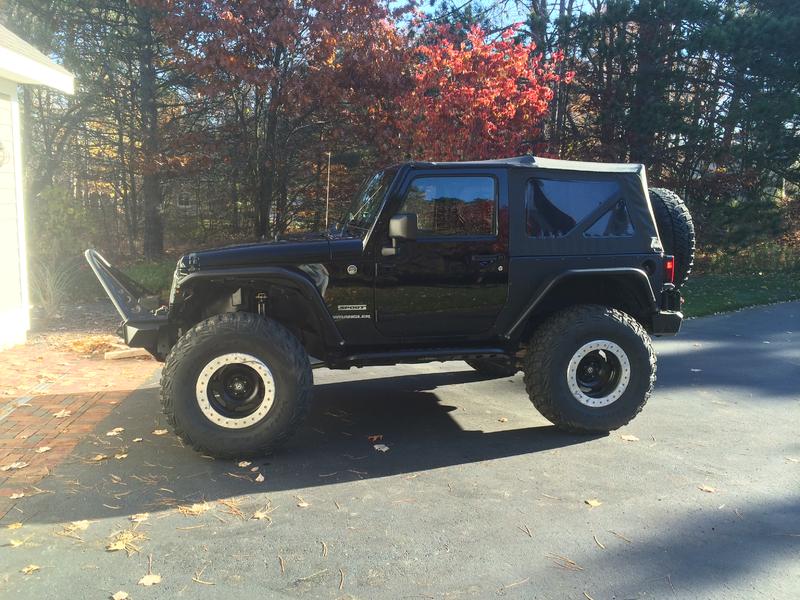

MI winter is fast approaching, so it's time to start the build. The Jeep (affectionately known as Hofftimus Prime) started life as a 2013 JK Sport. This will be the third full build in its short life. If you're curious to know the mod list prior to this build, see my profile, it is pretty up to date.
The fun began today. This morning, nice and clean. Dang those 40s make my 37s look small. And this afternoon, all pulled apart (still need to remove the gas tank, bumpers, and exhaust, but I am rolling solo in the garage and got a bit tired).
