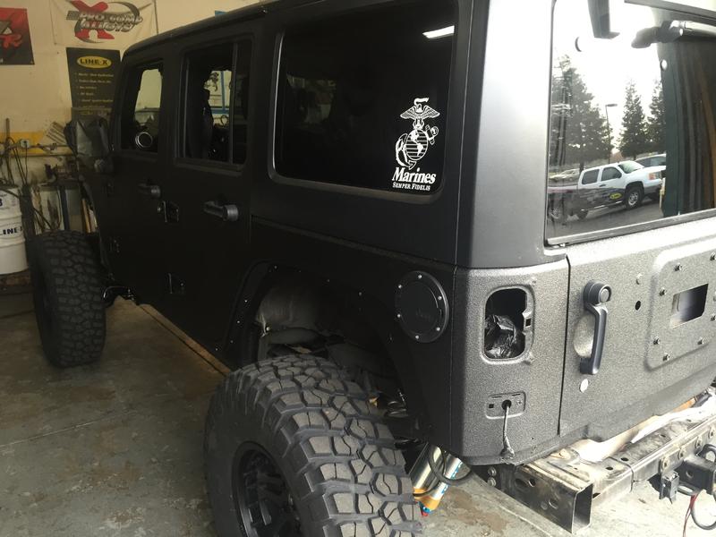

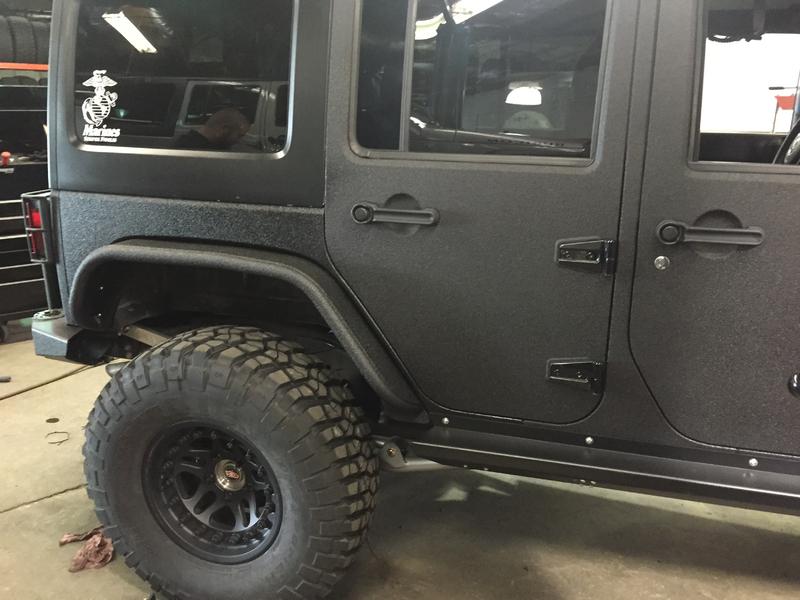

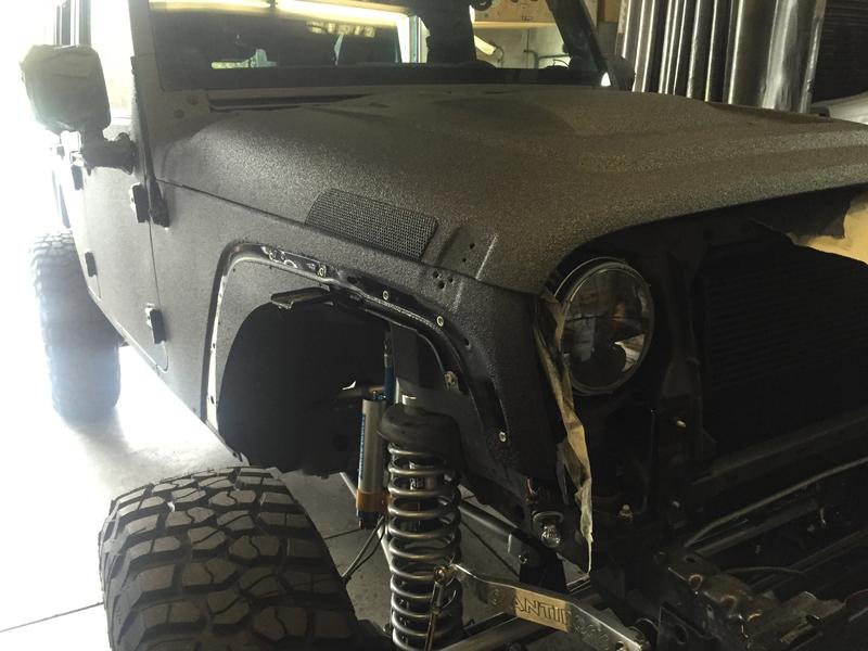

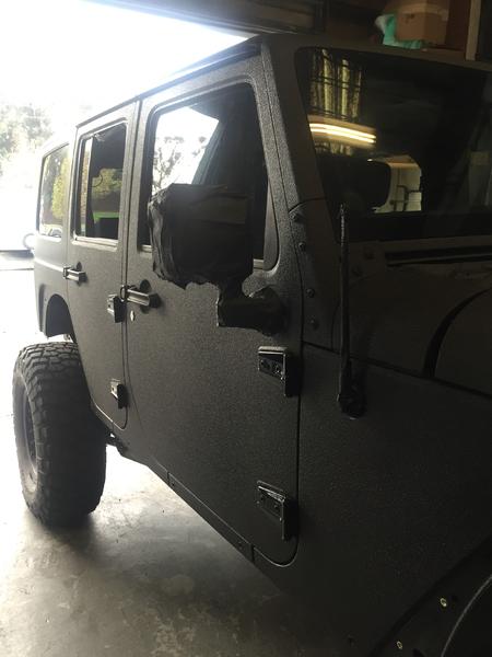

Some "in process photos"
Name:	2014-12-05 08.38.30.jpg
ID:	586954Click image for larger version
Name:	2014-12-05 08.38.19.jpg
ID:	586955Click image for larger version
Name:	2014-12-05 08.38.12.jpg
ID:	586956Click image for larger version
Name:	2014-12-05 08.38.03.jpg
Name:	2014-11-24 09.29.07.jpg

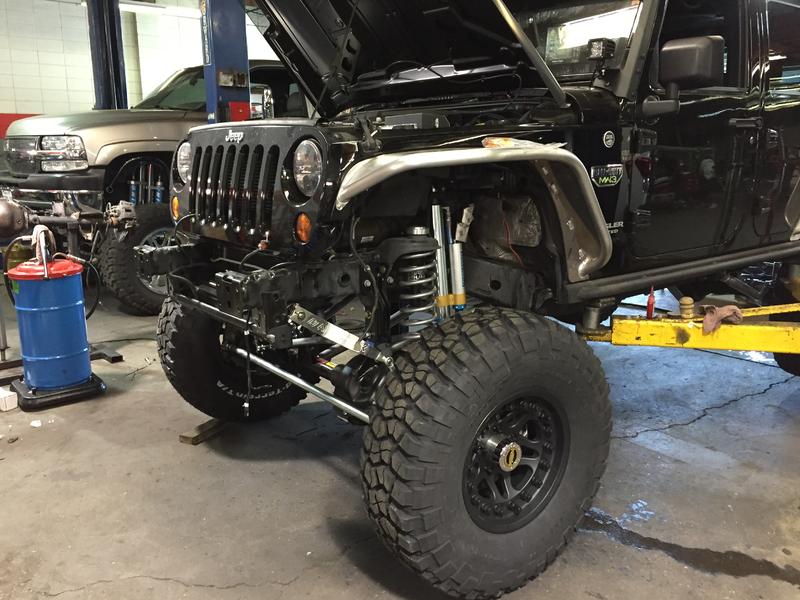

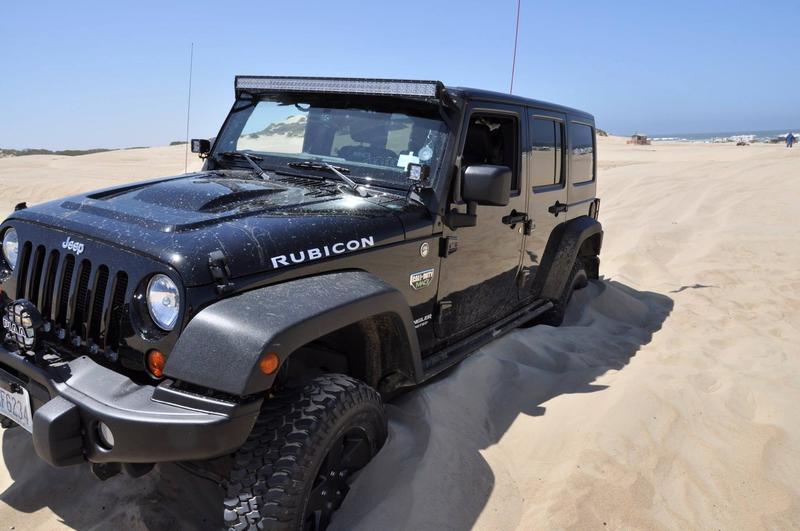

Before all this madness began
Name:	2014-08-05 19.03.50.jpg

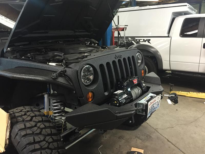

Cool More Pics
She's coming together - should be finished in another week or so, assuming I can keep devoting all this time, and the shop lets me continue to use their space...
Name:	2014-12-12 12.49.53.jpg
ID:	587725Click image for larger version
Name:	2014-12-12 12.49.47.jpg
ID:	587727Click image for larger version
Name:	2014-12-12 12.49.33.jpg
ID:	587728Click image for larger version
Name:	2014-12-12 12.49.27.jpg

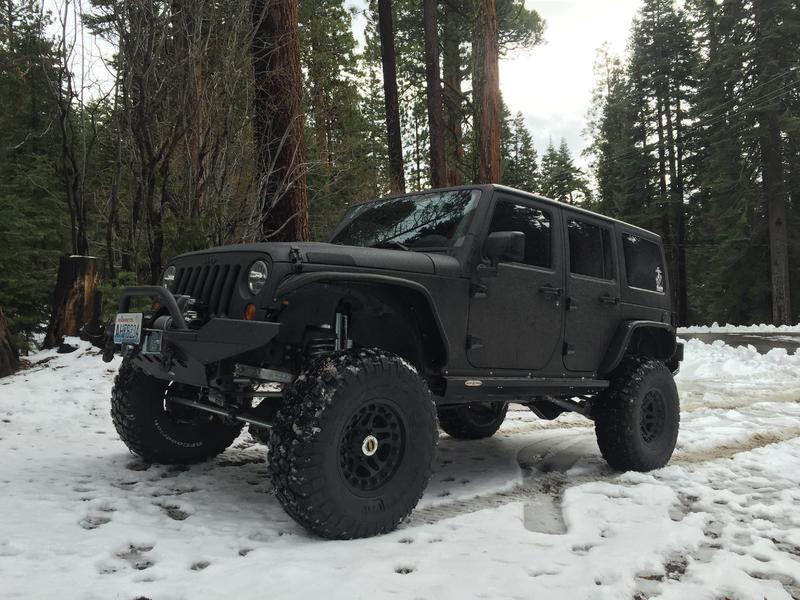

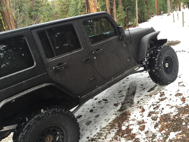

Ghostrider's major work has been completed. Took her up to Tahoe this weekend to see what she can do.
Name:	2014-12-21 10.54.31.jpg
ID:	588876Click image for larger version
Name:	2014-12-21 10.54.12.jpg
ID:	588877Click image for larger version
Name:	2014-12-21 10.54.05.jpg
