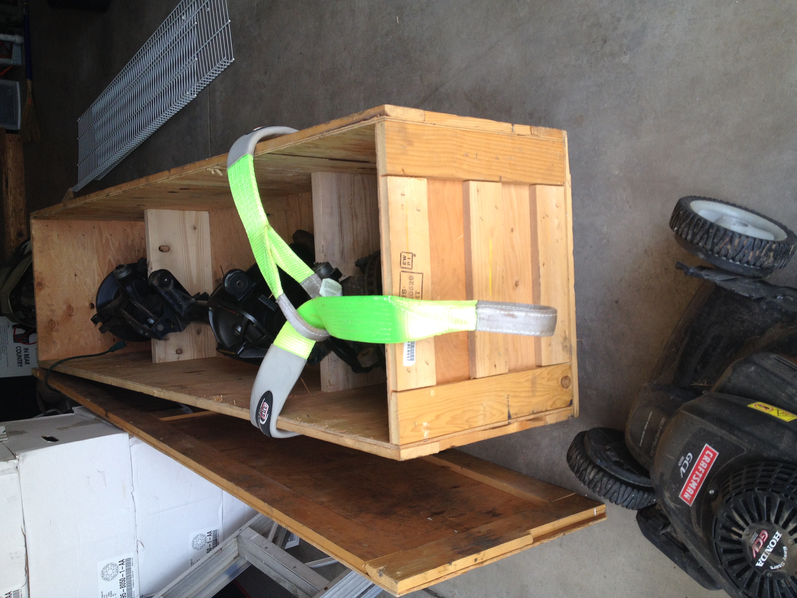

Dropped off the Jeep yesterday . I feel like a kid waiting for Christmas.
I had to use a Snatch Block and Winch to get the ProRock loaded on the trailer.
It worked well, it took longer to rig everything than it did to load the axle.

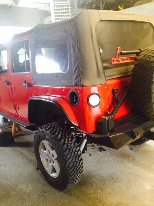

Old Aug 23, 2015 | 07:14 AM
thegoat's Avatar
Posts: 517
From: Colorado Springs, CO
Rear ProRock 60 went in on Friday with the new MetalCloak Control Arms.

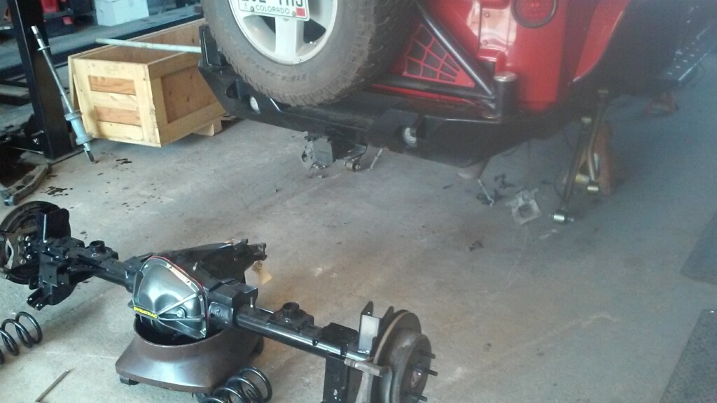

Old Sep 5, 2015 | 05:31 PM
thegoat's Avatar
Posts: 517
Axle in on stock wheels with the Evo plush ride coils and rancho 9000xl shocks.

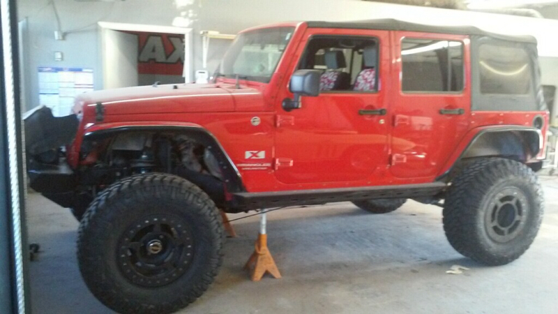

Old Oct 12, 2015 | 04:52 PM
thegoat's Avatar
Posts: 517
Axles on!

Old Oct 14, 2015 | 06:04 AM
Jritola's Avatar
Joined: Aug 2015
Posts: 4
From: Traverse City MI
why eov coils insted of metalcloak coils just wondering? im in the process of changing out a wooped teraflex kit.
Old Oct 14, 2015 | 07:03 AM
thegoat's Avatar
Posts: 517
I bought the coils used as I am planning on going to coilovers in the next year or two. I'll give my feedback on the spring shock setup once it is driving.
