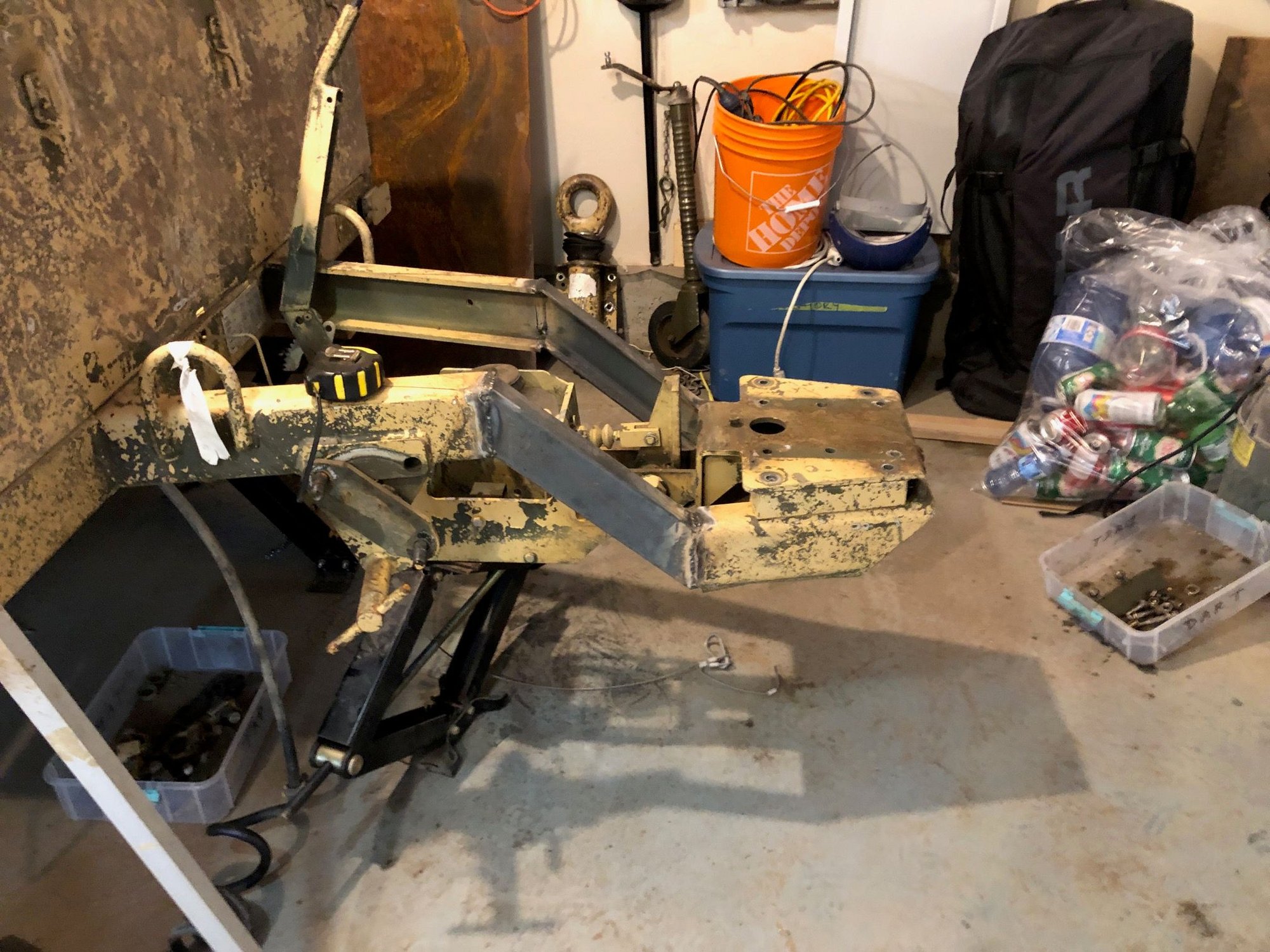

The pintle is NATO type so even new spare parts now are unavailable. In fact a guy in England wants to buy everything I take off. Right now the pintle is in good condition and is well lubed for push and pull on the brake master cylinder but I still have to lower it all to 550mm to make the trailer level so may as well go with the new surge controller and ball setup.

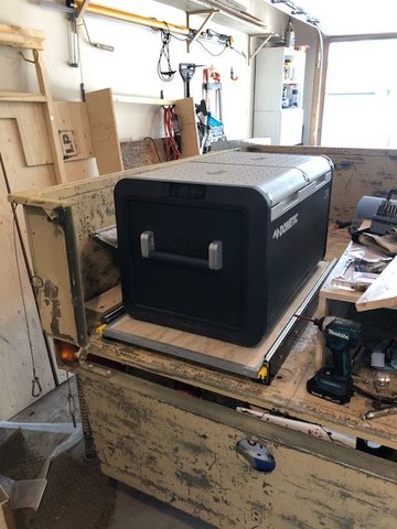

OK moving on:reversing
1. Hitch is lowered 225mm so will be basically level behind the Jeep and the hitch is extended by 10" to make driving/reversing better.

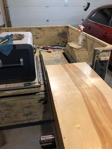

2. Fridge slide is done and cost me about $190. Works great, slides are capable of supporting 500lbs and they really do feel like they will. Locks in both extend and retract positions. Supports are simply 3"x2" x 3/16" angle iron painted with POR15. All the hardware will be removed to paint the interior.
3. Kitchen slide is next at 4ft long. Cabinet is built except for the pullout drawers and Arborite top to be glued on. Should be ready to install tonight and then remove and varnish to seal the plywood which is Birch wood ply. Then permanetly mount the fridge to the slider tray.

1. Have completed the kitchen and fridge slides and varnished the wood portions.

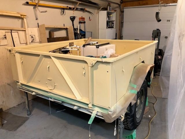

Moving on...... painting of the interior is done and drying as I type this. Decided on a colour that will almost match any coloured towing vehicle. Also have decided for sake of extra storage we are building a support frame and going with a 3 person Tepui folding tent with annex. They are on sale right now so will get one. Need a soft top tent as I need to mount sideways on the trailer. Inside the support frame will be a boxed in area with storage shelves full length and means to access the components in the bottom.
No shine on this. Epoxy primer with Urethane on top. Outside will get clear stone guard perhaps. Ready for component install.

Outside painted day before yesterday with 1 x epoxy primer then yesterday with 2 x urethane. Once it is hard I will coat with clear stone guard on the front and sides. Water system is in now with plumbing about 60% complete. Paint is shinier than what appear in photo. Line below the making paper will be sprayed black POR-15 including tow bar, brake handle and hitch
