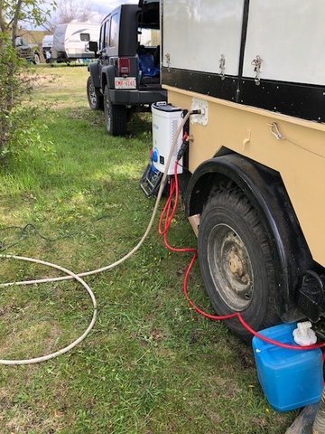

Been pretty tied up last year but here are a few shots of the finished build. Trailer works great and never an issue right off the bat. Only problem I had was with a fixed solar panel I was at the mercy of sun and trailer position and fridge kept running out of juice. So I simply bought a Renogy portable solar panel and use that to follow the sun with some input from the fixed unit. The fixed unit keeps the fridge running freezing cold going down the highway even on a cloudy day. The trailer has standalone and shore power and the same with water - campground service or tank and water pump. Annex is for changing in and wifes vanity use at night. Very pleased and what a strong military trailer from the Iraq war 2004 model all Stainless Steel and paid $910 CDN for it. The trailer has all the functionality as the $50k+ factory built units (plus more storage than theirs) and cost me about $7kUSD to build the entire unit as seen here. Rides better than the Jeep and does not bounce all over the place offroad as well.
The water heater is Joolca continuos heat. Takes about 3 minutes to setup with all quick connectors
