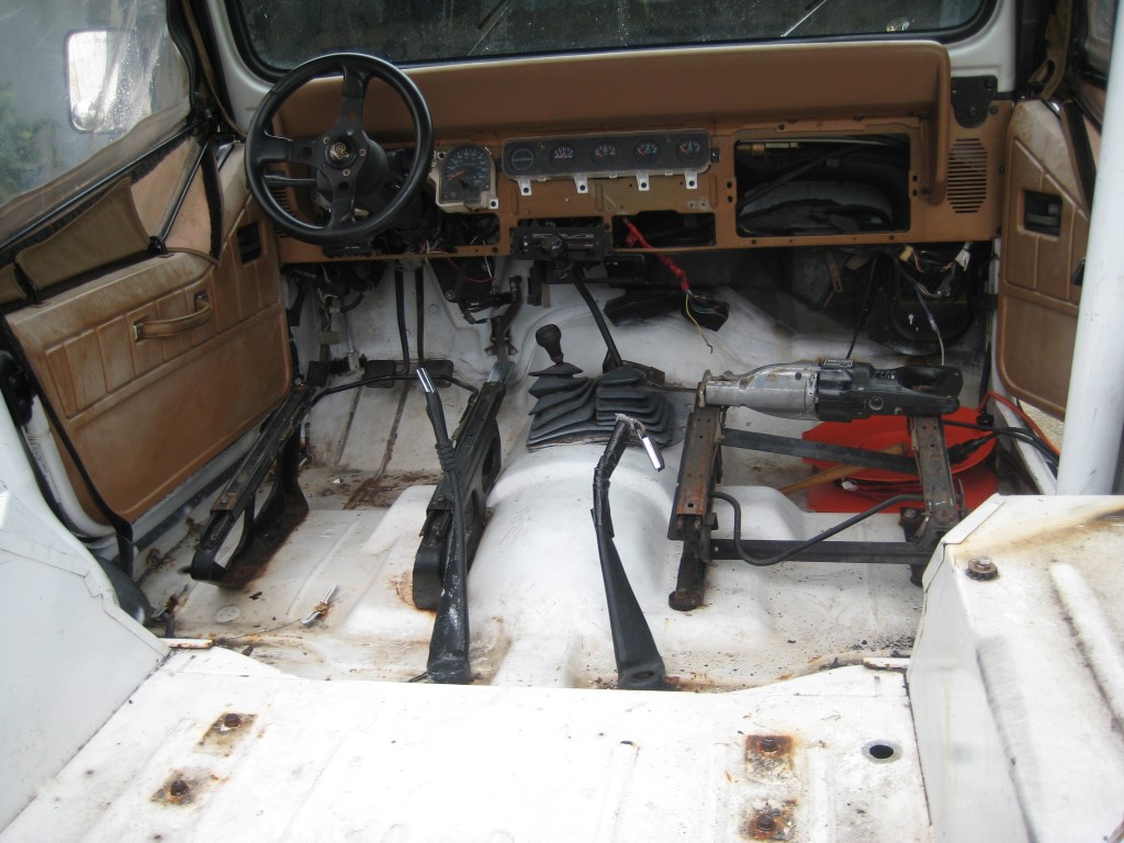

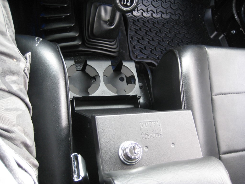

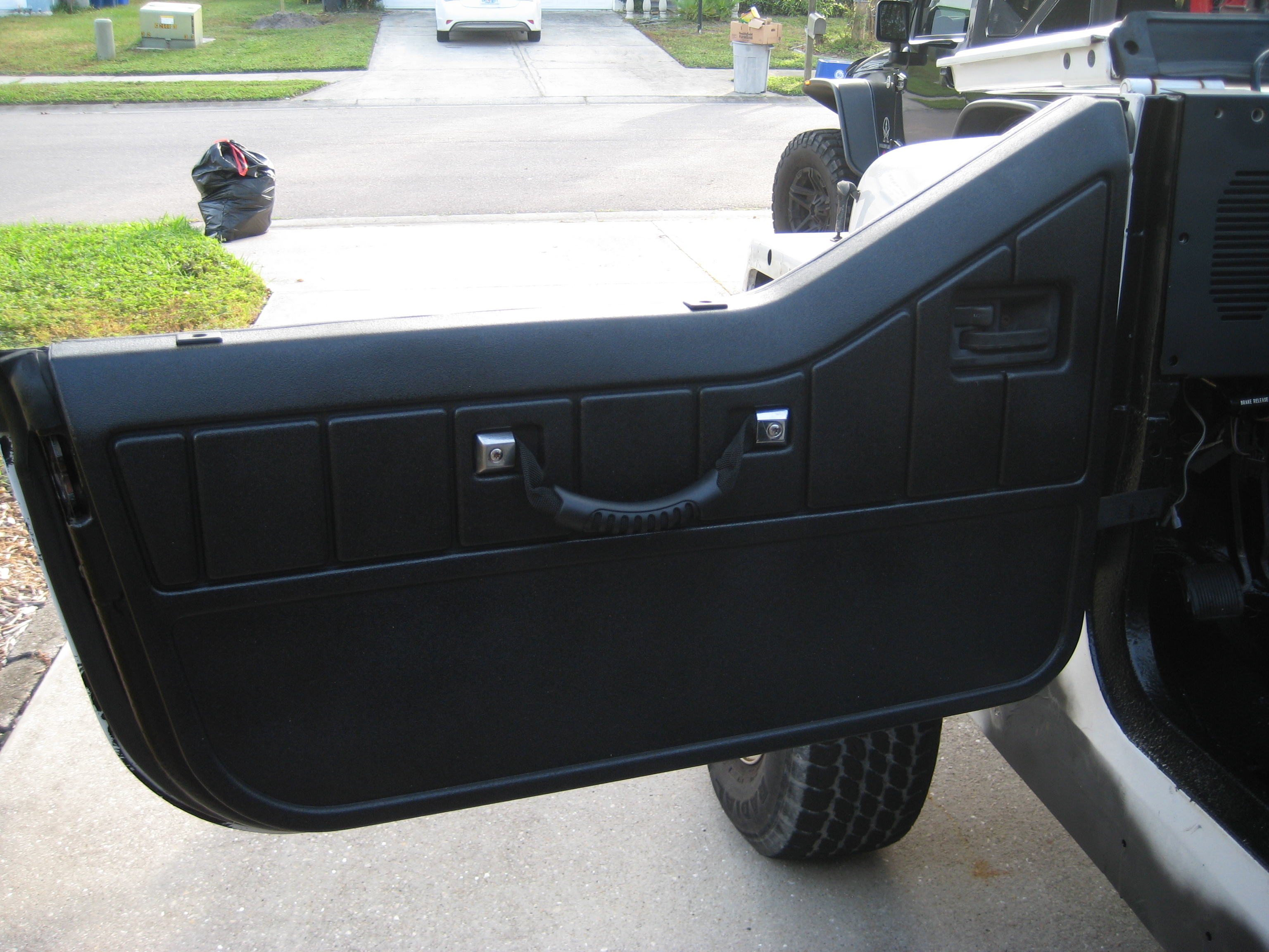

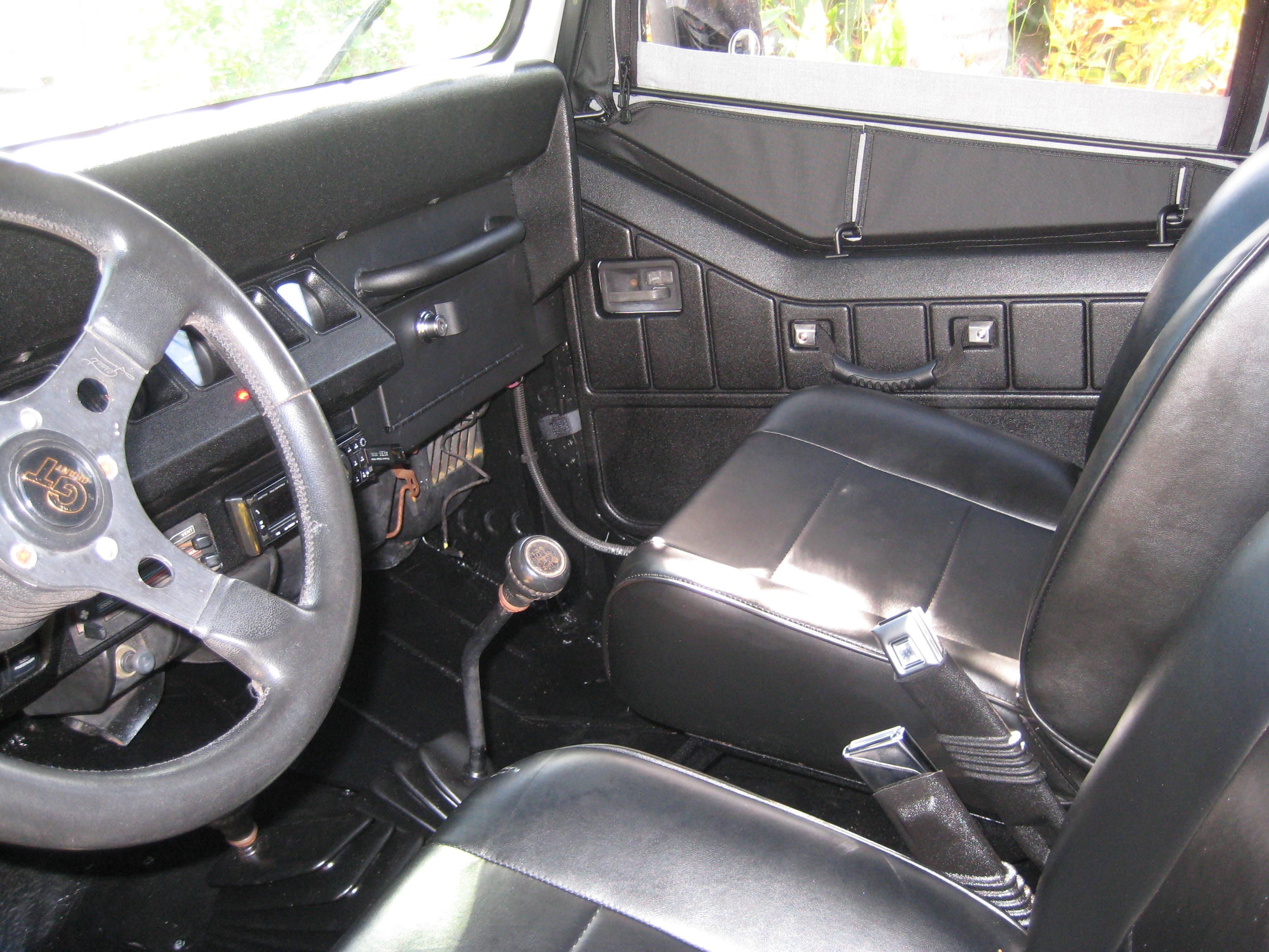

I've tried to change the interior color on many vehicles over the years with limited success. Tried the simple Fusion paint to the multistep SEM process, and even OEM dye (on leather and vinyl). They all looked good when first done but didn't last. I'm saying that so you won't be so hopeful. Sorry.
The last thing I tried was changing my Jeep interior from spice to black. So far it has held up very well but it has only been about 3 months. Which is longer than everything else has held up except the OEM dye which is on a classic vehicle which I rarely drive and it was the same color, not a color change. Of all things, I used Rustoleum Bed Coating but again, the jury is still out.
Sorry not a JK but same deal to me.

The JK dash comes apart easier than the YJ. I would suggest pulling the pieces and coating them individually. Then re-assemble. The hard part is waiting for it to cure before re-assembly. Seventy-two hours with what I used but you need to read the can for what you use. Painting, whether it's your house or your Jeep, is all about prep. Remove any rust, not really an issue for you I believe. Remove any wax, oils, or polishes. I use M.E.K. which you can get at Home Depot since you live in FL. Wear gloves so you don't contaminate it again. Prime if your product requires it, which almost all do (the bed coating does not). Then patience. You've heard the old adage about watching paint dry? Yup, that is it. LET IT DRY!!!
