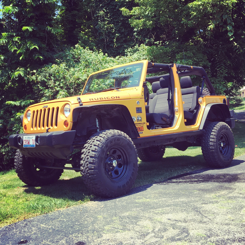

Fully finished:

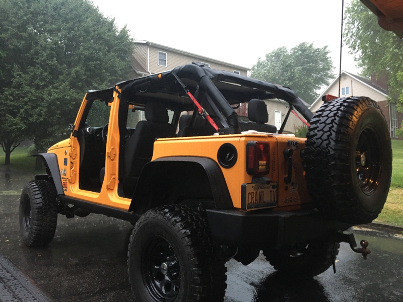

Rear shot:

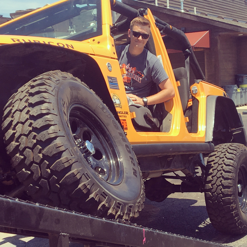

On the RTI

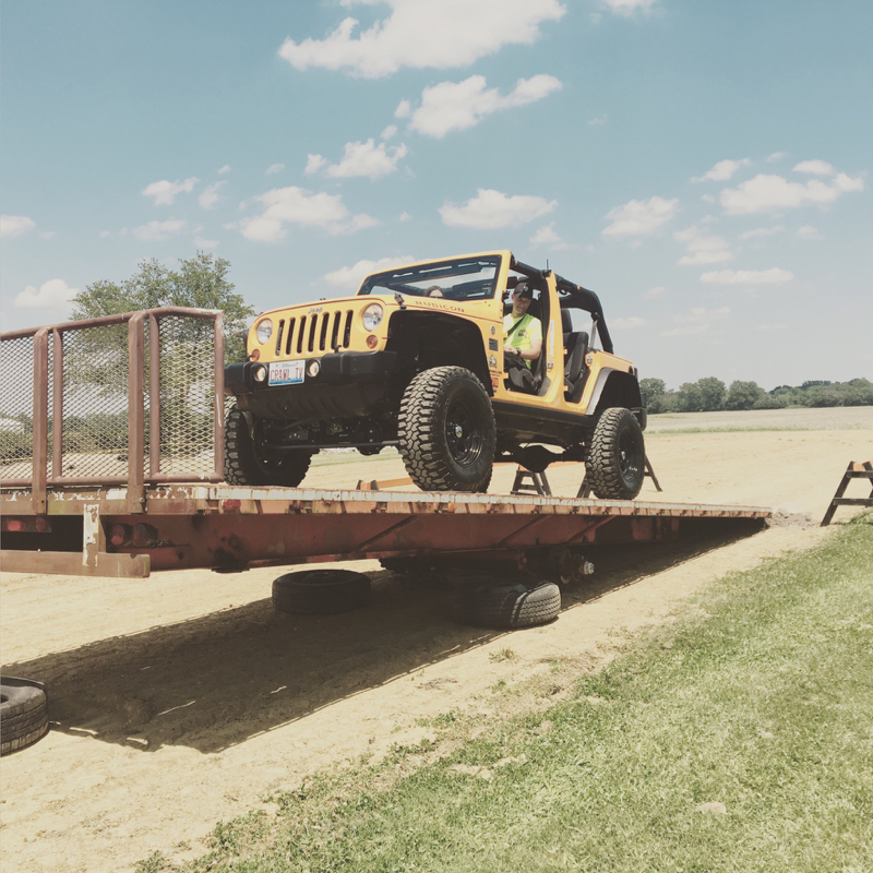

Teeter totter ramp
