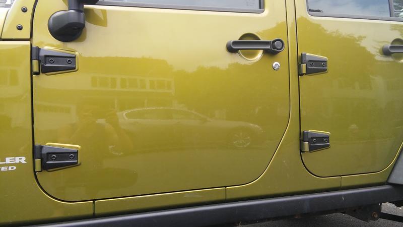

On Friday I decided to pull the doors and do some repair for the serious hinge bubbling I was experiencing. After the hinges started to chip, I picked up some rattle can bedliner. I sanded down the bubbling and chipped paint, sprayed a self-etching primer, and a couple coats of the liner. I opted to not paint the lower part of the hinge attached to the tub and think it turned out pretty well.
Now that a thunderstom is rolling in, I was forced to finally put the doors back on. But, I got some pictures for karmynsbeep.
Attachment 612462
Attachment 612463
Next up, want to line the hinges on the hood and do the grill. Man this stuff is addicting.

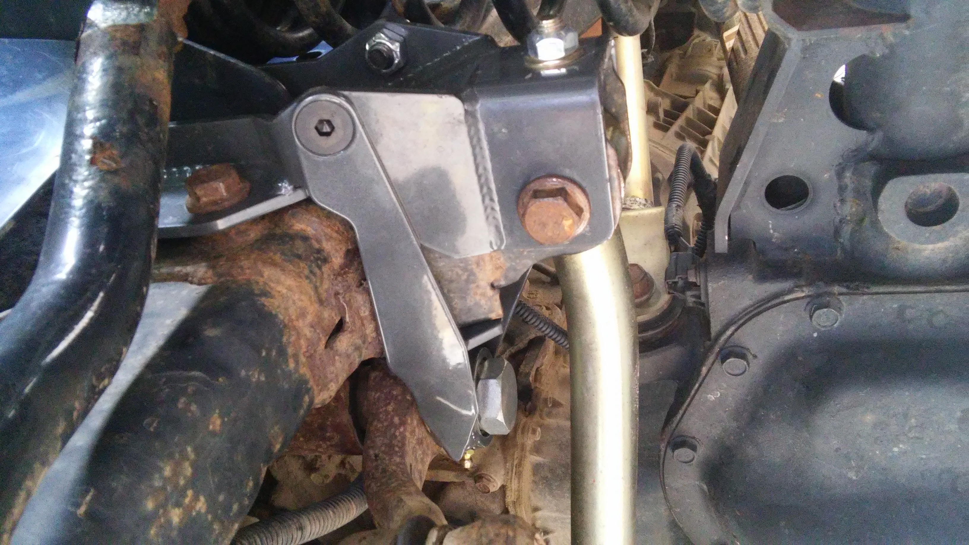

To continue my prep for 35's I ordered the Synergy Sector Shaft and Track Bar brace on August 4th along with the Daystar Hood latches because the 500 mile drive to school drove me nuts. Well, two weeks later I went to install the brace and got the TB brace on only to realize I didn't have a 33mm socket to pull the nut off the putman arm. I hunted around town, but eventually decided to wait until I was back at school and could borrow an impact gun and socket from a local club member. So finally, after a month of driving around with half of my brace on, I got the sector shaft brace on.
