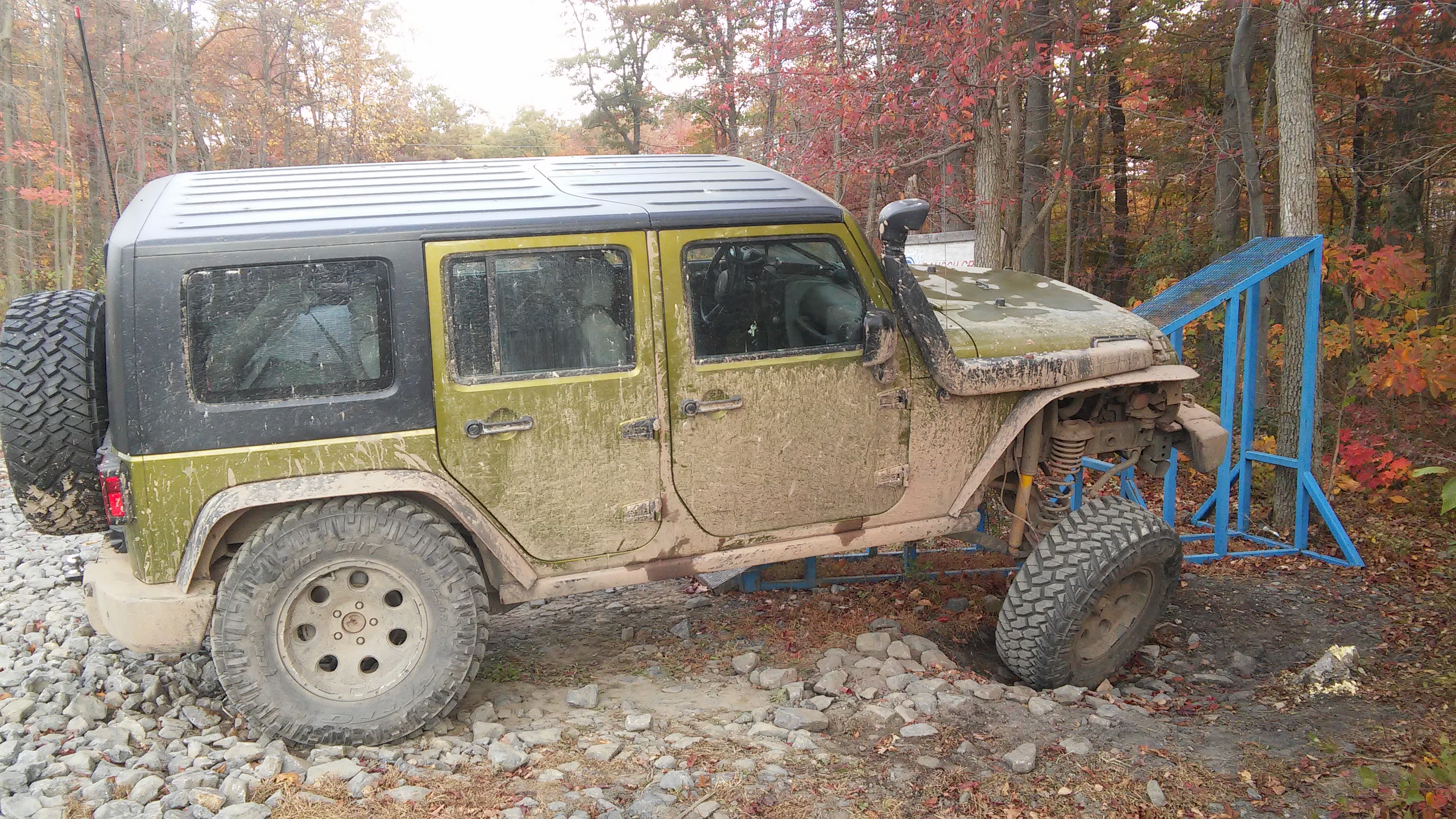

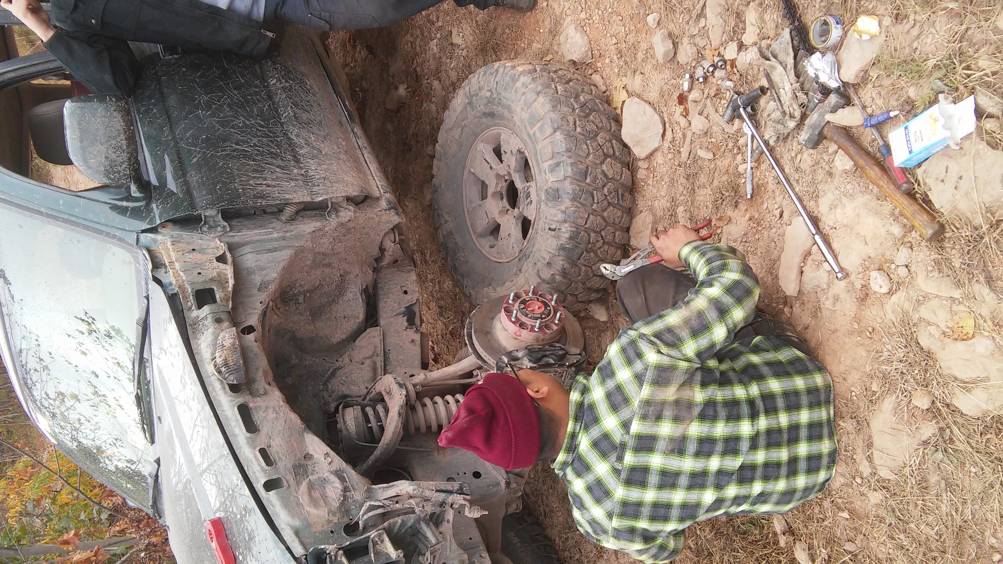

After arriving at camp we were trying to figure out how to get the TJ with a blown transmission back home. It was decided that a tow bar and my JK would be the solution. I gotta say, that was one interesting drive. I took it slow, and used engine braking on all the hills but still got a bit sketchy in those SWVA mountains.

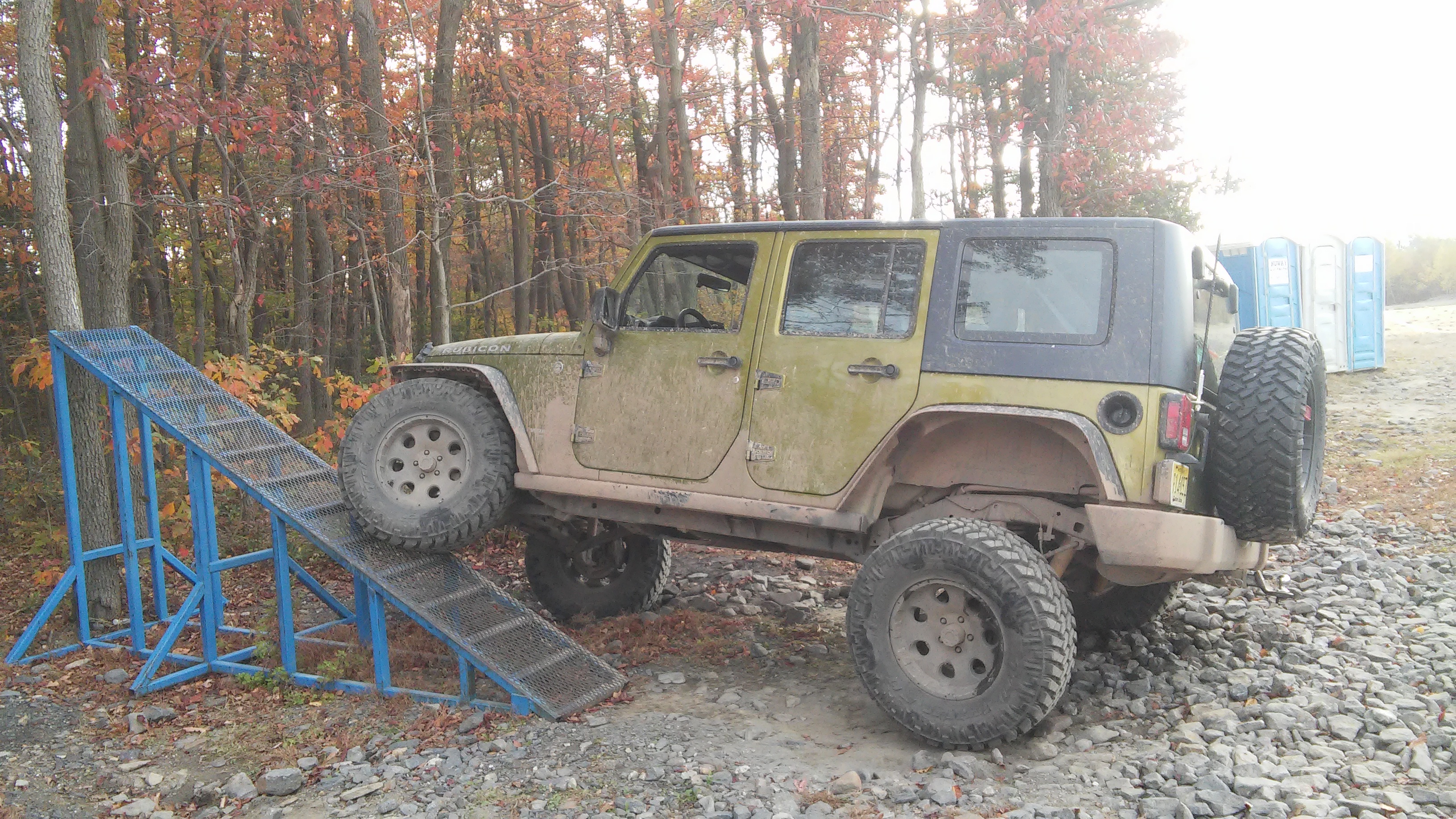

Just after airing up, I had to play on the RTI ramp. It looks like I was one of many because there is a hole in the ground right where my passenger tire ended up, causing me to max out a little earlier then I wanted.

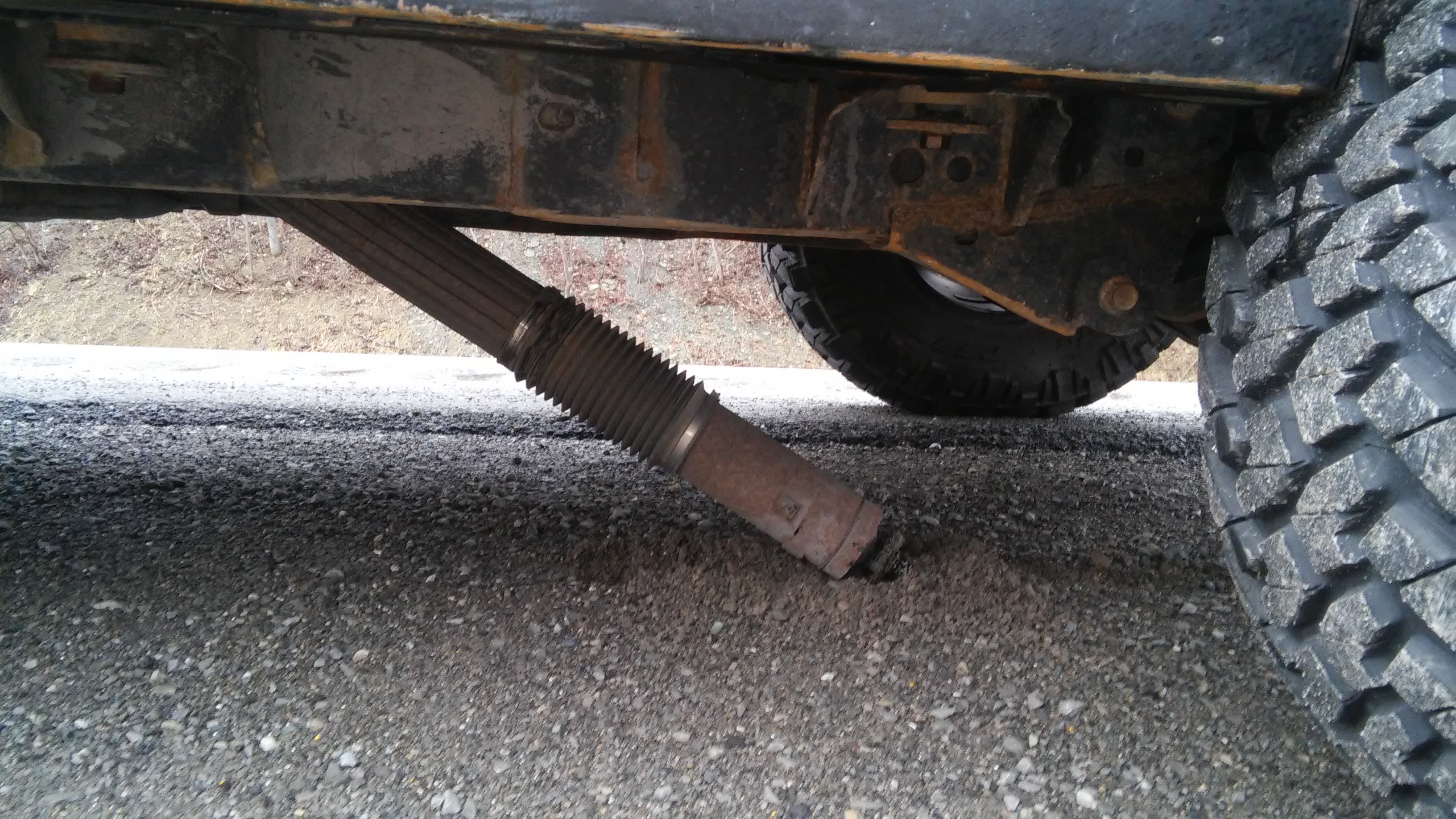

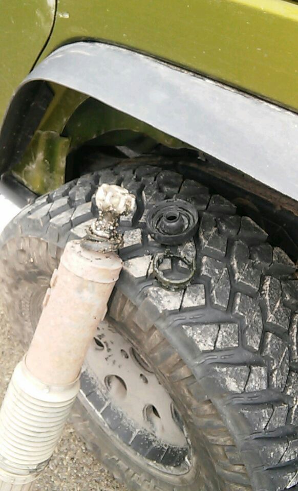

After that I drove to Seven Springs PA for some spring snowboarding with a couple buddies and had a blast for 4 days. I took it easy driving there because of my steering a kept an eye on my diffs. About an hour and a half south of Morgantown, WV I missed the exit and needed to take a u-turn. I slowed down and pulled over into the median (no traffic on either side of the highway), and downshifted into 2nd. I saw that I could continue through the turn and kept speed. As I was entering the highway I hit a bump in the road. All of a sudden, I lost power and my RPMs shot up. I threw on the hazards and used momentum to move off the highway. I waited for traffic to pass, and tried accelerating again but no dice. I knew my DS had gone, just a feeling I had. So I hop out, and here is what I find:
Note: Cant figure out why my photos are rotated here, but not on my computer. Pics taken with my phone and landscape are oriented properly, but vertical photos are rotated.
Rear DS broke off at the flange.

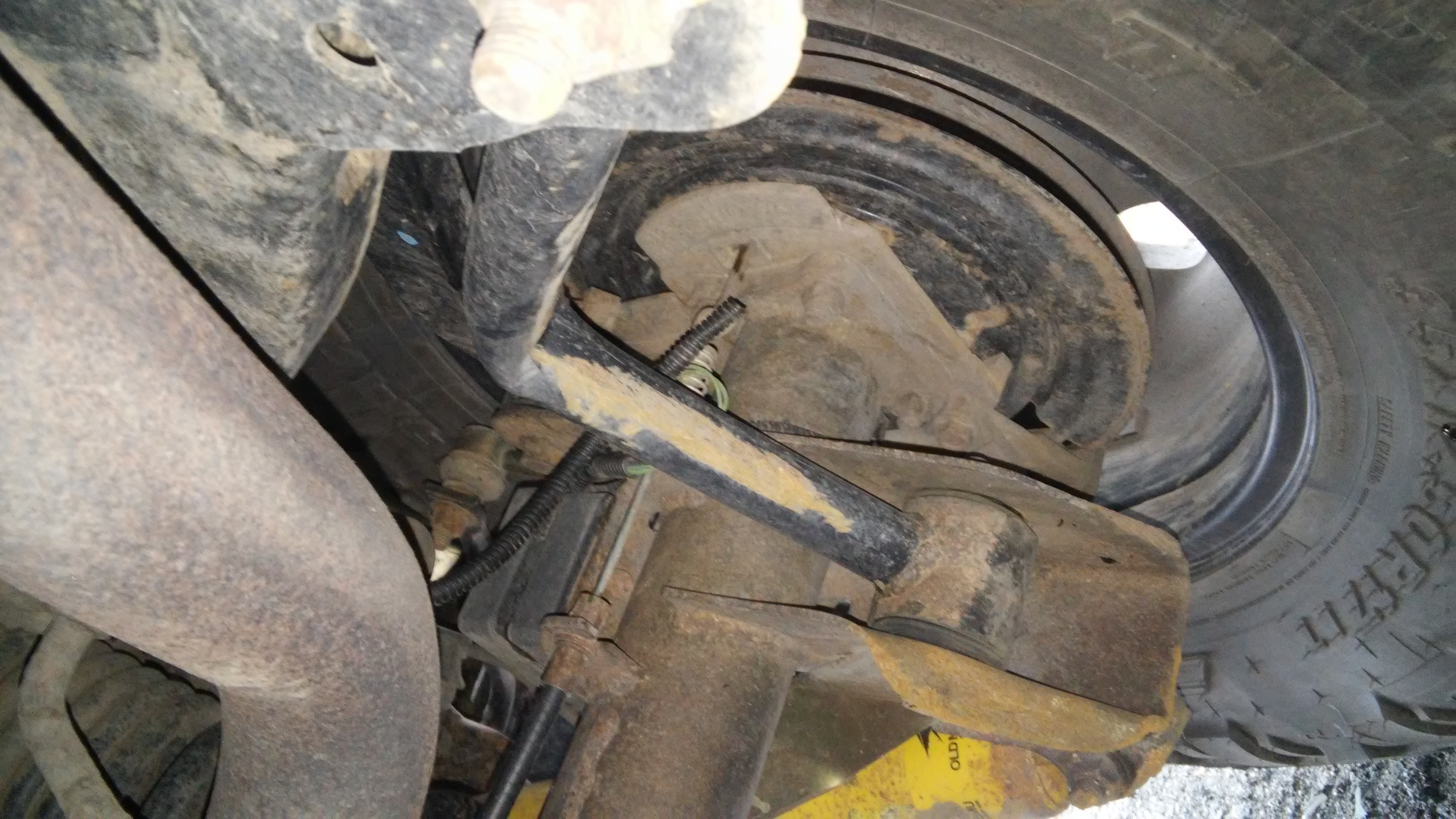

Snapped passenger side rear lower ca
Bent driver side rear lower ca 90*
Caused the axle to shift forward about 3 inches and the pinion to shoot up.
Assuming this is what caused the DS failure.

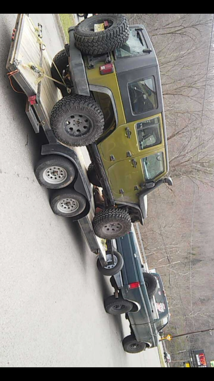

Okay, I'm stuck on the side of the highway and my insurance quoted me at ~$450 for the 160 mile trek back to blacksburg. I reached out to a buddy with a truck and trailer who agreed to come get me. Insurance pulled me off into a gas station so I decided to use that time to start pulling parts and assessing damage.
Snapped control arm
Rear driveshaft
Loading up
View on the tow home

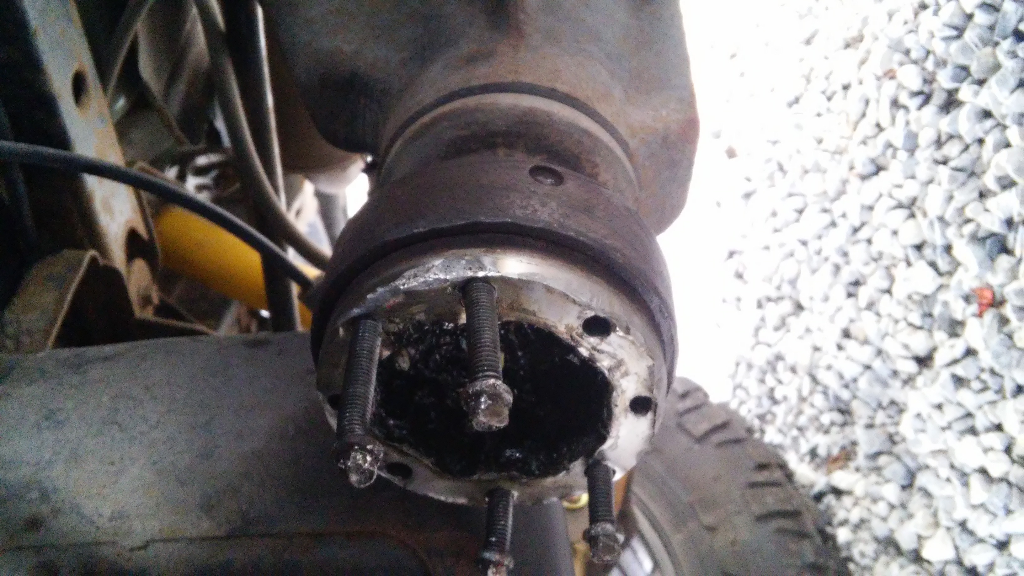

After replacing the control arms, I just slowly started unbolting broken parts and putting new ones in.
I ended up getting a 2015 drive shaft from a friend of a friend at a dealer who had just pulled it from a customer who bought a package from them. Now on a new jeep, without rust, salt, corrosion you should theoretically be able to pull the shaft out of the flange at either the tcase or pinion. The tcase came off with a lot of persuasion and leverage from pulling on the DS (remember this was taken out in the gas station parking lot). Now I had to remove the flange that was left on the pinion from where the joint disintegrated.
That thing was a b***h. It was so stuck and I had no leverage. I tried soaking in PB, heating the flange, a punch from the back, etc etc etc throwing beer at it. Finally since the jeep was fwd at this point with the CAs set I drove it to a shop and they used a slide hammer to get it out....still took some effort tho.
With that out, the rear drive shaft went in easy. Just 8 bolts on each side haha what a bitch on a CV joint. I inspected the front drive shaft out of curiosity. Then, discovered it had rubbed on a rock a lot and dented/damaged near the u-joint and ripped the slip joint boot. So the slip joint is seized and it is currently in the back of my jeep.

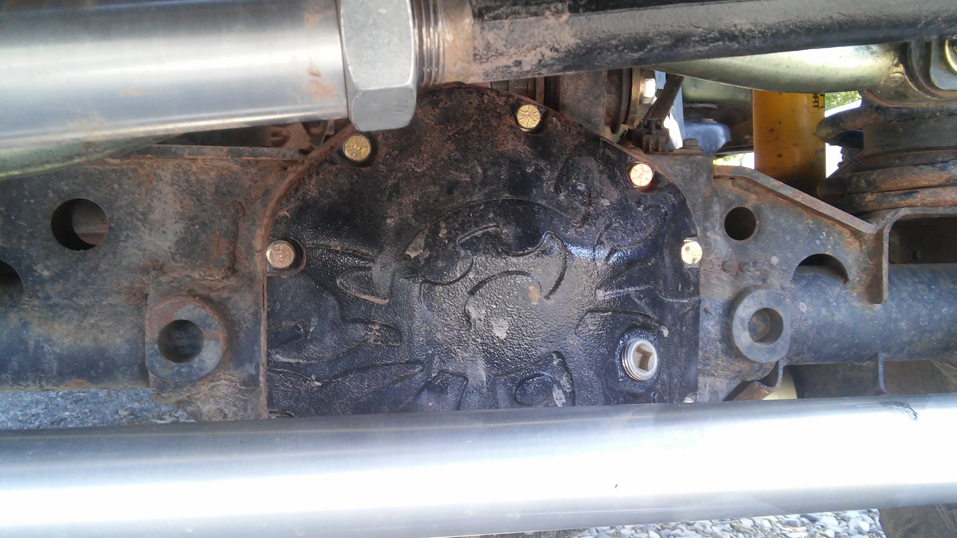

Then after that, it was time to address the damage/leaks in both diff covers. For that I chose the PS diff covers. They went in great and clearance is no problem with the new design.
Rear
Front

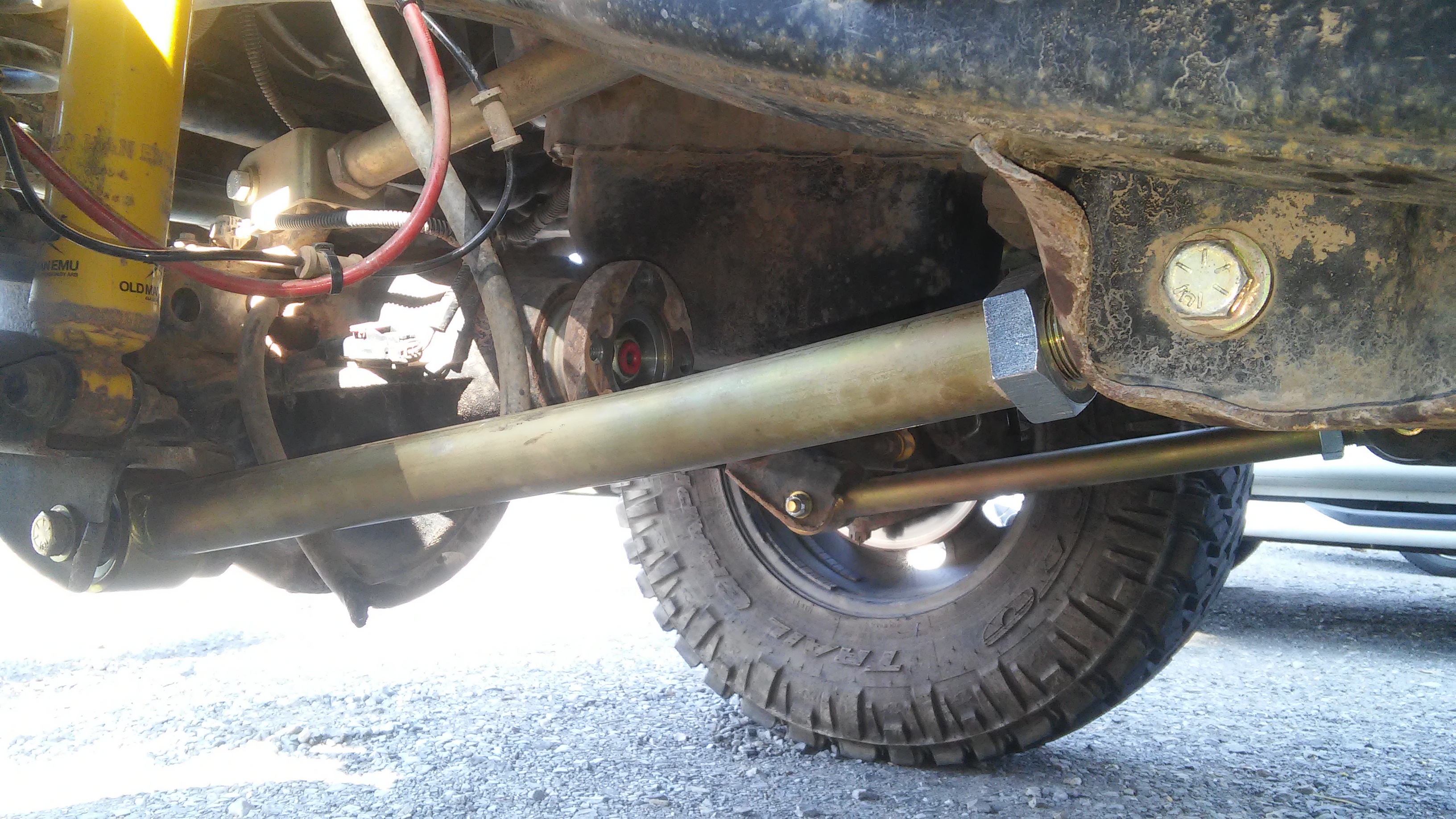

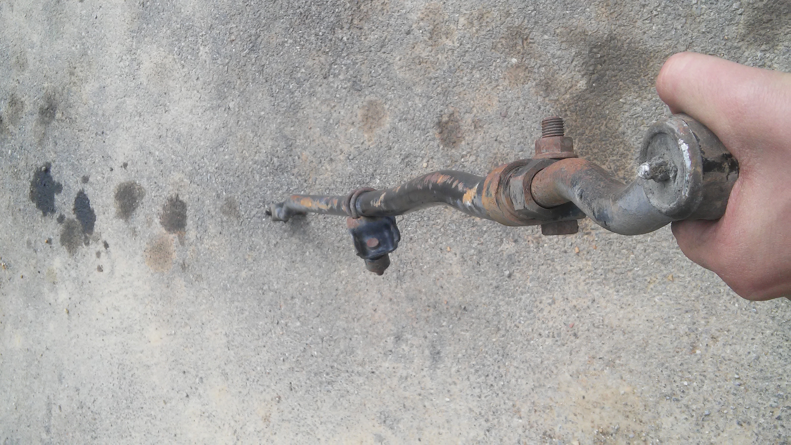

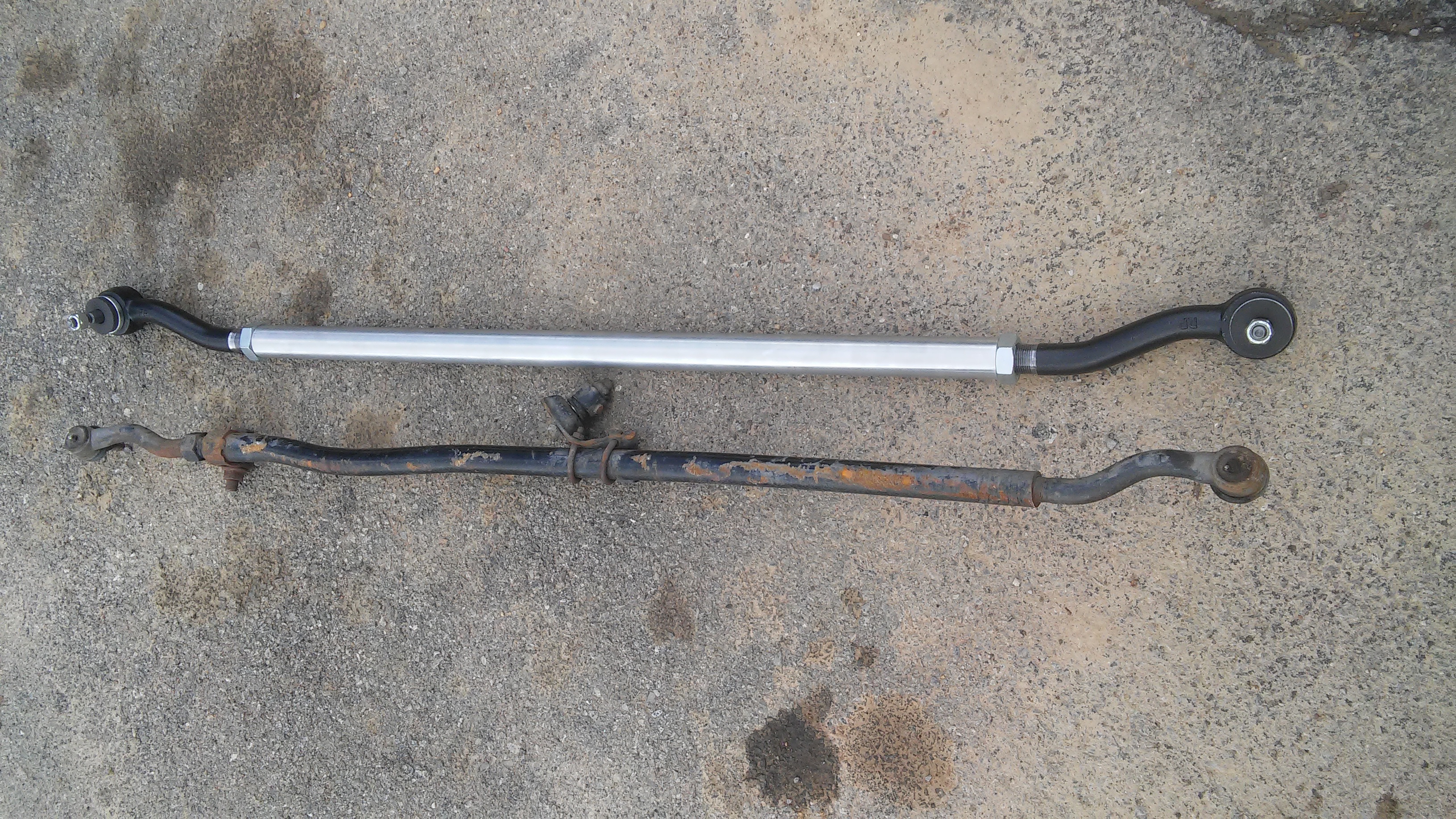

Then, finally came steering. I knew I wanted some beef setup as the stock one had become a noodle of a tube. After reaching out to various companies, I decided on the Fusion 4x4 2.5 ton steering system. It was a bit out of my budget at the time, but with the forum discount and position I was in, I decided to go for it. Couldn't be happier with how it turned out.
Removing the drag link and noodle tie rod
Comparison of TR
Installed
Checking Clearance
Ends rubbed ever so slightly against the dust shield, so I cut that off.

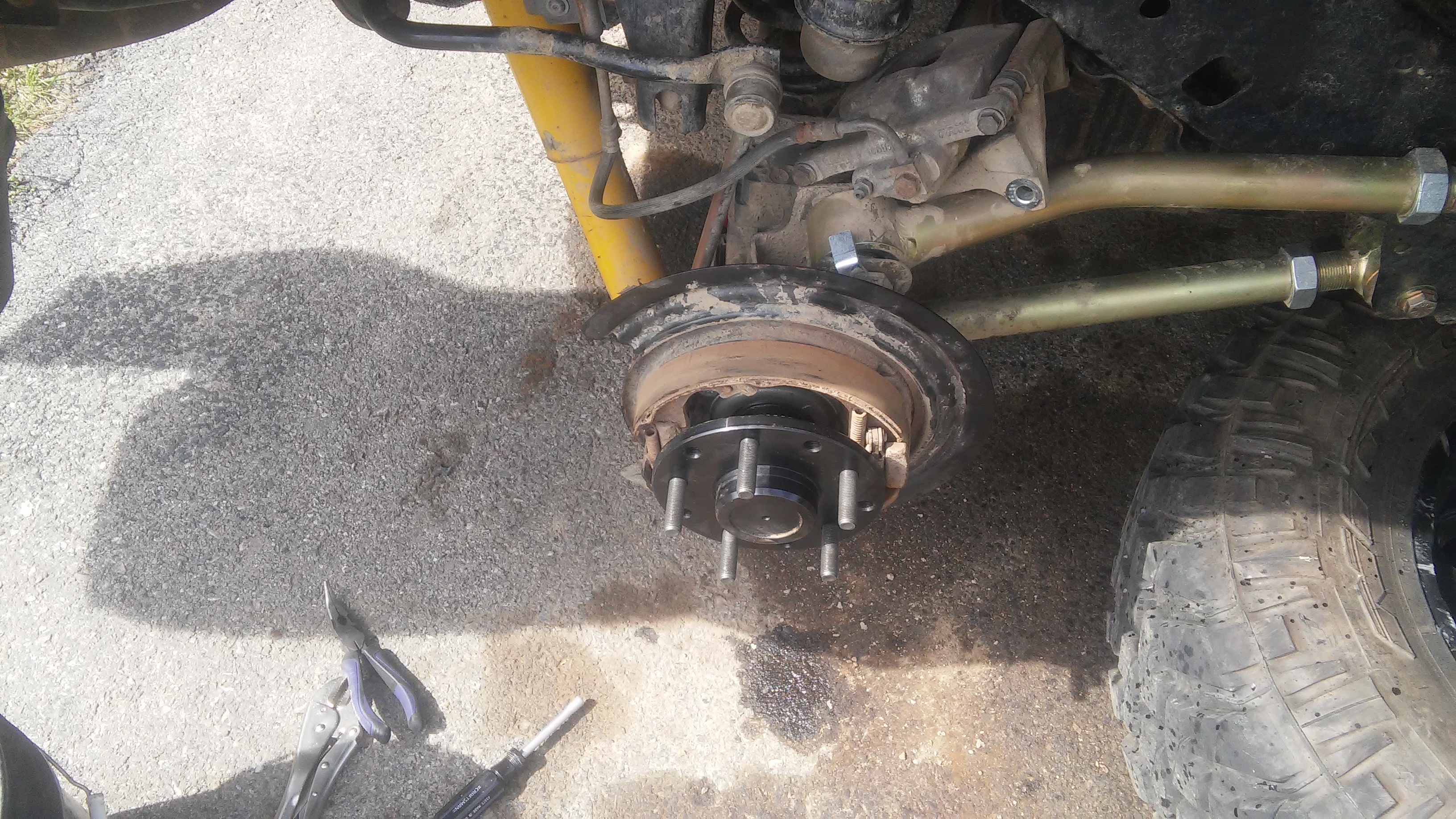

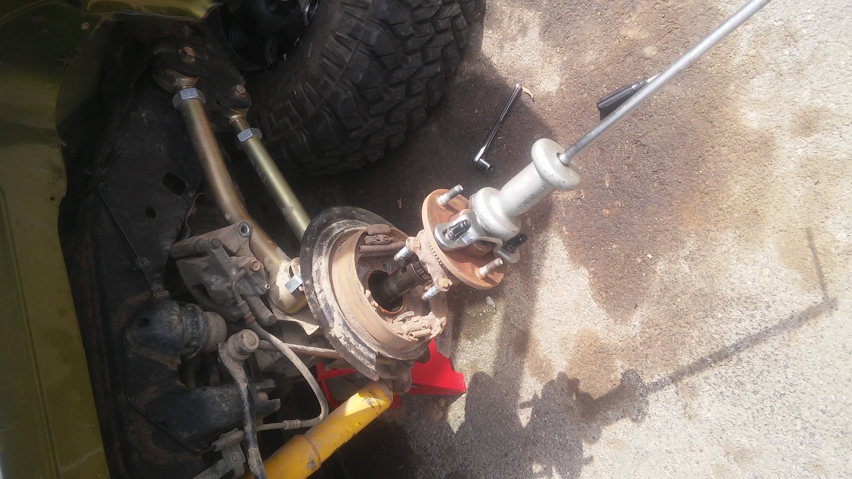

After all the repairs I took it for a test drive. Everything was fine until about 55mph on. From there the jeep seemed to shake. I couldn't pin it down, but it didn't feel like one specific problem.
Upon inspection I noticed the control arms were to length as what best fit. I found out later from my friends who helped that they were just throwing them in knowing I would align it later. Well, after some adjustment everything was square. Test drive #2 and the jeep is driving better, but still not great.
Well, time to get an alignment print out. After struggling with finding a shop that would do it without worrying about damaging my wheels, I was correctly aligned. Test drive #3 and the wobble is better, but again not fully fixed.

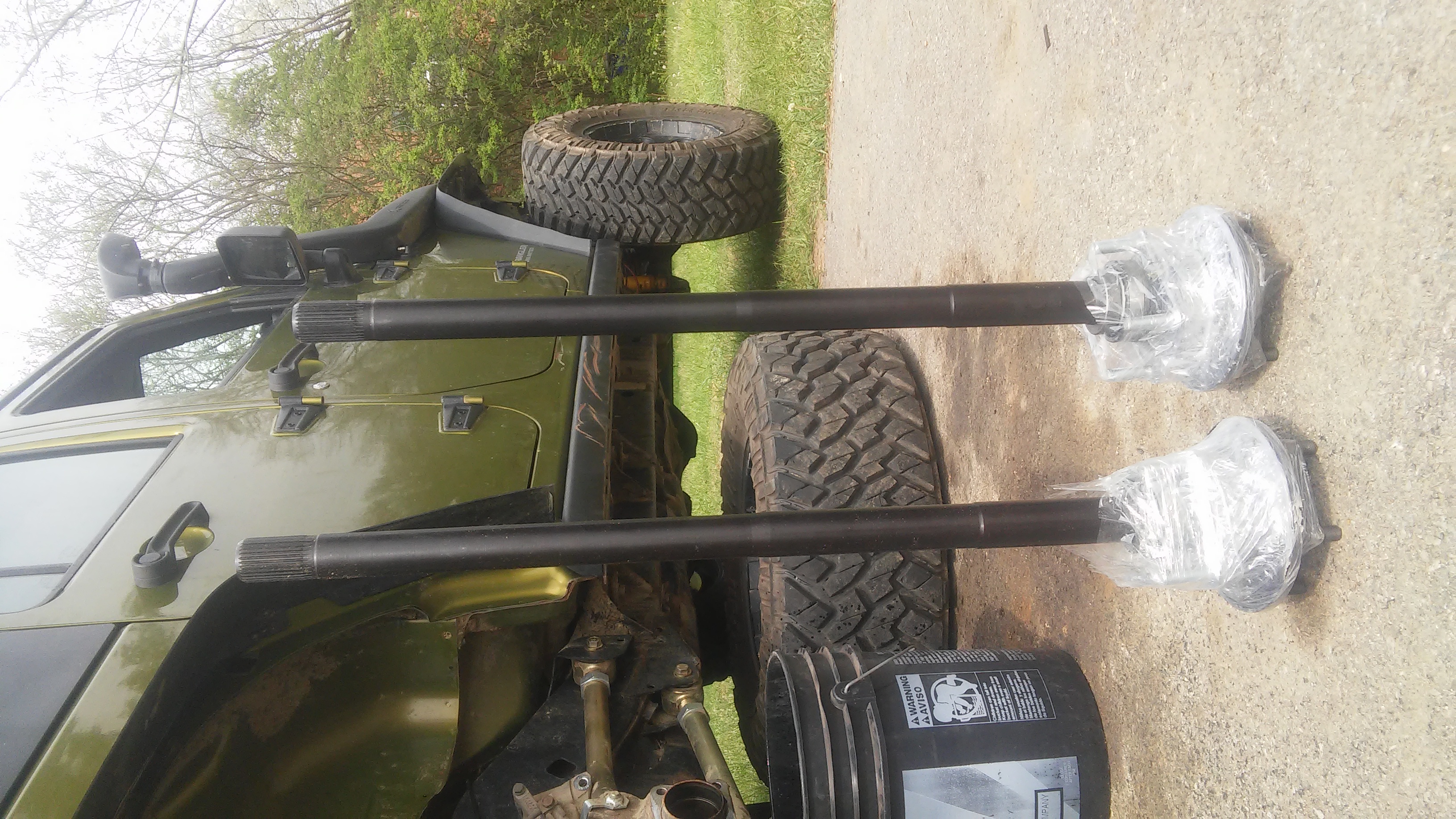

Finally, after a friend pointed out a wobble in my tire I attached a gopro and drove around. Only to discover I had bent something along the passenger side rear drive line. Axle tube, axle shaft, caliper all went under inspection and as it turns out the shaft was bent. Discovering this on a Tuesday while you are supposed to leave on Friday for a weekend trip is not ideal. One quick call to East Coast Gear Supply and I had a new set of shafts with bearings pressed delivered on Thursday.
Getting the bent shaft out was a struggle. I tried flipping the caliper and using it as a redneck slide hammer to no use. Finally ran down to advanced and picked up a slide hammer.
New shafts!
So...after new shafts, diff covers, CAs, steering, a rear drive shaft, and no front drive shaft. I was finally on the road again. Well, after a tire balance.
