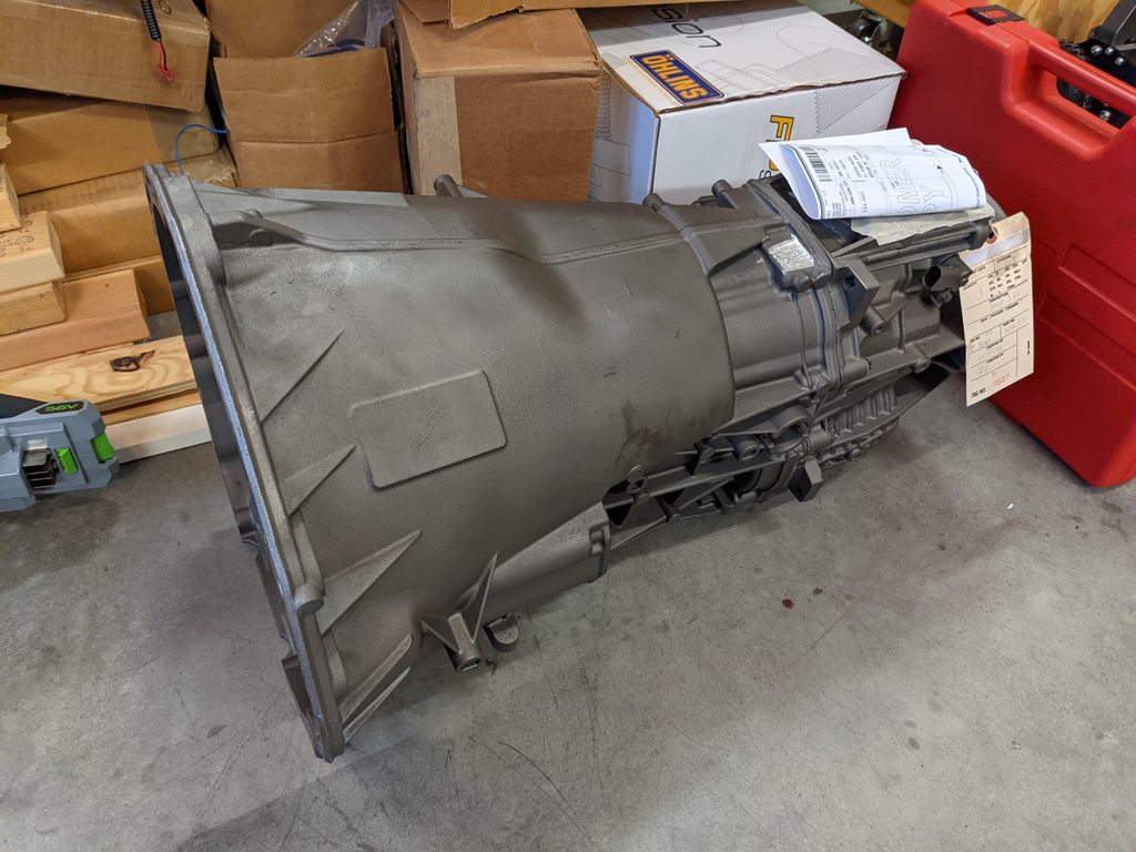

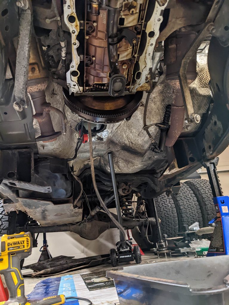

I had the freshly rebuilt trans ready to go before opening up the Jeep. The last transmission removal job took me eight months, not because it takes that long, but because I just don't get the time to put into it. I didn't want that to happen again and I had planned for a two week swap. Yeah, right.

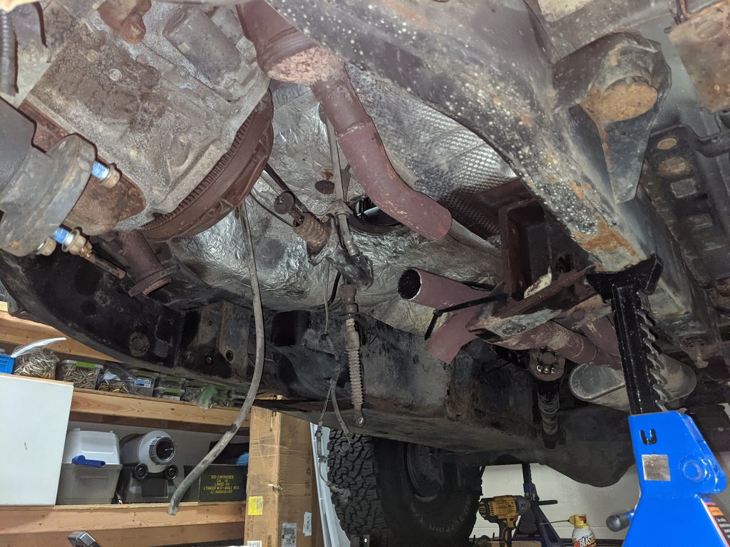

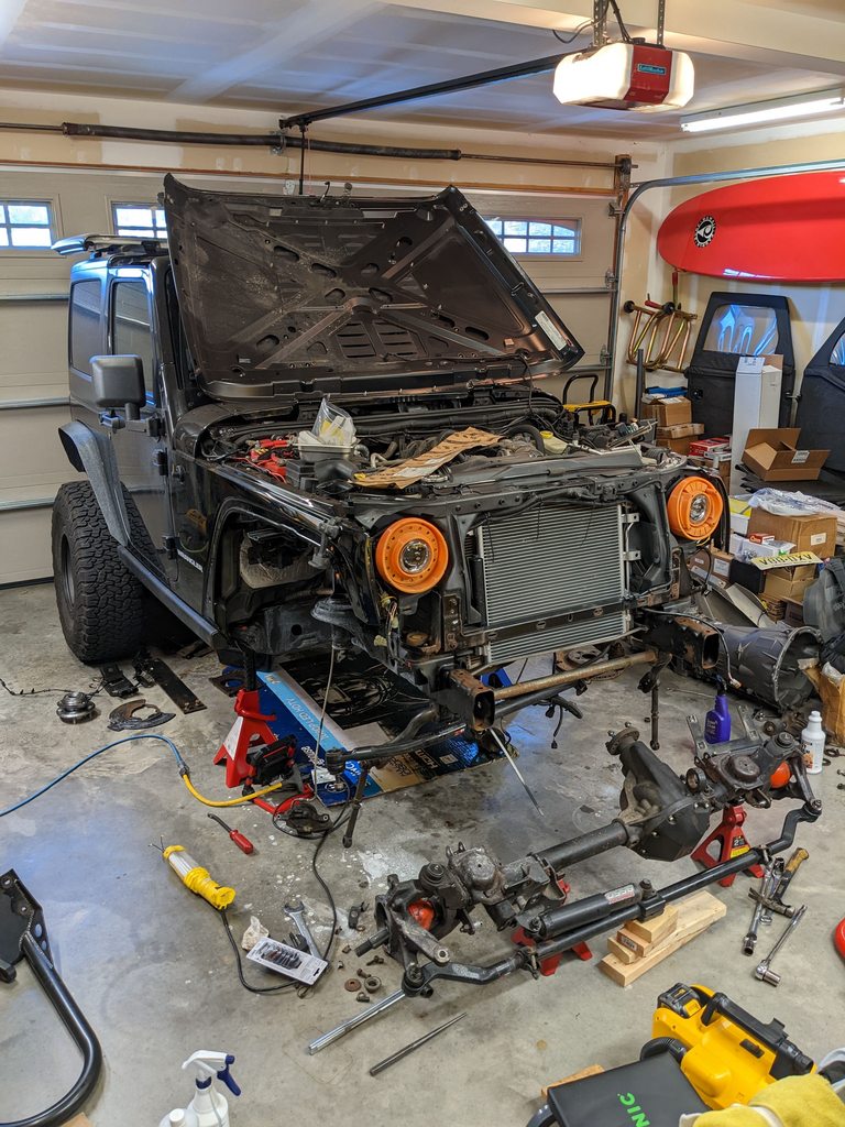

I had a buddy giving me a hand and we had everything apart in short order. We had to cut the exhaust out, it was welded front to back and there was no way to work around it. That's something that I'll have to address down the line.

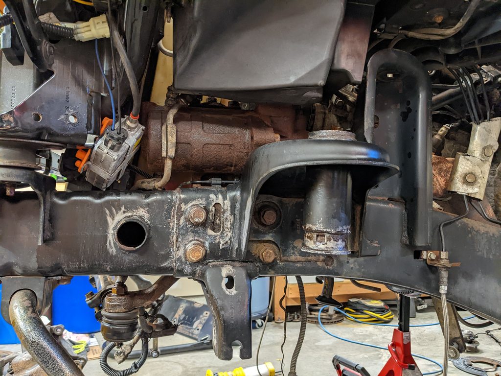

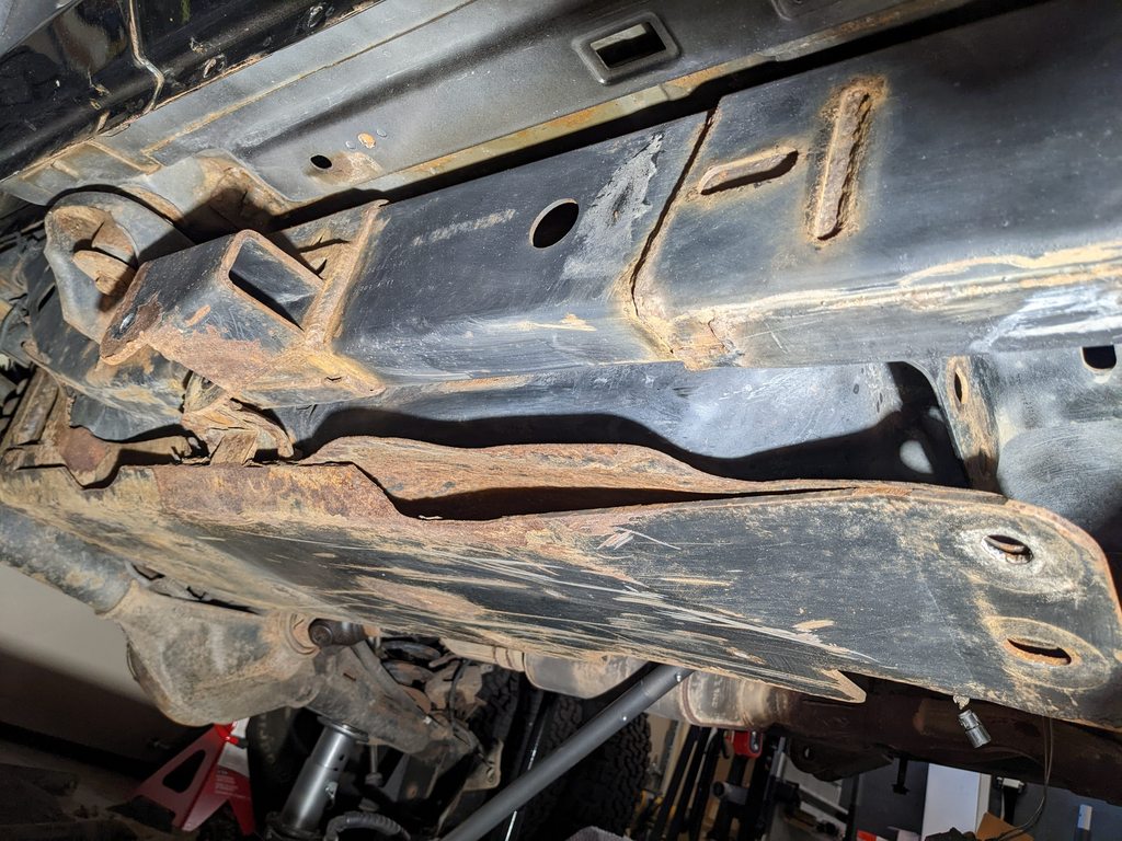

I have a RK long arm lift and, in order to pull the trans, I had to remove the three front links. When they came out they were NASTY, especially the upper link which is closest to the exhaust. Just brutally rusted and pitted. The lowers were pretty gnarly too, but I gave them a pass because they get scraped and pebble blasted. My initial plan was to clean them up, have them recoated and then reinstall. I figured it was a nice opportunity to swap out the joints though, so I started looking into that. I had been wanting to try Metalcloak's Duroflex joints and I figured I'd be able to shoehorn them into the RK arms. Not so much. After kicking around a few ideas I decided to bail on the RK arms and have a custom set made, which I've posted about here before. Here are the RK arms:

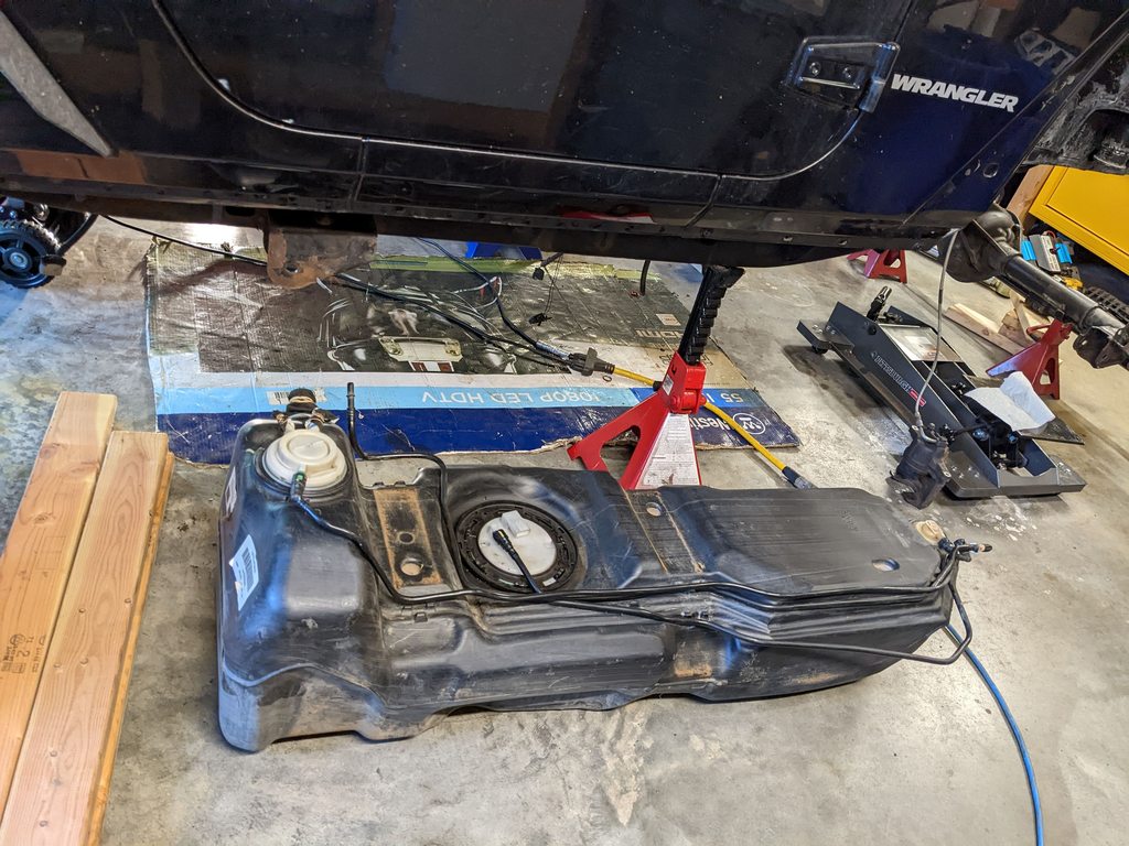

Got some time in today. Scraping and sanding rust is a disheartening thing. I can scrub for hours and it just seems like nothing gets done. I know there's progress but it's so gradual. So to break up the monotony today I cleaned the oil pan and tcase skids and took down the fuel tank. Those stupid fuel line clips are a giant pain, and I broke one. Is this the best that we, as a society, as a species, can come up with?? Aside from the clips, the tank came down without a hitch. I'll tell you what, this transmission jack has been coming in handy. Once the tank was down, I gently wedged in some 2x4 blocking to get the tank separated from the skid. Some jackwagon left a half tank of gas in the Jeep when he parked it, so now I have to lug all that fuel around. Here's the bare tank, free from its shackles:

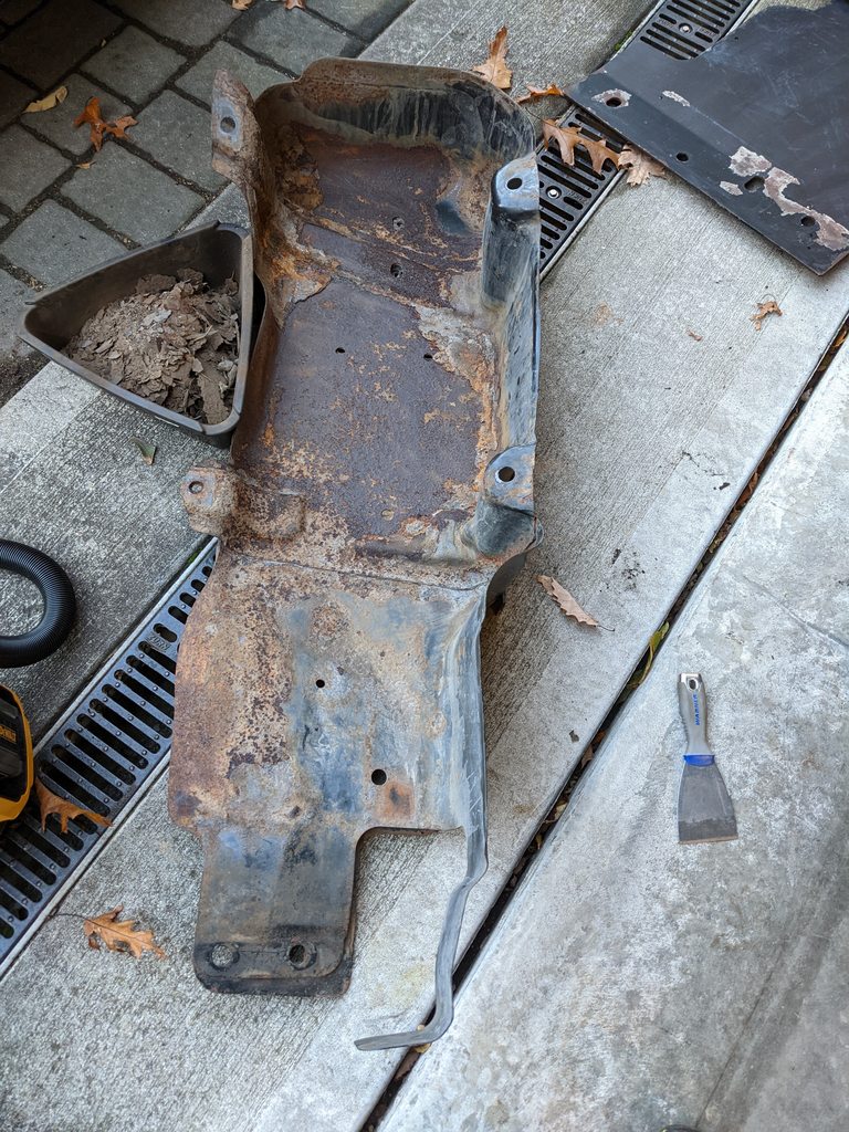

And the stock skid, after a quick scooping of all the rust and debris. You can see it in the catch pan actually, there has to be at least five pounds of it.

The tcase skid is a little bit in the above pic as well. I sprayed it down with degreaser (that's where all the leaking oil from the oil filter housing ended up) and scraped it and it's not in bad shape. The bottom side is worse and it has a good bend in it that I have to get out. But that just means it's loved.
