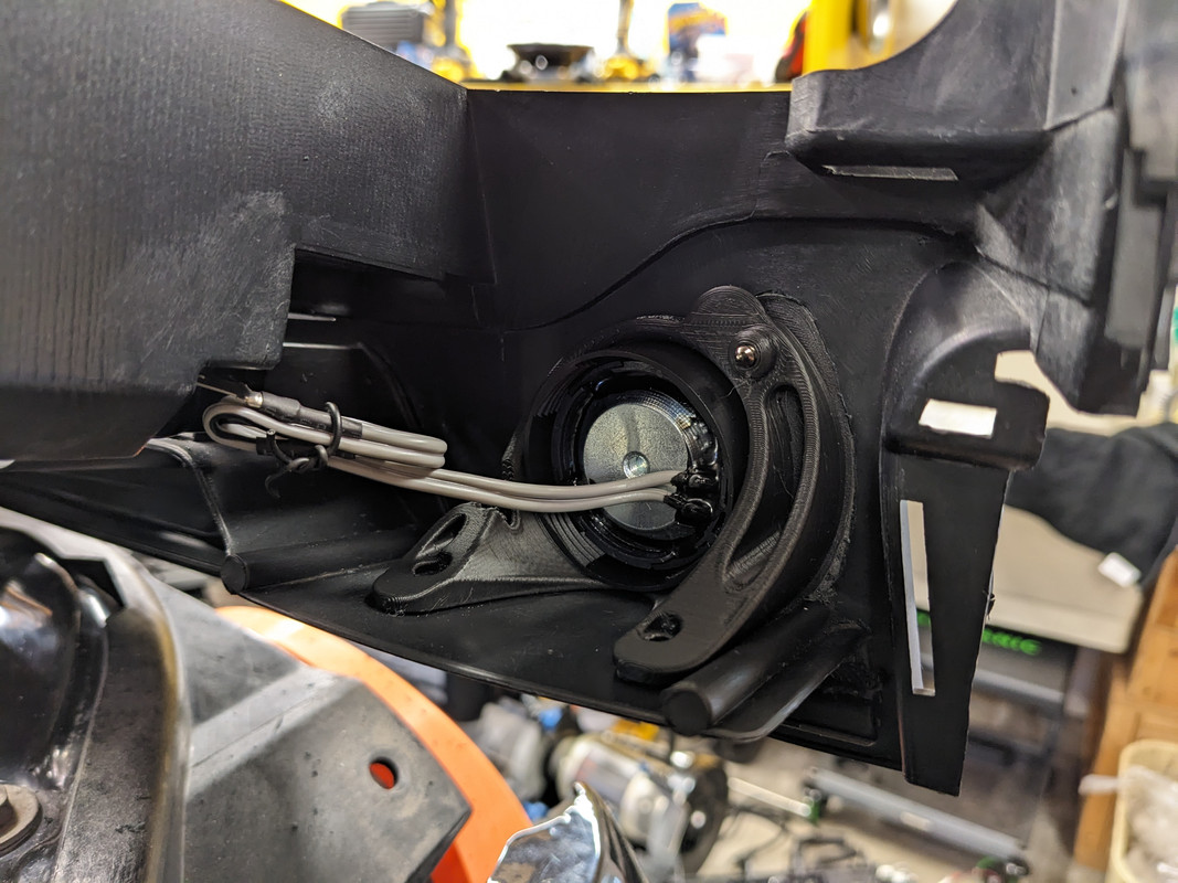

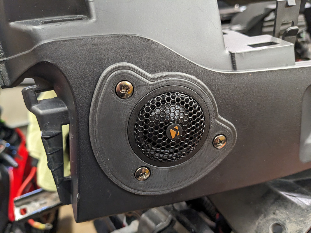

It sits flush around all the edges and I think it looks clean. Should fit any 1" tweeter, the file can be adjusted if need be for mounting. Here's the bracket in case anyone's curious:
The legs get screwed into the dash plastic so the tweeter and trim can be removed from above.

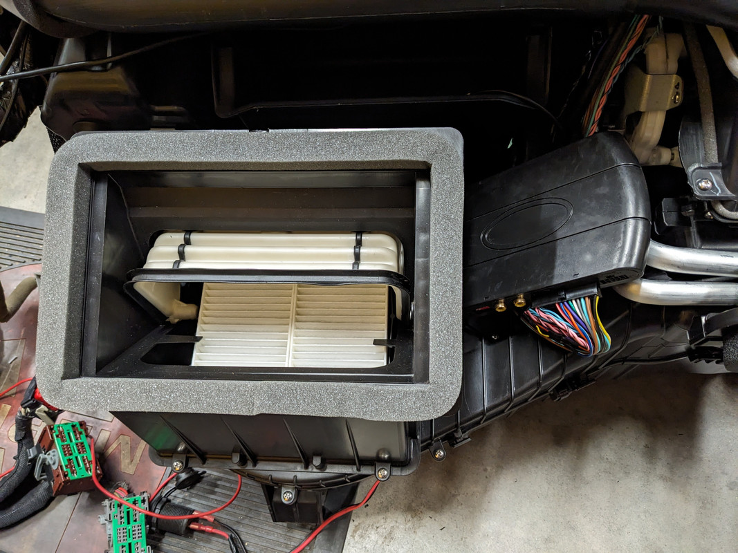

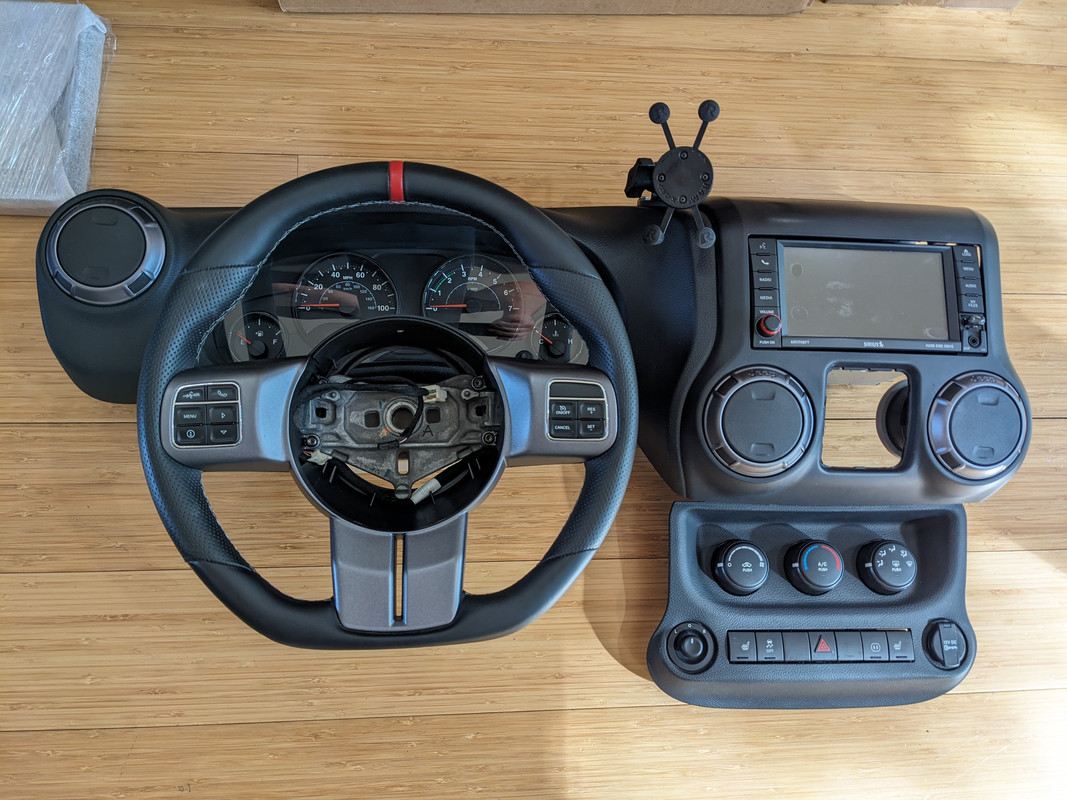

Now to cut out the other tombstone, print another bracket, and paint the trims. I mounted the evap core and blower motor so there are only plastics left to finish the dash. Oh! In my quest to rid the cabin of chrome I did some things. I pulled the steering wheel apart again to get at the button bezels. These are the same chrome that was on the HVAC knobs, impervious to everything I've thrown at it. Maybe they used a different application on surfaces that would be handled and something less robust/cheaper on those gauge rings? Either way, the button bezel chrome seems to be applied in place, and the housing wouldn't break down all the way so the buttons wouldn't come out. I considered hyper dipping them but for now I'm just going to let it ride. These are easy enough to remove and take some time with in the future if it ever matters to me again. Same story with the volume knob chrome, except the volume knob comes off. The knob assembly (knurled knob, chrome ring, smooth top) looks like it comes apart but I only fiddled with it so long. I scuffed the chrome, masked it, and painted it. I tried red just for a little pop of color to match the noon marker on the steering wheel, not sure if I like it. I'm also second guessing not painting the gauge rings, but it's all going in as-is because, again, these things are a cinch to revisit any time after the Jeep is running. I mocked it up for kicks, what do you think?

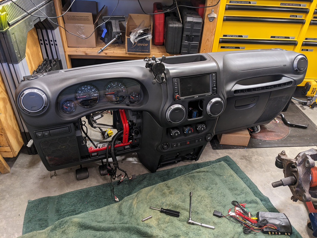

Well here we are
Tweeters are done, everything is mounted up and plugged in. Except for the Mygig Lockpick which I'm making a place for. I don't like the red on the radio knob. I pulled the old AC plumbing and cleaned up the interior. I think I'm gonna drill the three holes for the legs of the PSC trail cage while the dash is out, it stands to reason that I'd get more accurate holes if I drilled them from the inside. Which isn't possible with the dash in place. This way I can still put the cage in whenever I feel like it, but those holes will be done. It's nice to see the dash in one piece though.

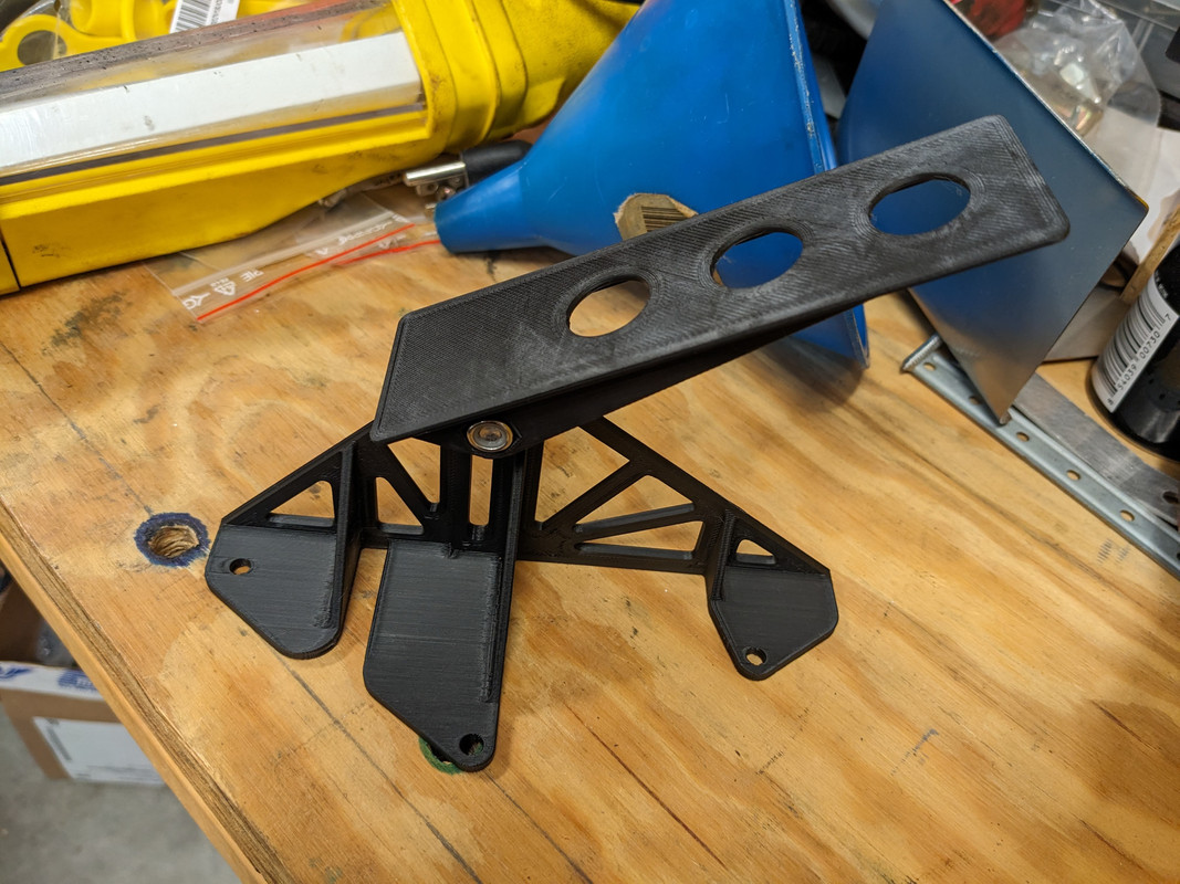

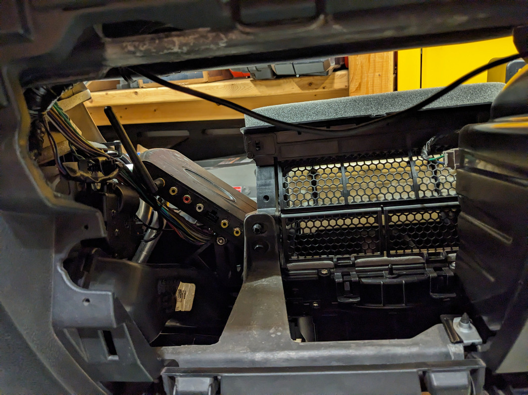

In the meantime I made a bracket for the ol' Lockpick and got it mounted up where I think it will be a. accessible, and b. not in the way of anything important.
The bracket (angle adjustable!)
Installed. It uses three screws that hold the blower housing together.

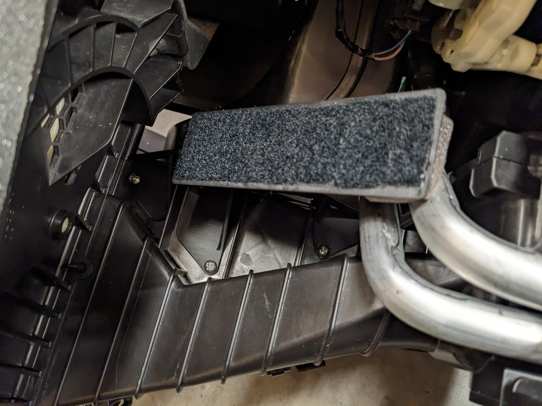

From the back.
Access with the glove box removed.
The top of the bracket can be removed with the dash in place (captive nut) to mount something else too. I don't want to pull the dash again anytime soon.

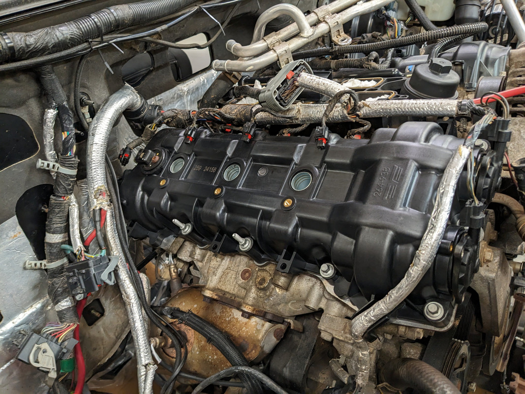

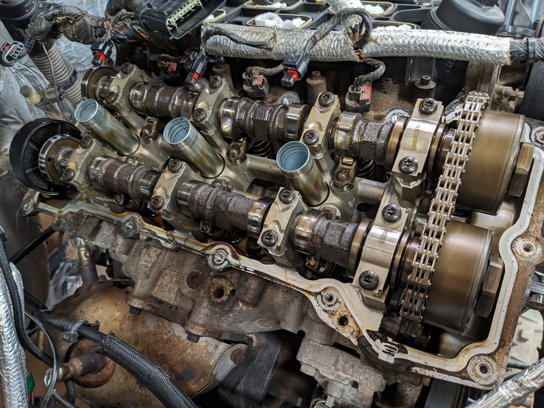

Switched gears today because the valve covers came in like lightning. Even with just about everything removed from the right side of the bay, that PCV was a PITA. One of the coil bolts broke in the cover, though it doesn't matter much since I planned to replace the cover already. I knew it was going to break as soon as I put a wrench on it, but I did my best. It broke anyway. Inside I think the cams looked pretty solid. the lobes were all flat from edge to edge and nicely polished down the middles.
And the new cover in place.
I have hardware coming in tomorrow to finish that up. Ordering one bolt isn't really a thing so I ordered a bunch to replace the old hardware just for kicks.

I just swapped the oil filler tube over to the new driver side valve cover. It's just a twist-off with a little locking tab, but there are splines in the valve cover hole that threw me for a minute. So, next time you remove one, just lift the tab and twist.

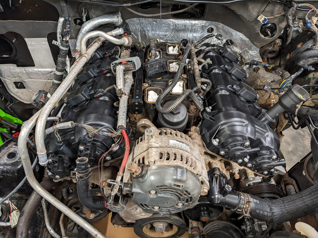

Got the line of rocker arms and lifters replaced. Thanks to the videos and some sage advice regarding torqueing that oil control valve down with a wrench on the cam shaft, all went smoothly with no mishaps. The valve cover is back on, new spark plugs and boots are in, lots of new, shiny hardware installed. I'm going to wrap the wiring in that tough-to-reach spot between the engine and the firewall and then I'll clean up the intake manifold and put it back on. I have an oil catch can kit kicking around that I'll put in as well. Every time I take the intake manifold off it's practically dripping oil out. Actually I should put the dash in and connect the heater and AC lines before the intake manifold. too. Lots to do, as usual, but progress!
