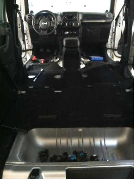

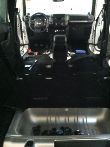

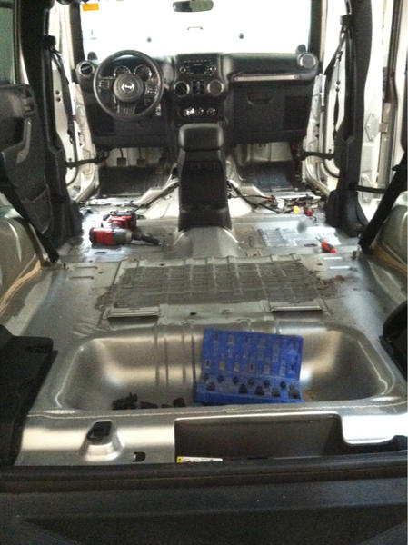

Ok so maybe the title could use some revision! I learned today, after an argument last night with jk 505 my jeep with me in it and 1/4 tank of gas weighs in at 5100 lbs on the nose!
Then after working a 12 hour shift I headed to the body shop and proceeded to rip my jeep into a thousand pieces to put a raptor liner in it this weekend!!! Got it all dismantled today going to attack the sound deadener tomorrow!!!!

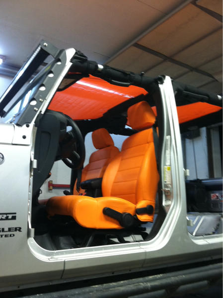

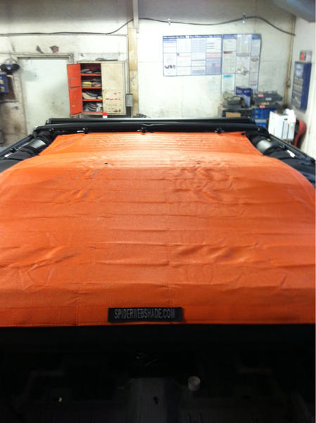

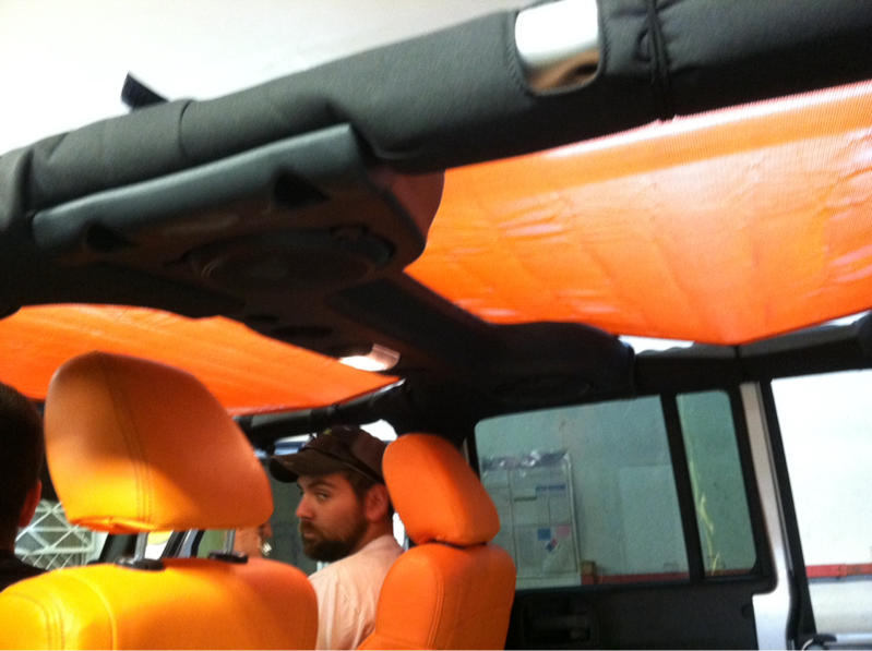

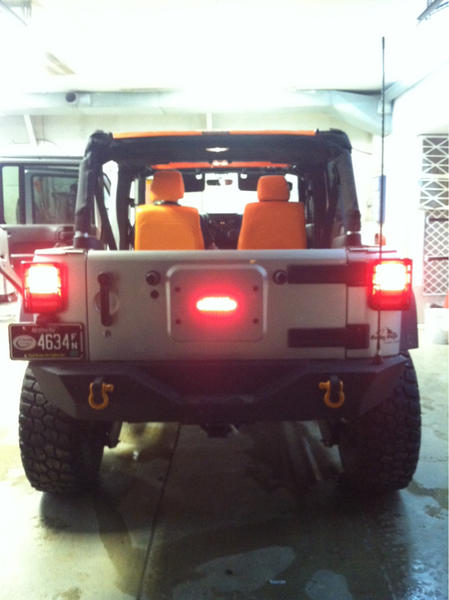

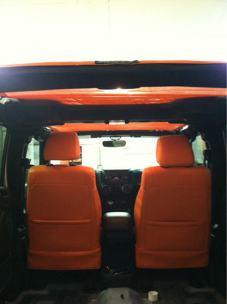

Pardon the lack of interior am in the process of putting in my raptor liner!
Again guys and gals this is what being a jeeper is all about!

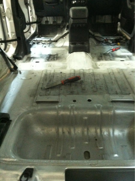

I don't even know where to start.... First off I busted the whole jeep apart Monday and started to strip for the raptor liner install. Tuesday I started the process of ripping up the sound deadening :eek: I thought that I could use a tool for removing seam sealer from cars called a snap on crud thug, this thing is awesome. The sound deadening laughed in it's face! So I busted out the air chisel and it did wonders!! Then I straight line sanded all the area I wanted lined with 120 grit sand paper, cleaned the surface and had to work Wed. And Thursday.

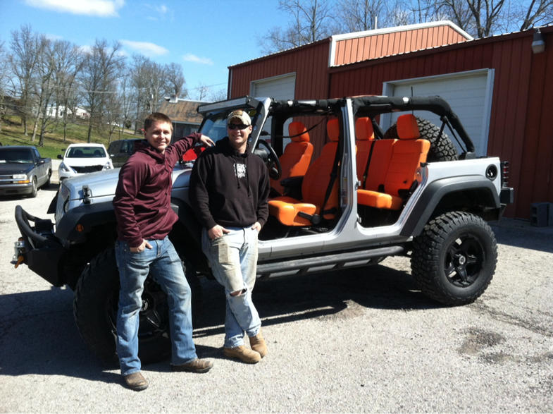

I got off work at 7pm and drive home Thursday evening. When I pulled in the drive way I was looking at my phone as I pulled in the driveway and didn't notice till I got to the end of it that the person I was texting was standing in my drive way leaning on his jeep. None other than JK505. He and my wife worked out a surprise for him to come up and help us wrench all weekend! He lives 600 miles away! I couldn't have been more surprised if I'd woke up with my head stapled to the carpet. Sooo here we go!!!!!

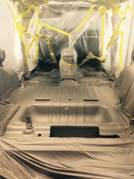

So Thursday night we just chilled and let 505 relax from his 600 mile trek! Friday morning we woke up and hit it hard! We couldn't get into the paint shop till 5 so we wrenched on his rig from 8:30 till 5 I don't wanna spoil his build thread so I'll spare the details but man did we ever get a lot done!!!!

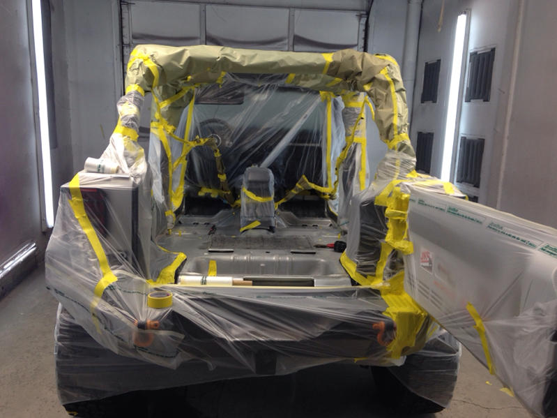

We got the paint booth open at 5 and started the process of prepping the interior for liner. Tapping and masking was a labor intensive process but needed to get a quality result. I had a lot of trouble trying to pic the color I wanted and everybody there decided that charcoal would look very nice so I tented it up, added 2 oz of silica to each mix and let it spray!!! It was nerve racking but the end result is super nice!!!!
