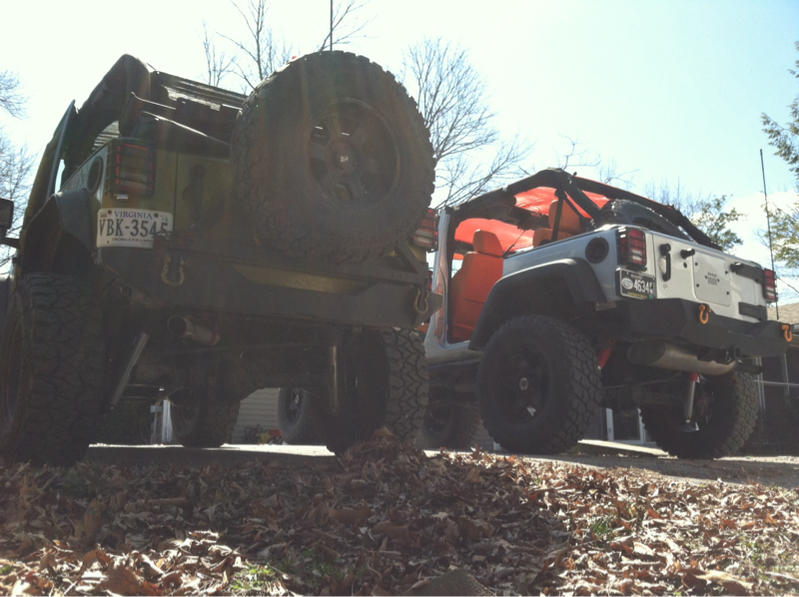

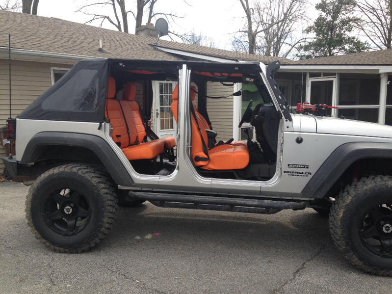

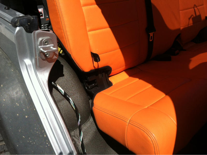

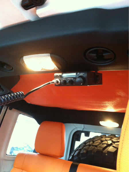

Sat morning we got up and reinstalled my interior, relocated my cb and reinstalled my tire carrier. Also 505 had some high lift hood mounts by river raider that he wasn't using so I bolted that up and got my high lift out from under my rear seat for the winter! Incredibly happy with the end results. We were growing tired of the constant wrenching so decided we'd go try out 505's new lockers!!!!

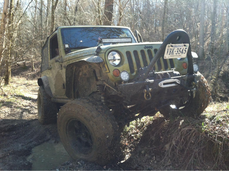

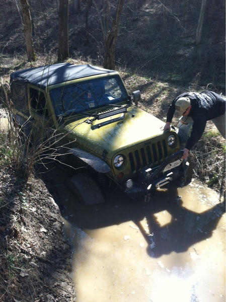

Sooooo after lunch we decided to introduce JK 505 to some good ole ky mud I won't go to details but fun was had and cable was pulled! Perhaps now my constant pursuit of getting me some BIG OL TARS makes sense to him!!!
That's a dang good looking tire carrier. Looks mean
'Buy lockers,' they said... 'You'll go anywhere*' they said... OBVIOUSLY they never wheeled in whatever was at the bottom of that hole. Just sayin.
*Anywhere except in Kentucky.

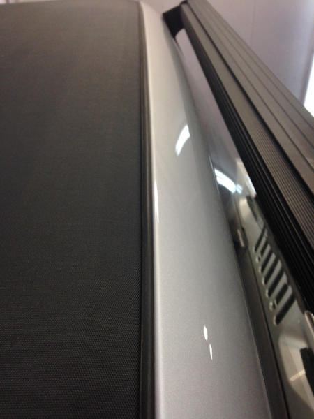

Also had a couple from a neighboring town come over to see about a trade plus cash for their trek top for my hardtop we installed it and put the doors on my rig and I was very disappointed with the fit and finish of the standard trek top it seemed cheaply built and fit loosely even though the top was only two weeks old. Now I see why they wanted to get a hardtop back so badly. I'd like to try a NX and see if the quality is any better. I also didn't like the idea of it not needing a windshield channel or a frame, at the end of the day I couldn't in clear conscious trade my hard top off even with a substantial amount of cash to sweeten the deal.

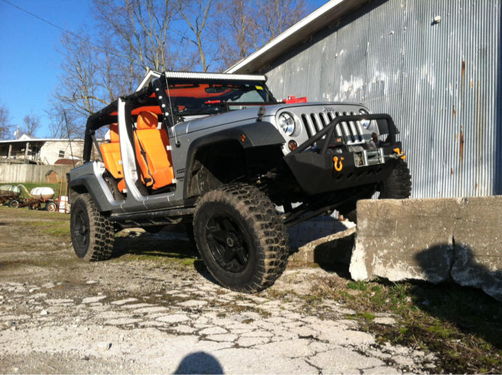

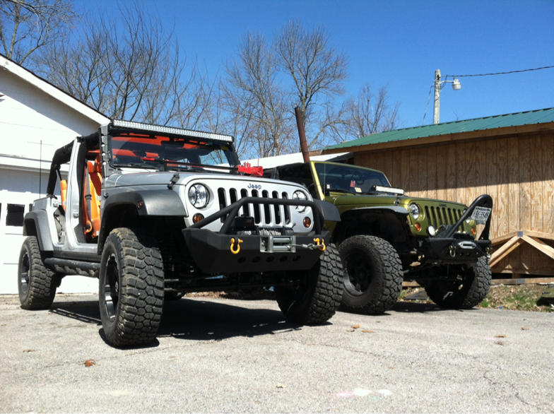

All and all it was a great weekend hopefully this week my rear gears and lockers will arrive and we will be one step closer to windrock ready! Next time you see these to rigs together Silver Strike will most definitely not be a mall crawler any longer!!!

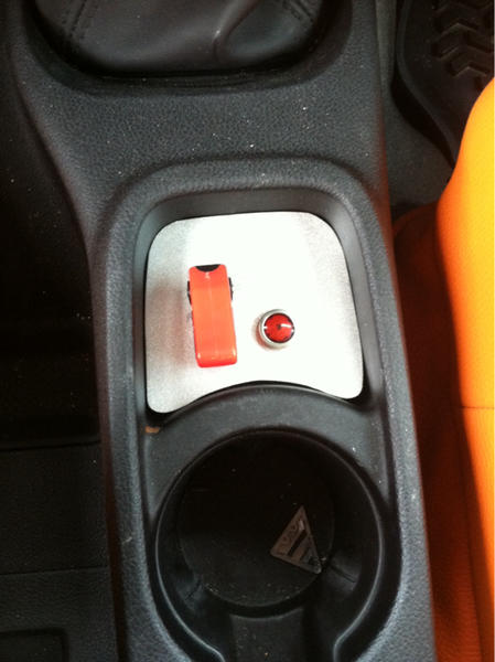

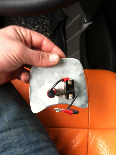

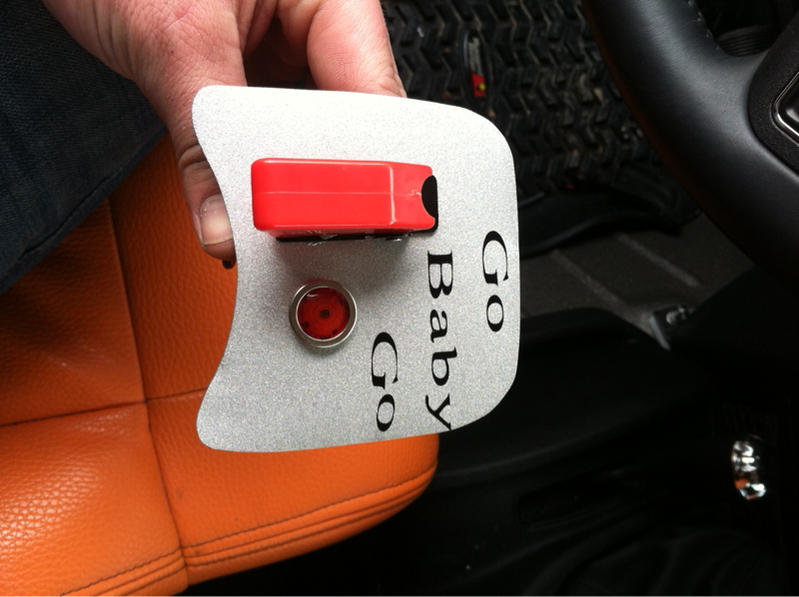

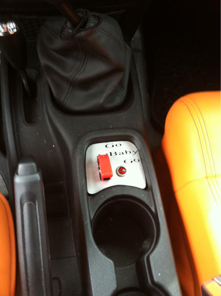

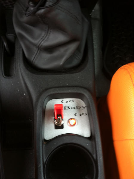

So today I wired my new rubicon locker up, I used a rigid wiring harness for a 20-30" led light bar, I sourced this through overland off-road. I wanted to use this harness as I had extremely good luck with their products in the past and it has a built in 40 amp relay. I bought the mopar locker harness repair kit for the pig tail to plug into the axle housing, and then soldered the two harnesses together.
The next issue was which switch to use, I don't have an spod or the cash to get one and the stock rigid switch leaves a little to be desired so I went to my local parts house and picked up a normally open toggle switch with a cover and an indicator light.
I wanted a nice looking install so I removed the factory change holder and built a panel out of a scrap piece of aluminum I had laying around, drilled a couple of holes, painted it with a color matched rattle can, then installed and wired my switch and indicator light. Because I'm a muscle car guy at heart I couldn't help and ad a little tribute to my favorite movie
Over all I'm extremely happy with the finished product! Now onto the rear gears and locker!
