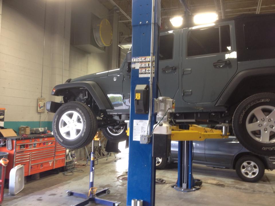

After driving it home that day in April, with 5 miles on it, I knew I was in love, this was it, this was my rig. I could longer hold off the urge, it needed a lift and tires, and the outdoors called me once again. So shortly after I got a Rubicon express Budget Boost.

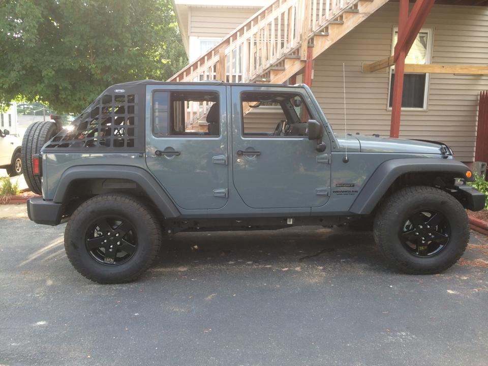

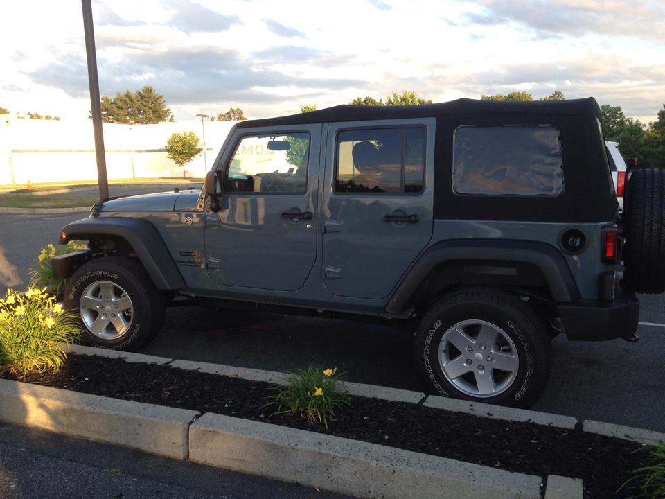

And what's the point of having a lift without some meat under it...
Old Jun 21, 2015 | 01:40 PM
JKWarthog's Avatar
Joined: Jun 2014
Posts: 6
From: Ludlow,MA
continuing with story...
Name:	bb 34s 1.jpg

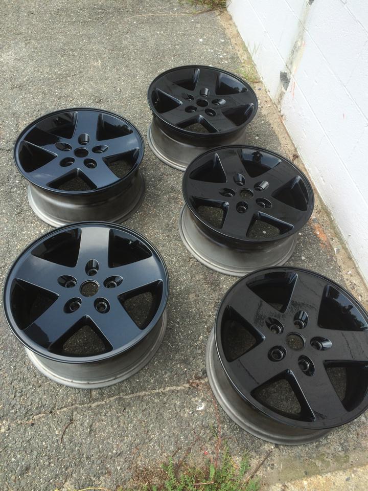

I was content , for the time being, but I really wanted some black wheels, good thing I work in the auto industry...

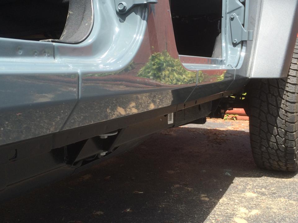

I got by with this setup for about a year, I did some mirror little things, some accessories, small mods, painted the god awful pinch weld with bed liner spray.

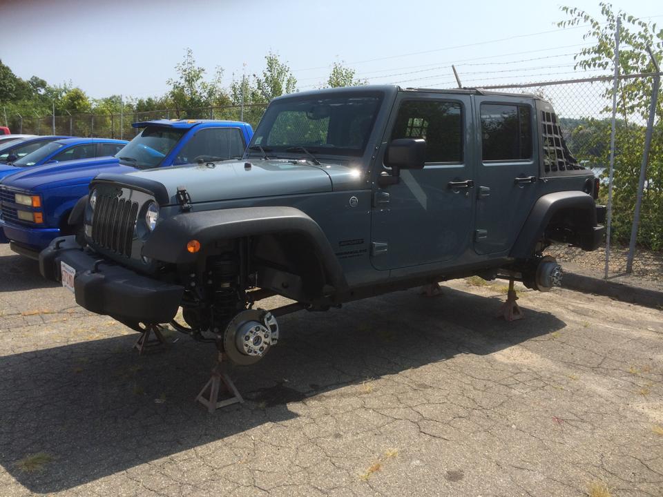

Now onto the more current things. After the local "Go Topless Day" that me and my GF attended, I really wanted to go up to a 3.5 lift, she even agreed after seeing other jeeps with that size lift. So one could argue it was her fault, that I bought Clayton 3.5 springs, Bilstien shocks and the Clayton rear track bar bracket, and TeraFlex front sway bar disco's. She said it was not her fault but I still blamed her.

Few details to mention thou, when I installed the new springs and such, I cycled the suspension with just the arms and drive shafts to measure for new bumpstops, ended up needing 1.5 in the front and the rear has a 2.5 which I can actually go down to a 1.5 later. I got new hose to make longer diff breathers and rerouted my rear e-brake cable below the frame in the rear instead of on top to allow for free travel. Removed the front metal brake hose bracket from the axle and cut it off the hose to have longer front brake hoses, then I wrapped the hose and ABS senor cable in rubber hose for protection from rubbing the shock. In the rear I got Synergy brake line brackets. I will upgrade to longer steel braided hoses later, first thing I need is a new front drive shaft. I made sure everything was tight, torqued and Aligned her myself before driving home. I was pumped.
