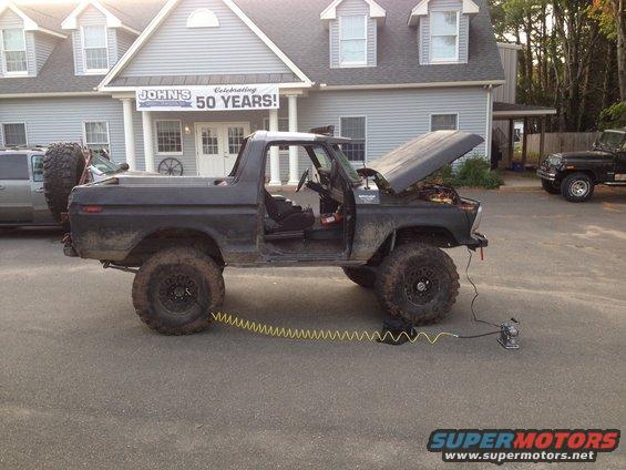

Avoid the cheap, "walmart special" compressors, they don't have the ooophh, and get one that draws power directly from the battery using alligator clips, not plugs into the cig lighter. Despite Smittybilt's less than stellar reputation, this one has served us very well for 4+ years :
Smittybilt Q89 Dual Cylinder Compressor. Sold at a number of places, eg http://bumpersuperstore.com/i-115749...FYM8gQodmV8AVg
Fills the 35s of the Jeep and 38s on the Bronco.

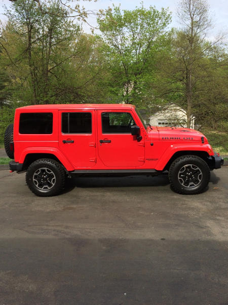

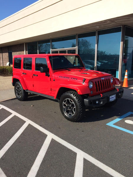

Hey there just got my 2015 rubi and plan on going on the beach. You say your on stock tires that sounds great to me ! Just had a lot of people tell me they would be no good in sand to aggressive. But happy to hear you had no trouble I would be bummed if I needed to buy more tires. Click image for larger version
