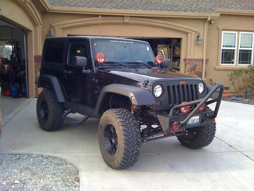

I have the stinger hoop on the rugged ridge bumper and I have D rings that you can simply unscrew.
