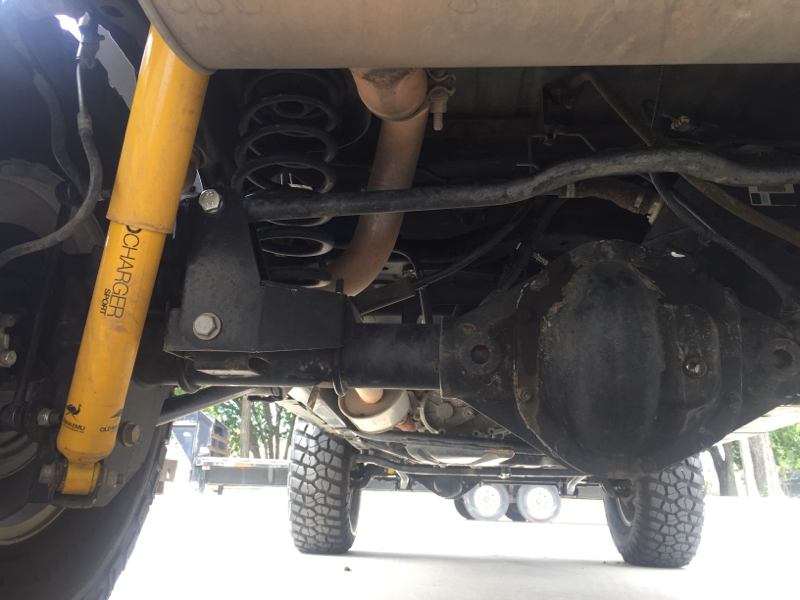

I currently have the pro comp 3" level kit and Nitto Trail Grapps LT315/70R17. Kit was about $400 and wasn't hard to install. Didn't have to do any modifying to my rear bumper or anything, just used 1.5" spacers on the tire carrier.

Looks great!

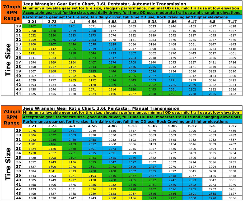

Still probably 35s with stock flares, 37s with flat flares. (Guestimating could be wrong)
Common tire sizes go something like 33, 35, 37, 40.... 33s are biggest you can go while maintaining mostly stock. 35s require mods. 37+ require heavy mods.
If you go with 35s or bigger you'll want to regear to gain power and some MPG back. I believe 4.88 is the sweet spot, but if you want something better than stock you could probably get some 4.10 Rubicon take-offs cheap on Craigslist.

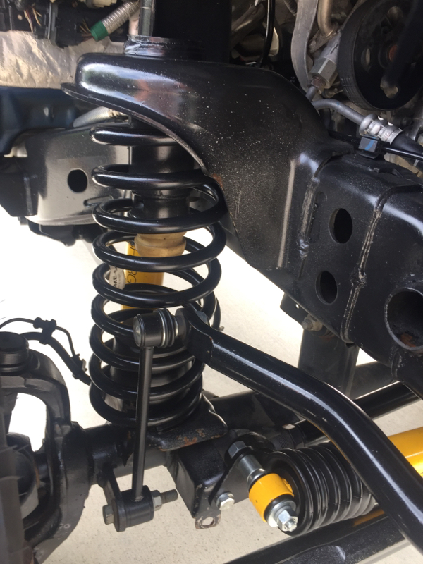

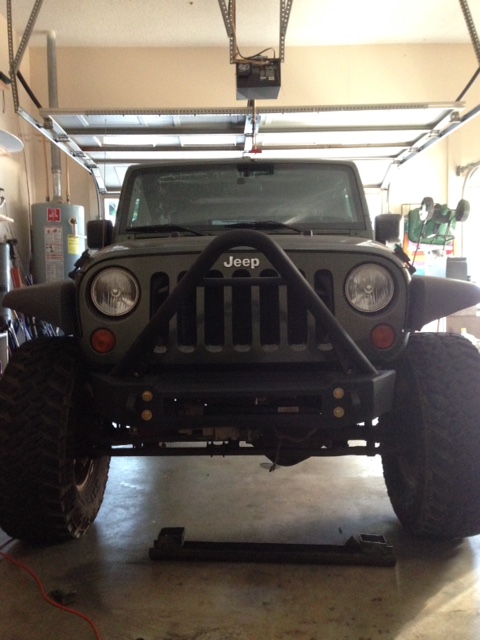

The 4 inch old man emu is a great lift I installed it myself, was not to difficult. I enjoy having the extra room for when I get 37s after the 35s
