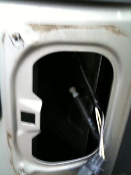

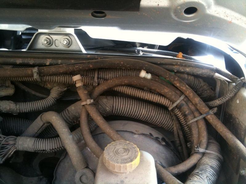

Just crack open the top fill plug in each diff and take a peek with a flash light or dip your finger in to see if you can see the color. However, I usually just grab a small syringe that I have kicking around and stick it in and suck out some fluid to see the color.
If it's looks at all milky or chocolate milk color time for a fresh oil change. If you do have water in them I highly recommend you drain out the diff's and then pull off the differential cover and use some brake cleaner too give it a good cleaning and add some royal purple 75w90 gear oil.
good write-up on diff fluid change;
http://project-jk.com/jeep-jk-write-...hange-write-up
Breather tubes...easy job!
5/16 regular fuel line...not fuel injector line (spendy), a few hose clamps and zipties is all you need.
For the rear differential - I ran it up into the passenger taillight area.
For the transfer case & front diff & tranny I ran the new lines up into the engine compartment.
A few good threads for breather tube extenstions: https://www.jk-forum.com/forums/show...ube-Extensions
http://project-jk.com/jeep-jk-write-...hose-extension
