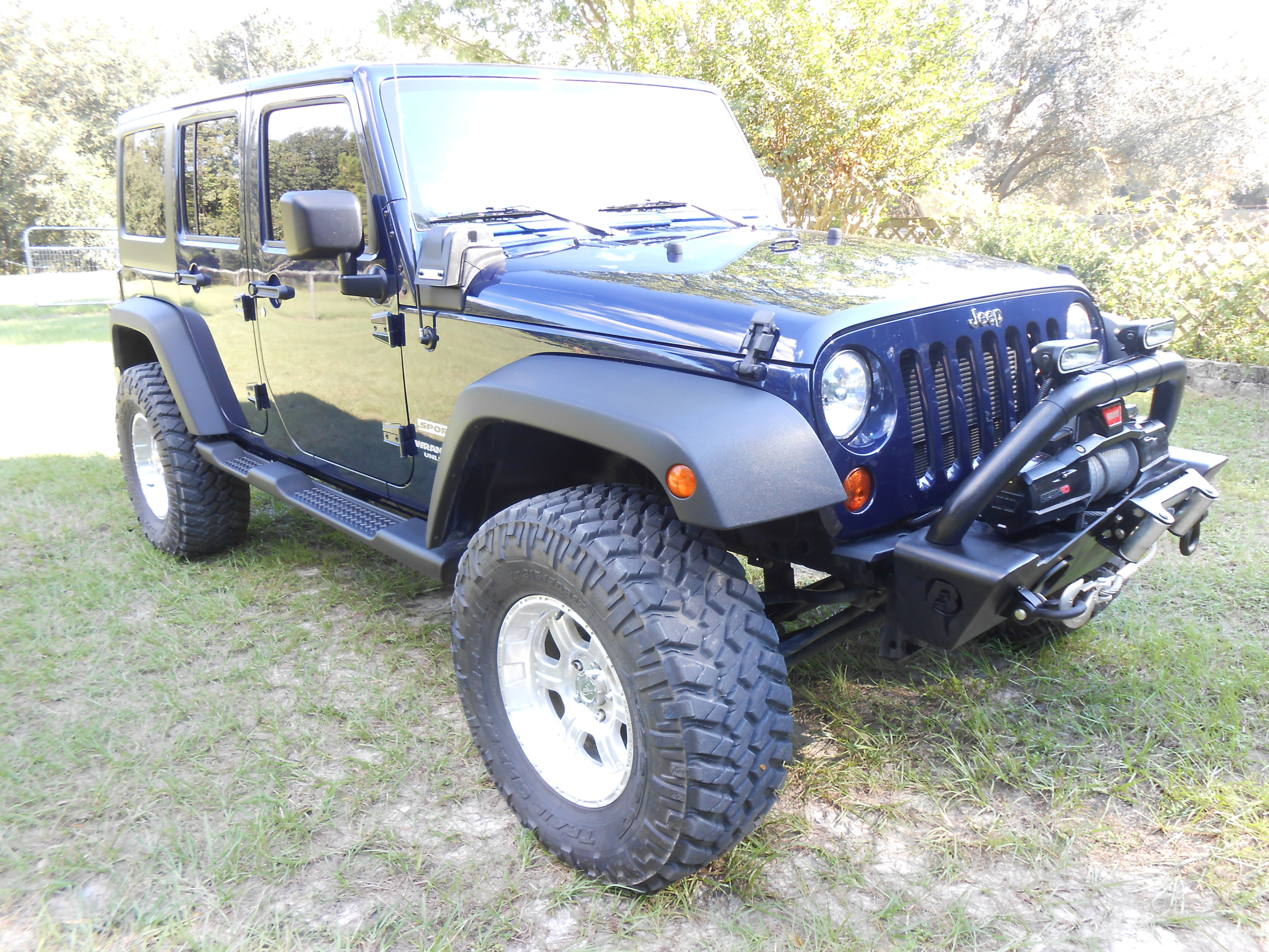

Old Jan 23, 2016 | 03:46 AM
DadsCJ's Avatar
Joined: Nov 2006
Posts: 991
From: Archer, Florida
Running RK 2.5" with Bushwacker Flats and 37's.
