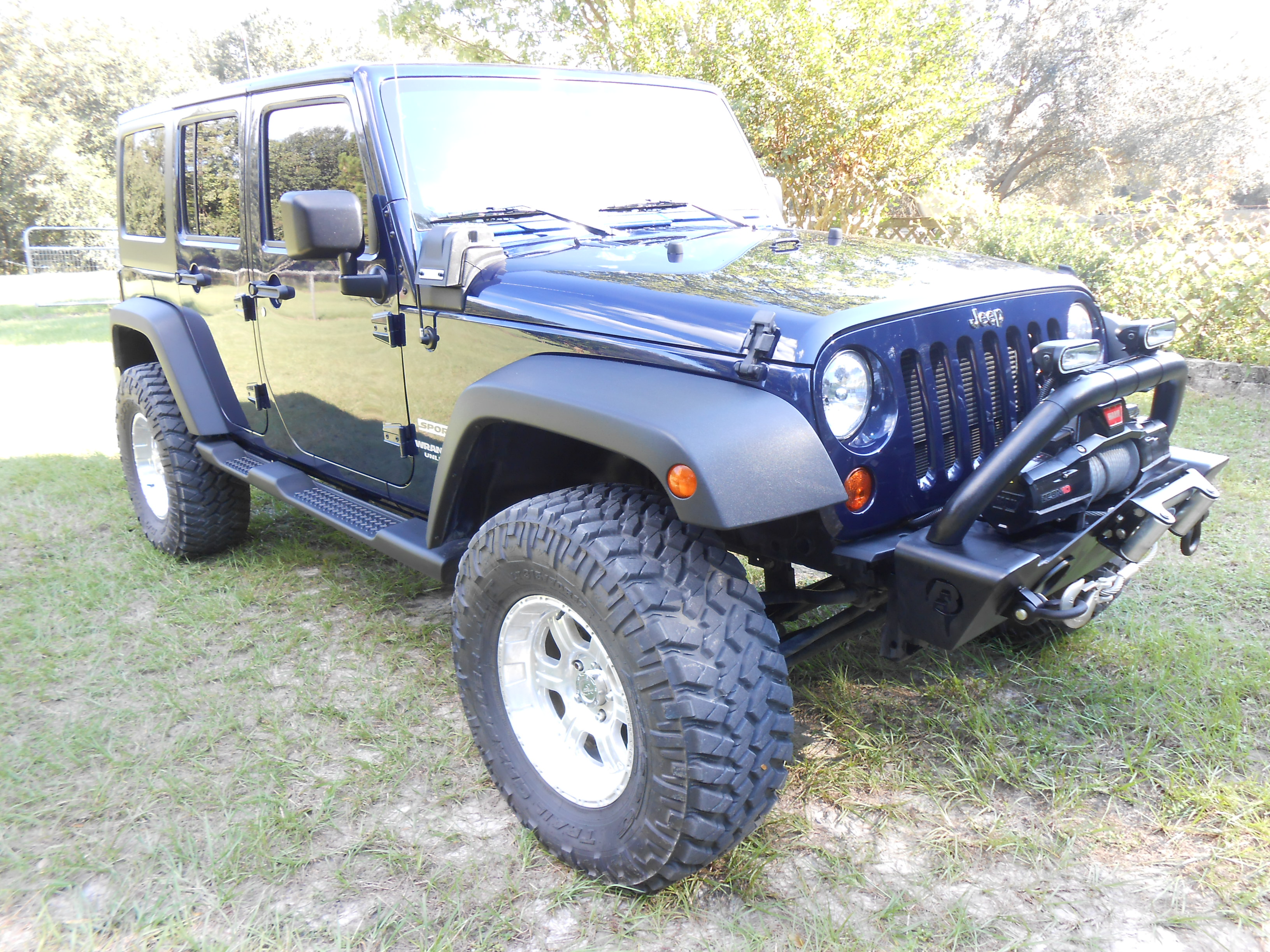

Originally Posted by DadsCJ
Running RK 2.5" with Bushwacker Flats and 37's.
Attachment 635319
But these tires are 35's not 37's.

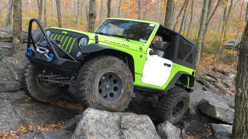

Running the 2.5" AEV lift, 37s, and trimmed fenders, and I wheel it without any issue. The tires run the frame at full steering lock but 99% of the time it's fine.

Definitely like those wheels. What are they?

Procomp 7069s. I like the looks as well but they are getting torn up in the rocks. Likely switching to a beadlock soon or at least something with a removable rock ring.
