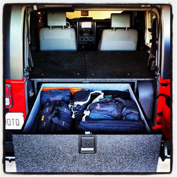

That is wicked. how long did it take you to put together? any pics of layout inside the draw or is it just a big draw?
He put it together in a day. Its a big drawer on guides. The guides were the expensive part. Bout $100 each. They each have a 250 pound rating. I did purchase the wrong guides tho. There are two kinds. 1) that allows you to remove the drawer from the box via a locking lever and 2) the ones I purchased are screwed in and if you want the drawer out you have to remove the screws. I have also added carpet to the inside of the box to keep stuff from sliding around and to dampen the sound. The top of the box is in two pieces. This way I don't have to remove my hard top to get the top of the box installed. I have also added aluminum tie down tracks on the top of the box to keep anything I put on top of the box strapped down and secure.......

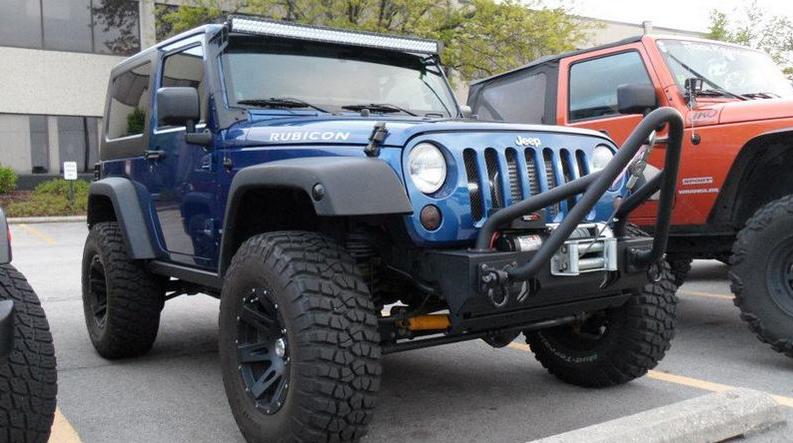

Pulled these off another thread. Tough light setup! be great on an expedition!
