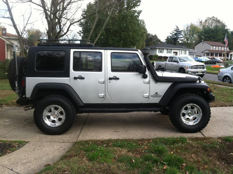

Just installed 37" MTZs mounted on Pro Comps new 5129 wheels with Bushwacker flat flares.
Currently undriveable. I had to order rear upper and lower control arms to move my rear axle back an inch. Even with trimming the pinch seam, I get a rub on bumps. It should all be fixed up on Saturday.
Before & After:

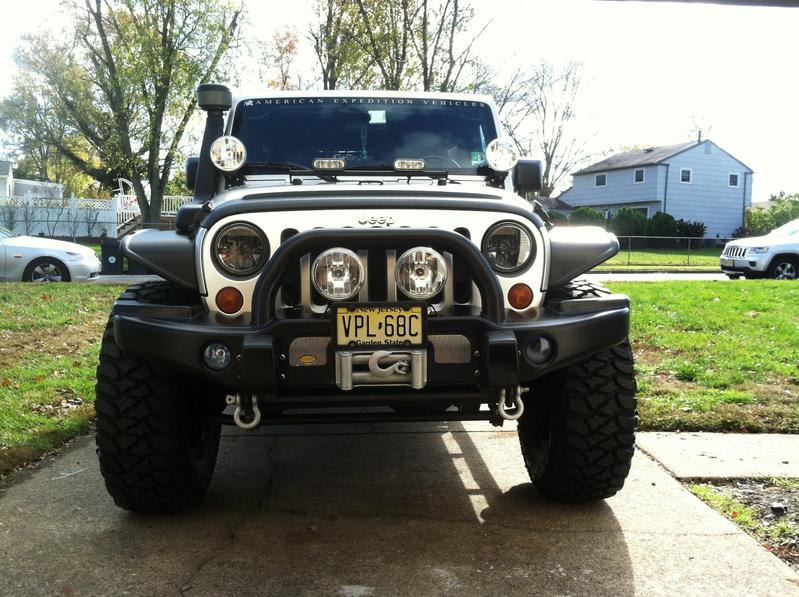

...and from the front:

What did you do with the 35s? Are they still in good shape? Hook a brother up
Looks great by the way!!!!
Thanks!
