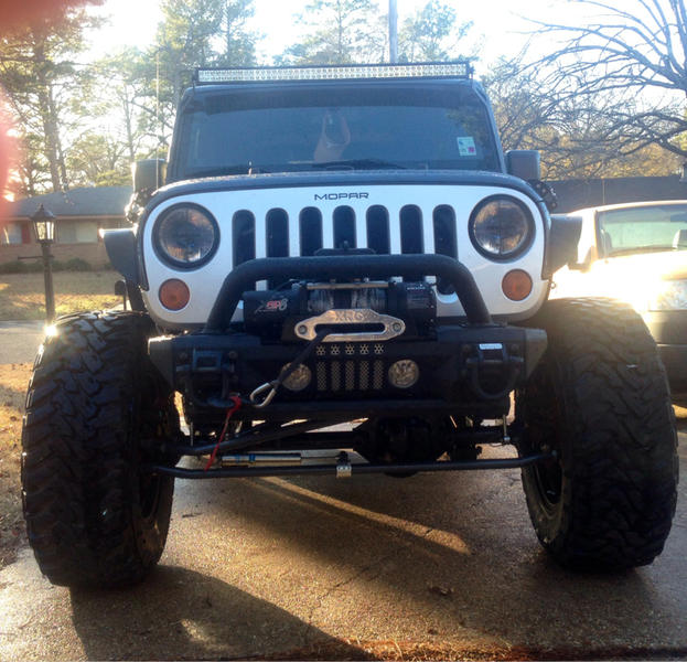

Old Jun 25, 2014 | 04:07 PM
cdenny's Avatar
Posts: 78
From: Shreveport, LA
These are 13.50's but actually measure out to 14.25"
