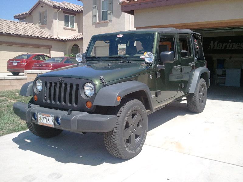

Originally Posted by StrizzyChris
what kind of prepwork did you have to do?
first put it on jacks then after deflating the tires down to 10 or so psi I took a wire brush very lightly scuffer up the entire rim and got it good and cleaned off of the dust the put on about 4 or 5 coats of the duplicolor

Originally Posted by jaker t5
Your rig looks great. Did you use paint or bedliner?
Old Oct 23, 2011 | 04:53 PM
jaker t5's Avatar
Joined: Aug 2009
Posts: 1,821
From: Wildomar ca
Bedliner on the grill

Bedlined grill, wheels and hinges.

Originally Posted by RubiBus
1.5 cans of Plasti-Dip. Trick I learned in the VW community. Clean with soap and water, let dry, then spray in even coats. If you decide you don't like it, or it ever needs to be redone, peel it off and spray again. Won't damage original finish. And the testure is very similar to the factory flares, bumper, etc.
So your saying you didnt sand or anything? Just washed it real well? Hows the paint holding up?
