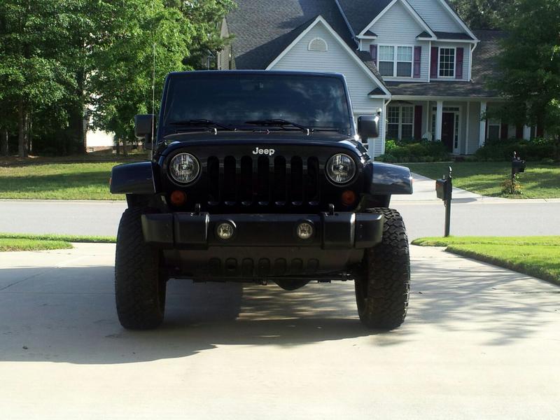

Just Got my done today and really like it.
