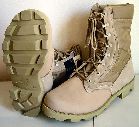

Originally Posted by jrhouse24
I found another material that could be cool. Anyone familiar with nylon cordura? I found some online for some 60" wide x the yard for $12/yard.
The only experience I have with this material is that I have a really good set of winter hunting boots that are made out of this and they are indestructable. I wear them when I ride AVTs and they've been through it all and look as good as the day i got them. As I understand it they are used on military issue boots. The website describs the mateiral as "back coated with a 3/4 ounce urethane coating." Sounds cool... In the picture the cordura is the portion of the boot upper that is not leather. Could be a nice material for when they are piled in the back of the jeep on top of each other and under a bunch of crap
Attachment 115831
