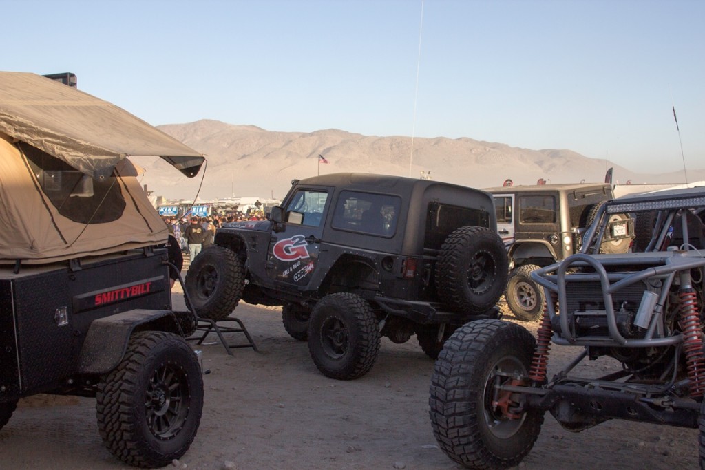

Did you happen to catch the picture on the front page of a 2-dr JK from King of the Hammers? If not, I copied it below.
Looks like a Safari-esque hard-top, any idea who this is from or if it's a one-off as well?
I don't like the lines of it as much as the one you've created, looks kinda bulky, but I'm just curious who made it and if it's on the market.

It's a 2-door version of a hardtop Smittybilt showed at SEMA in November. As far as I know, it's not on the market. Judging by the Smittybilt trailer next to it in the photo you posted, I'm guessing the top in question was there on display by Smittybilt. Nobody I talked to at SEMA seemed to think it was a good design, most people reacted the way you did. One person I talked to there thought it looked like a marshamallow. Here are a couple of photos of the JKU version I took at SEMA:
