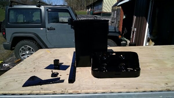

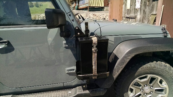

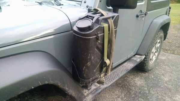

Consider it accomplished; I was "inspired" by your products to build my own Jerry Can Carriers, driver and passenger side. It's a hybrid of your TJ, with the vertical support, and the JK, using existing (windshield) hinge locations for the horizontal loads. 8000 miles, no issues. Removable in 15 minutes (10 to find tools) no holes in body, running board holes plugged w/plastic snap in plugs. I used standard issue Jerry can, Ammo box, Jerry can carrier. I like the rounded carrier.Click image for larger version
