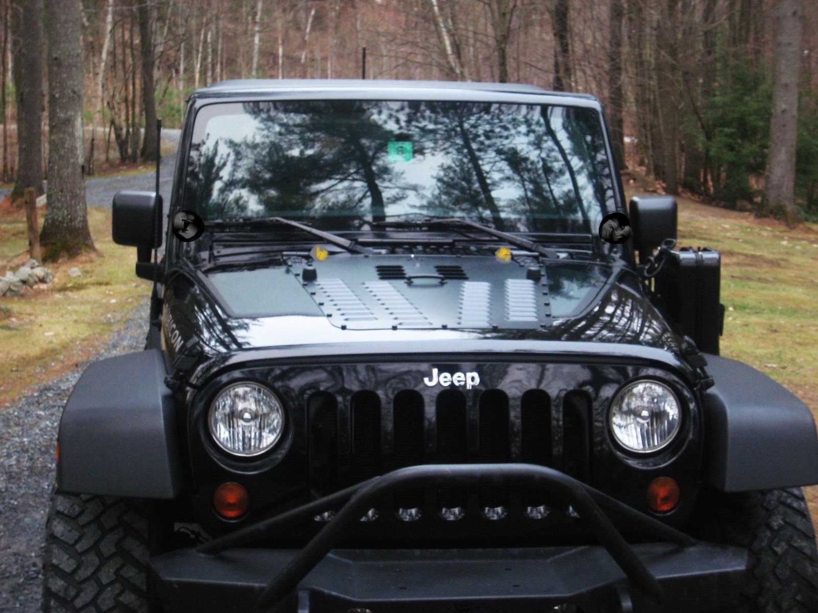

nor quality of the flex over the cheaper knock offs , have the hood hinge mounts become available on the site as advertised ?
also no wiring harness comes with the lights , has this been updated as to a harness that will work on these . i have not bought anything as of yet , still looking at kc flex lights because they include the harness and wiring diagram. also i noted that your pics had a black bezzel in some photos and are not shown , same with mounts not available on the site for these ones you displayed . i want to mount just two on my hood. prob on the posion spyder hood louver . would this work or reflect off hood as shown with yellow dots , im not sure if ill put pillar lights also or just go with the single flex ones on hood . im sure i could raise it with a spacer if need be. i wasnt degrading the lights , just seems like a incomplete system with out a harness for those of us who arnt into wiring automotive lighting . also does one need to shrink tube the leads ? it looked as though the red and black wires just hang out of the back with no protection , Im still interested but not convinced after buying all materials the kc flex lights arnt the way to go , how do those compare to your lights? id also want the black bezel as shown in your early pics . kc flex lights have optional black or interchangable bezels
in fact the hinge mounted triple set shown in this post show black bezel but cant see them on site or those style mounts , but i actually like the mount that comes standard with these anyway . is there a way to make them theft proof to some degree ? Hate for someone to just walk off with them i might buy two singles and see how they do. if i can resolve the unknowns otherwise the kc flex lights will do with a 27 year warranty i suppose . but i do like these lights of yours as well after seeing the pics . they come in flood and spots correct . i think floods would work better for me , i dont care for long distance as much as bright flared out to sides and some in front of me
did not mean to insult the lights or the concept just price could be better seeing you dont get all the materials needed to complete install maybe im wrong . but borderline of what i expected . ( i still might end up with these on my rig idk)
The Multipod lights compare very well to Flex lights in terms of brightness and beam pattern - the reason I recommended them to the company was that they have high quality optics that compare to "name brand" lights, the compact octagonal shape offers many interesting mounting options, and they're less than half the price of many name brand lights. They've also got high quality stainless hardware, which you want for the hostile environments Jeeps operate in.
I discussed wiring harnesses with the company when I was first working with them on these lights and we decided that since so many people have custom switch systems, SPods, etc., or have specific ideas about the types of switches they want to use in their Jeep it didn't make sense to increase the cost for everyone when many people might not be using a supplied switch, etc., anyway. If you search on "light harness" on eBay you'll find lots of choices that include switch, relay, wire, etc. for about $12 with free shipping, so for people who don't already have custom switch panels that's a good choice. The company might add harnesses like that to their web site if there's enough demand.
One thing to look at if you're considering the Flex lights - check the size of the wiring harness plug on the light and how close it is to the light itself - seems to me you'll have trouble fishing a plug that large through many places where you'd want to run the wiring. If you do chose the Flex lights make sure you know where you'll run the wiring and that there's enough room to fish the plug through or you may end up doing your own wiring anyway.
You'll have to check with the company on alternate bezel colors, I don't know what they have in stock or what their plans are. The bezels are easily removable so if you wanted a custom color, say to match a Jeep's body color, they would be easy to remove, paint and reinstall.
I'm pretty sure the company has all the custom jeep mounts in stock, including the hood hinge mounts but I don't know why they're not on the site yet, I haven't talked to them in a few weeks.
