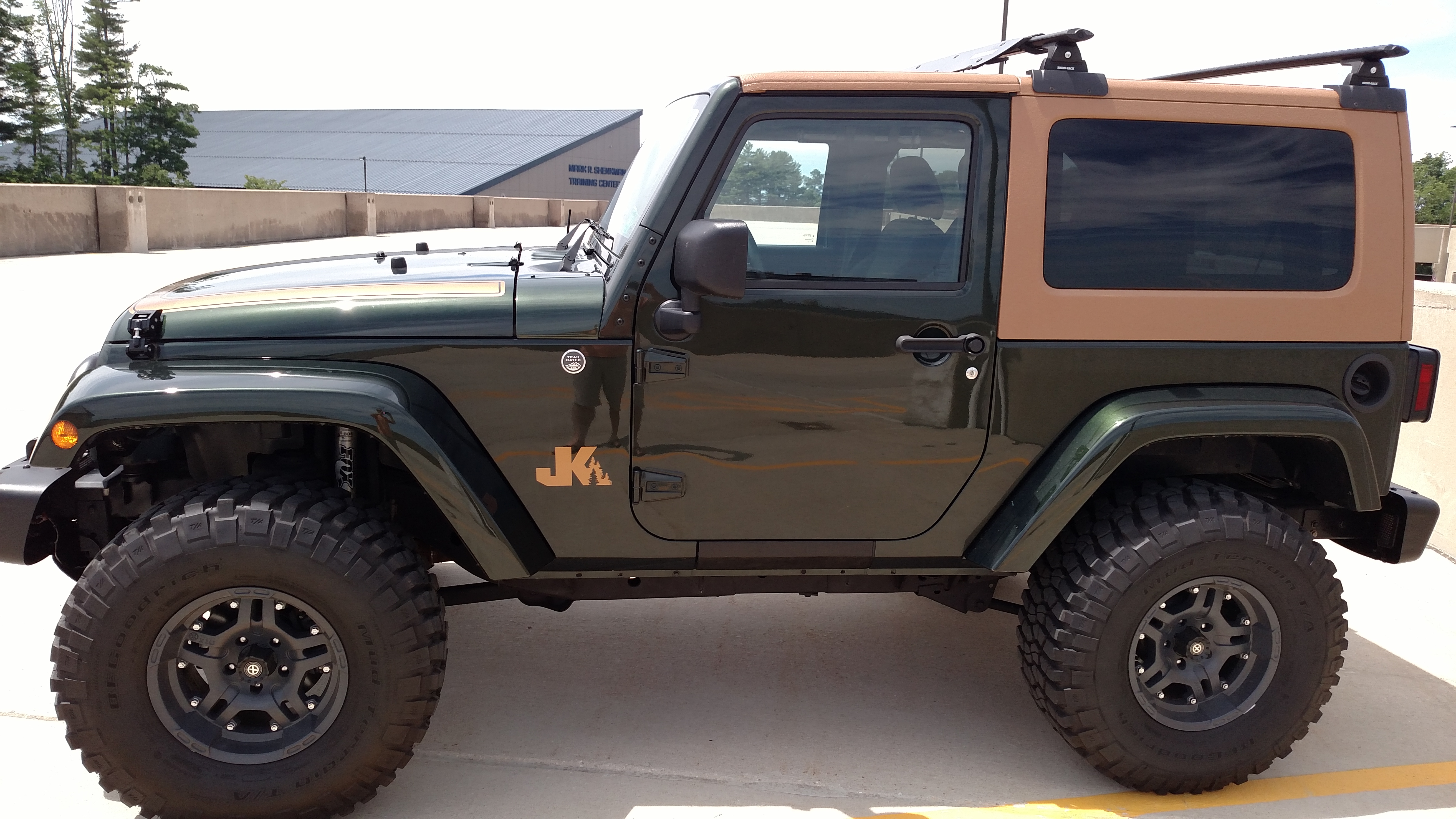

Not everyone is a fan of the tan but, speaking from experience, it looks good on a JK!
Attachment 649918
That does look nice.
Not everyone is a fan of the tan but, speaking from experience, it looks good on a JK! <img src="https://www.jk-forum.com/forums/attachment.php?attachmentid=649918"/>
I think it looks so much better than in black. I plan to do something similar with my factory hardtop. This is by far one of my favorite threads.
