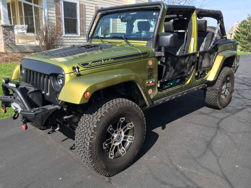

Is this available yet for JKU? Need to replace my hardtop before Winter arrives.
