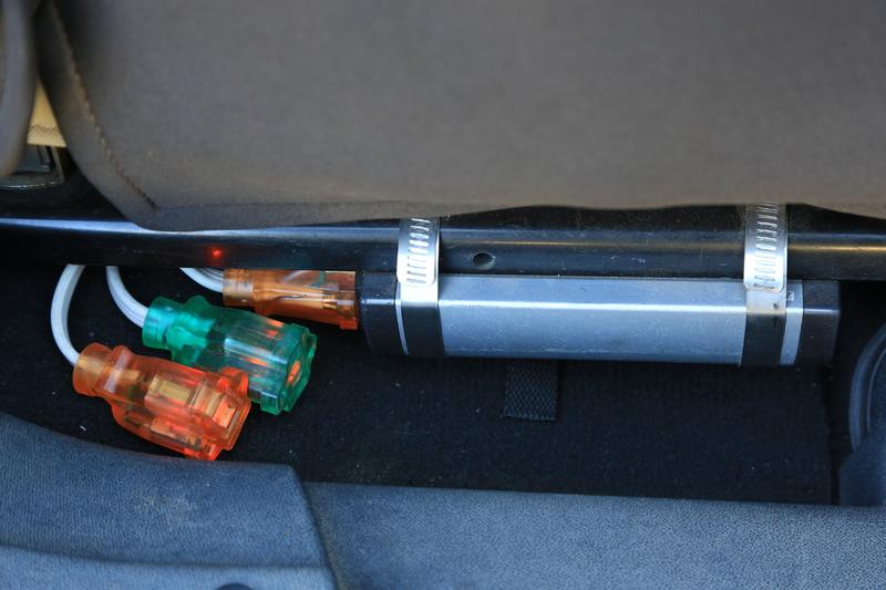

I'll start with the inverter: An old, 350-watt Radio Shack inverter I've had for years. I strapped it beneath the passenger seat (which area on the '07s has some OEM air bag weight sensors that they either left off or made smaller in later years). I hard-wired it directly to the auxiliary battery (dual batteries in my Jeep) using #12 gauge wire. The inverter has two power ports, but where it's mounted would have been awkward to use. So, I found a six-inch, dual outlet extension cord with neon lit plugs. I keep that plugged in, and everything gets plugged into it. "Everything" includes chargers for camera gear, laptop, projector (for showing movies while on the trail), etc. Basically anything that requires 115 VAC and that I don't have a 12 volt adapter for.

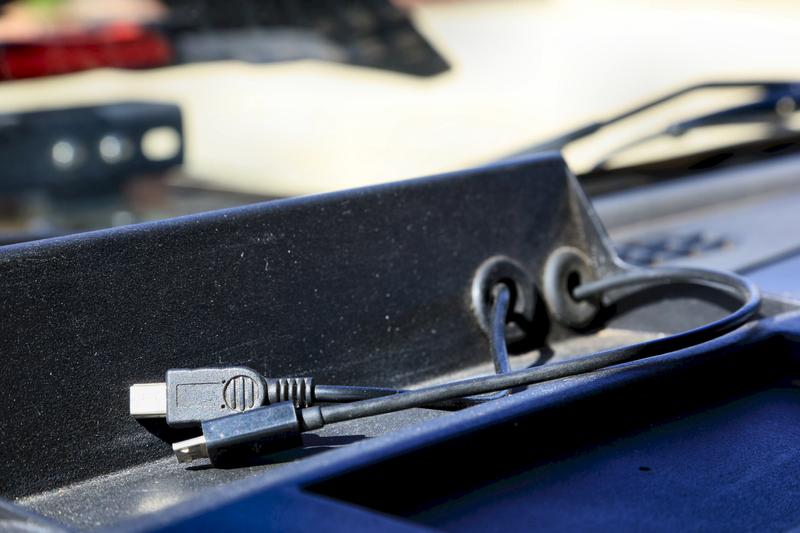

Next was powering the Nexus 7. The Nexus 7 (I have the 2012 version) requires 2.1 amps to charge and use at the same time. Anything less and it will slowly, but continuously, discharge. In fact, I've even seen where if I use it heavily, it can discharge faster than it's charging. For rock crawlers, it would last a day. But, when you're gone for a week or ten days, and you're depending on that Nexus 7 for primary navigation aid, that is unusable. I did a lot of playing around with various chargers and configurations, and what I came up with is reboot the Nexus 7 each day (I turn it off at night) to ensure that any power demands are only what you've recently used. And use this power adapter, with the Nexus 7 plugged into the NA port: amazon.com/PowerGen-4-2Amps-charger-Designed-Android/dp/B0088U4YAG/ref=cm_cr_pr_product_top
As described, one of the cables is routed behind the center console bezel to the other side where it can be plugged into my Nexus 7 ...

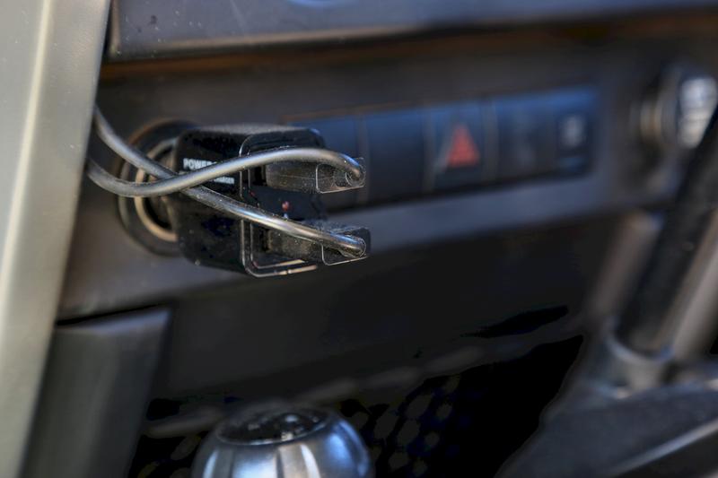

The other port, because I'm demanding 2.1 amps from the NA port, will only provide 1 amp max (sometimes less, depending on what's plugged into it). This can be reversed for Apple products, but again, the charging rate for the NA port (in the case of Apple products) may not be the full 1 amp. Without getting technical, I'll just say this is Apple's fault. They have not complied with the USB spec for powering devices, and the way they do it has made devices usable across all USB charging needs mostly incompatible. This one is the best compromise out there. Some of the more recent Android devices have workarounds in the OS that actually make this a bit better. Bottom line is if you run two Apple devices or two Android devices, you may not get full charging. This device works best if you run one of each plugged into each port. Having said that, I have had good results with the Nexus 7 plugged into the NA port and my Nexus 5 plugged into the A port (and a Galaxy Nexus before that worked fine as well). The worst that will happen is the charging rate on the incompatible port will be reduced from 1 amp to about 0.5 amps. If you're not using your phone a lot, that should be sufficient to still charge the device over time. And who out in the middle of the Mojave Trail is able to get a signal to use their device? LOL Anyway, I routed that other (A) port to a micro USB connector coming out of the back of a hole I drilled in a Daystar dash tray. I use that to keep my phone charged ...
You will also notice in the above image a mini USB connector. That connector is hard-wired to the cigarette lighter wiring behind the dash (ignition switched, IOW) with a USB power device designed for motorcycles. I use it to charge the GoPro that's not mounted to the windshield (more on that momentarily). This is the device: amazon.com/gp/product/B002ALTKBM/ref=wms_ohs_product?ie=UTF8&psc=1

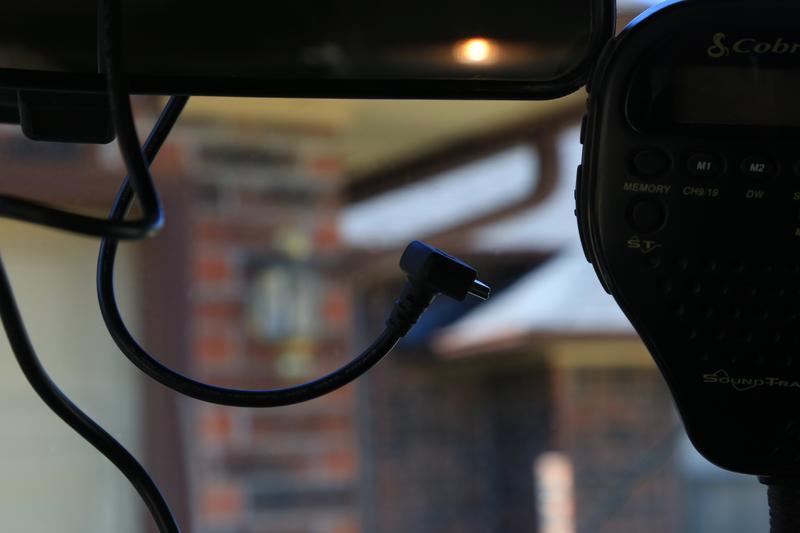

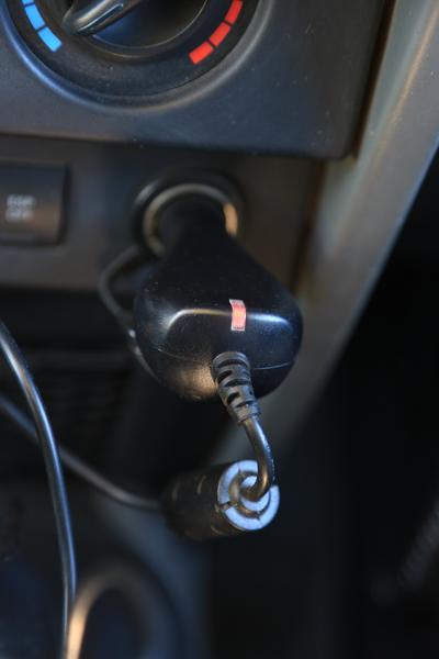

Next, I run a GoPro on the windshield most of the time. I learned (I plugged it in and it worked!) that the power adapter for my Garmin Nuvi 550 would not only charge my GoPro, but let me leave the GoPro on at all times and keep me from having to turn it on and off to save it's stamina-deficient battery. Turning it on was really a nuisance because a lot of times after the GoPro's ridiculously lengthy boot time, whatever I wanted to capture was over. And leaving it on meant the battery dying in a couple hours, even if I never recorded. So, I plug the Garmin Nuvi adapter into the power port (always on, even with Jeep off), and use it's mini-USB connector to power the GoPro with a Skeleton Housing (allows connecting things to the GoPro, unlike the water-resistant housings that come with a GoPro kit). This is what that looks like ...

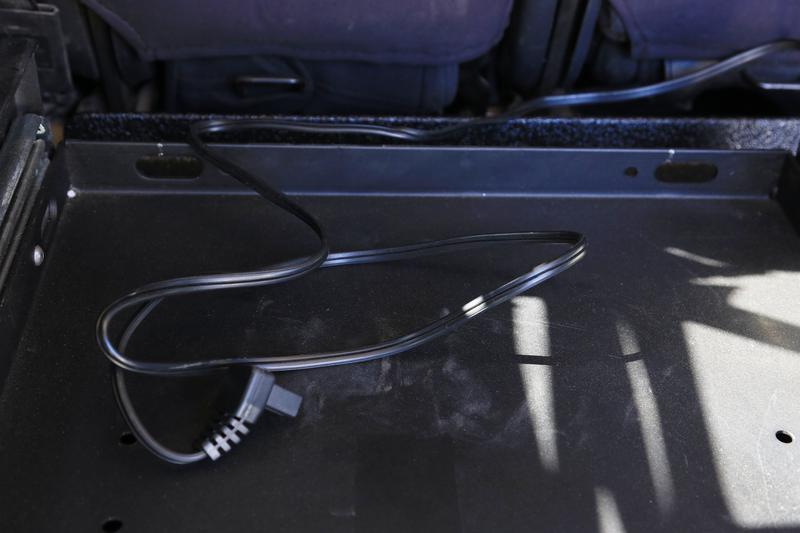

Finally, not having a power port in the back of the Jeep, I found it necessary to wire one in myself for the refrigerator. Again, Used #12 wire directly from the aux battery, to a cigarette lighter cable adapter I bought from Radio Shack, which is hidden under the rear seat. The cord for the ARB fridge then plugs into that, with enough extra to allow it to slide out on the Tembo Tusk slide (brand new mod, still in work) ...
And that's it! I've found that this Rube Goldberg solution provides me the power I need to the places I need it.

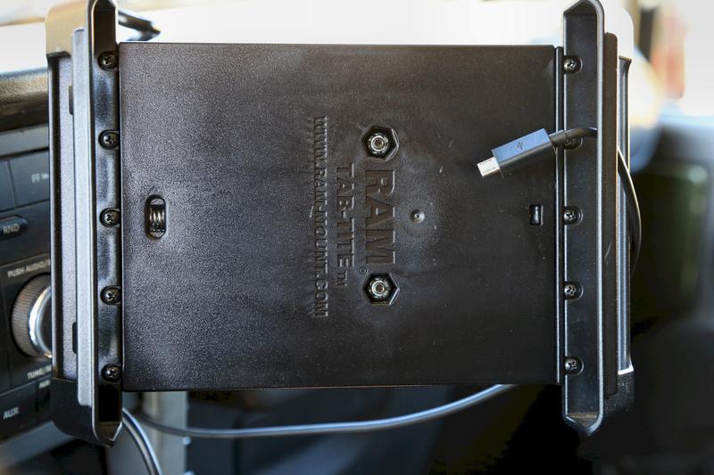

Attachment 533851
Attachment 533852
