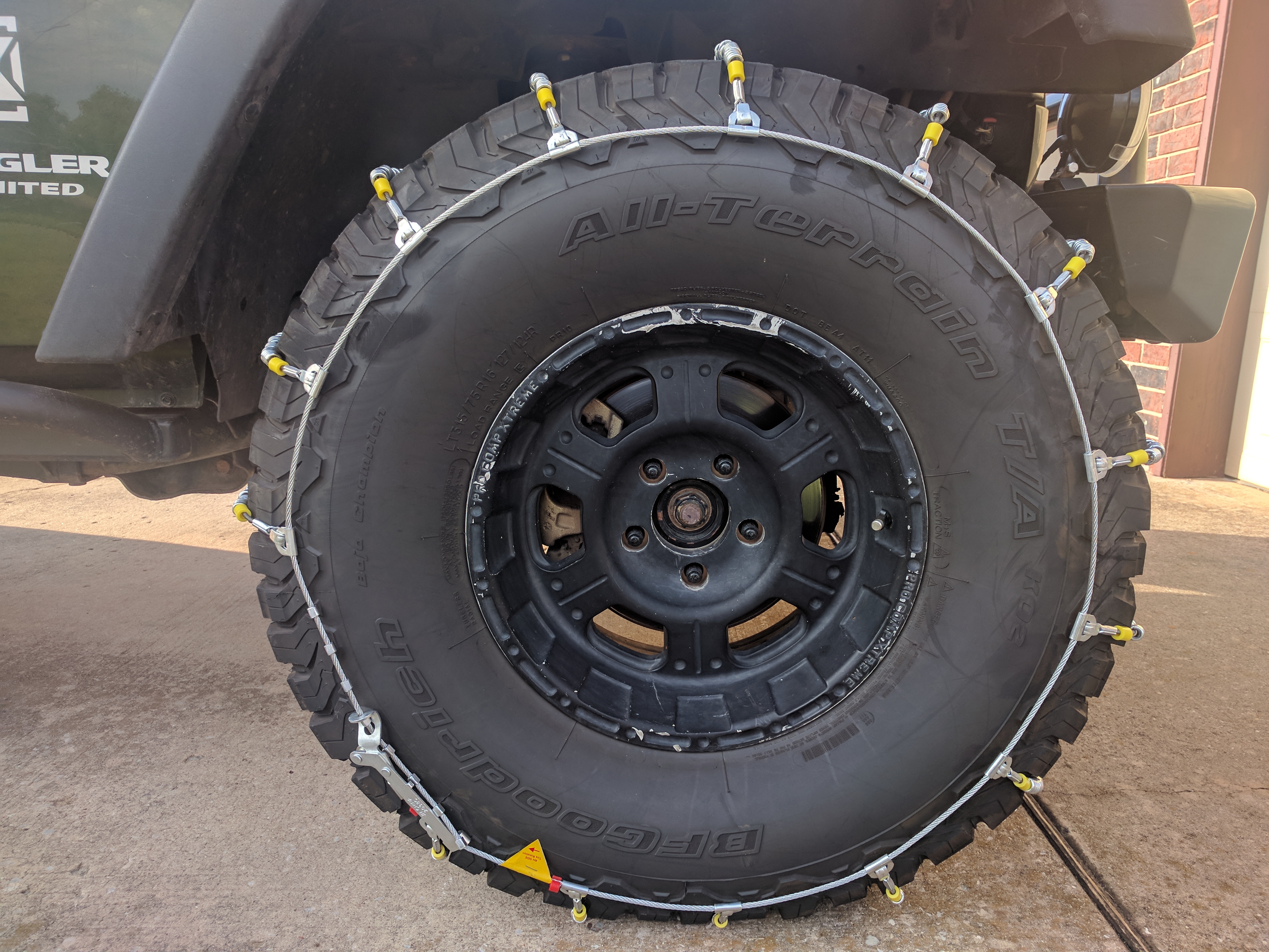

New kit to be prepared for future trips ...
Old Oct 7, 2017 | 03:15 AM
  #6219
dmwil's Avatar
Posts: 1,448
Likes: 42
From: Danville, Indiana
Attachment 675333
Mark, those look like K02's. How are you liking them? My KM2's are nearing replacement time, with about 60k on them. I'm going back and forth in my mind between another set of KM2's, or K02's, for a slightly softer ride and better traction on snow packed roads. The KM2's have been great on everything but snow, and the sidewalls are super tough. I'm just weighing the pros/cons. I've been very pleased overall with the KM2s.
The chains look great, btw. You must have some mountain passes in your future!
Old Oct 7, 2017 | 03:35 AM
  #6220
karls10jk's Avatar
Posts: 5,642
Likes: 486
From: Knoxville
Piggybacking on dmwill's question- you've been through plenty of the duratracs in the past, why the switch to ko2's? I'm running them now as well, but I switch tires every couple of years in search of the 'best' tire for my usage.
