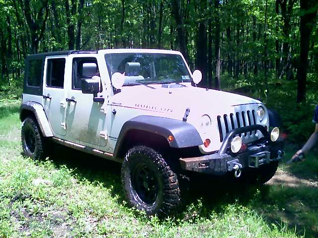

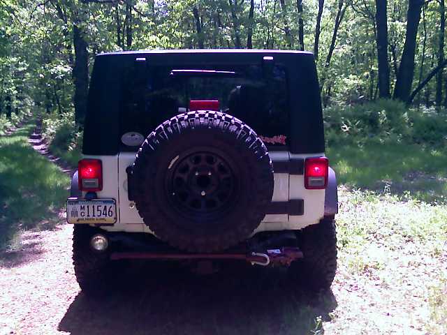

I've been bitten by the expedition bug too!
My days of rockcrawling were fun, but I like to have a destination and enjoy the view instead of just pounding the crap out of my rig for something to do.
Just ordered the Rugged Ridge snorkel and plan on a roof rack at some point down the trail.

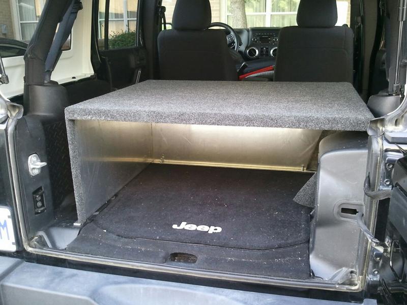

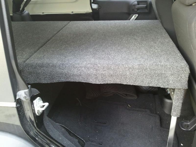

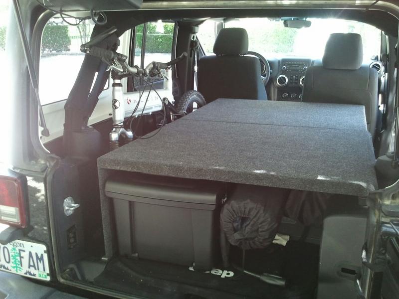

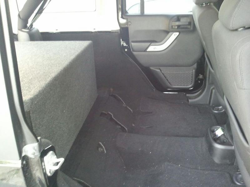

I'm going to move towards equipping my JK for expeditions. There won't be anyting serious to start but my first mod is this rear storage/ bunk area. I built it with cardboard for a template then found a local metal working shop to have it built. I was able to do it with one sheet of 4x8 of aluminum, which was the most expensive part of the project. I used 5052 series, 3/16. From the research I did that is one of the most rigid series that you can still bend at 90 degrees without it cracking.
I built it in two sections. The rear will stay in place virtually all the time, although I bolted it down using the existing tie down bolts near the front of that box section and on the side. The front piece is bolted to the rear and can be removed easily when I want to reinstall the rear seat. I am on an extended road trip now and wanted the extra space.
As you can see from the photos I left a few inches on the left side of the rear piece so I could have my bike inside and still be able to sleep on the rack. It's 37" wide and 5' long. When I want to lay out I move the front seats all the way forward, tilt the backs forward and have about 76" from the back glass to the rear of the front seats. That fits my 72" frame fine but I also have extra room as I lay in the middle and my feet basically go between the front seats. Yes, there is about a foot of space between the front of the rack and the back of the seats when they are forward, but I roll out a sleeping pad and it is supported on the center console which fits right up to the rack. Works out well.
I wrapped it all with carpet and glued it in place.
Overall I am happy with how it turned out. Total cost at the metal shop including the aluminum was $481.00. Another few dollars for carpeting and glue and I put the project costs at about $500.00.
