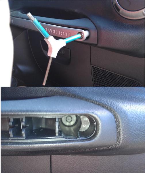

Remove the insert in the grab handle (9mm allen bolt is not actually holding it in, it's just press fit)
That will uncover the bolts holding the grab handle.

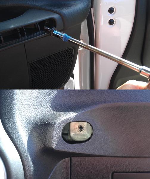

Remove the 2 - 5/16" hex bolts holding the grab handle.
Remove the handle to expose the mounting hole (large uneven hole)

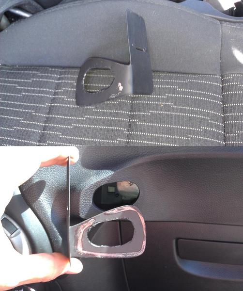

The shape of the bracket that goes around the grab handle mount was a little difficult to get right (several test fits)

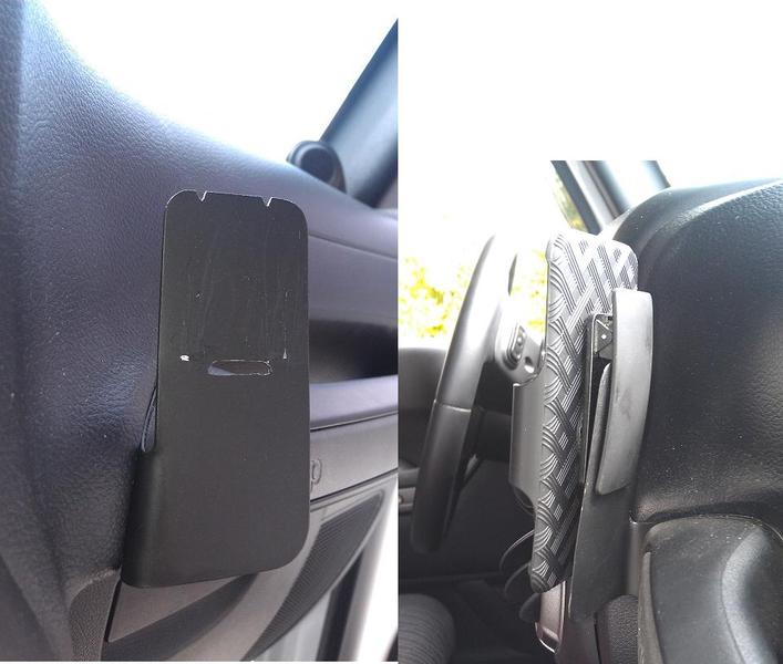

I made the shape of the clip mount part to fit my clip and bent it by hand to get the right angle and painted it black (paint wasn't quite dry).

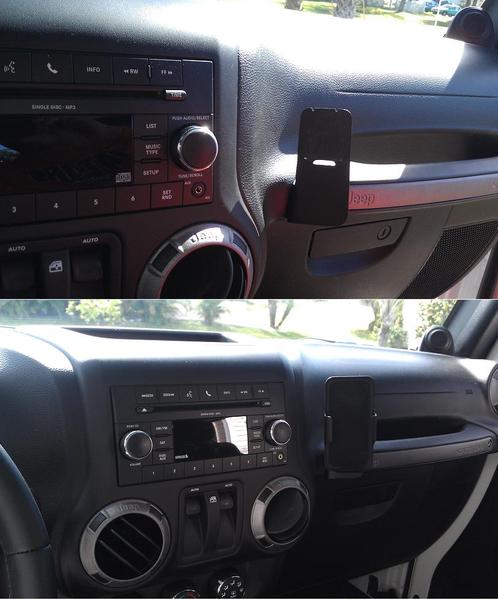

Bolted it all back together and it works perfect. It's real handy when using the phones navigation app.

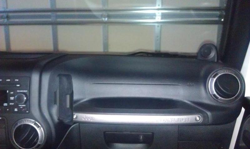

Looks great! Is it out of the way of the airbag? or is there going to be a cellphone shaped mark on somebodies head?
Just asking, i thought about mounting my Ham mic mount similar to that but decided the Airbag was gunna take it out if it ever went off.

I'm not sure what shape it is when it deploys, but I think it will/may clear the air bag.
