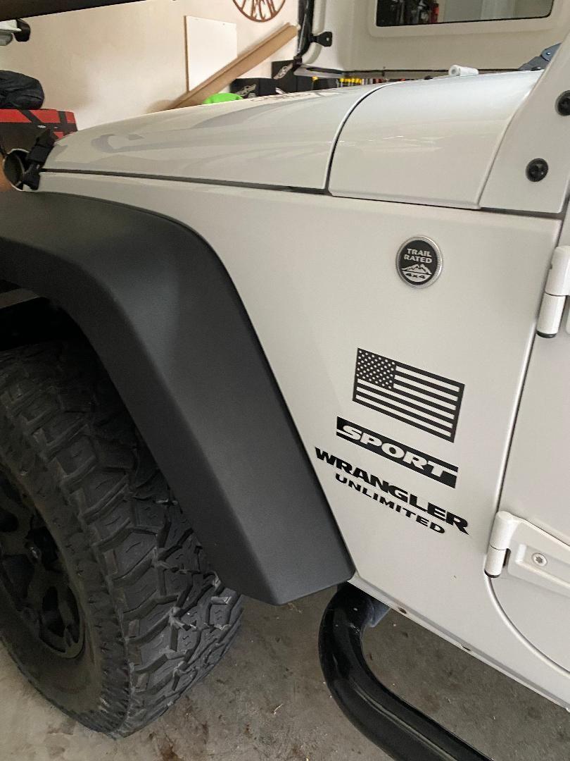

My wife ordered a couple of the magnetic US Flag Decals. I'm not a big fan of adding decals but I think these things look good.

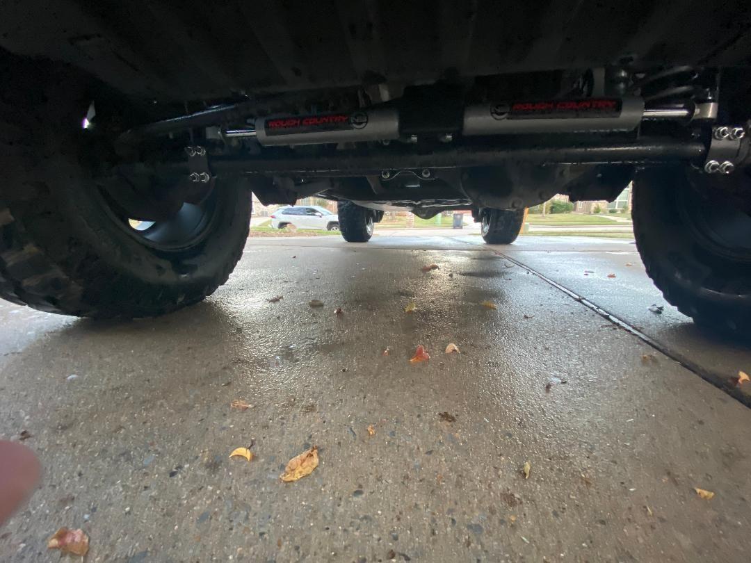

While I was out and about this past week I felt a shimmy in the steering wheel I have yet to experience since adding the lift and the 35s. It wasn't the feared death wobble but I believe it could lead to it. I plan on taking it for an alignment soon but I did go ahead and add a dual steering stabilizer in the mean time to see if they help with the extra shimmy from the larger tires. So far no shimmy.
If you have any suggestions beyond the stabilizer just being a band aide let me hear from you!
Rough Country Dual Steering Stabilizer

Well, you know what I'm gonna say about the SS so I'll refrain. It's good to get acquainted with your steering components on these things. The larger tires just stress everything. I would agree with the assessment that if you don't address this it could eventually turn into full DW, cuz that is pretty much how things work. You have alleviated the symptom, now it's time to figure out the culprit. The first and easiest thing to check is torque on the TB bolts. In fact, anytime you mess with your suspension bolts you should make a habit to double check torques a few hundred miles down the road. The most common causes of any wobble are undertorqued TB bolts, bad TB joints, and bad ball joints. There can be other culprits, but these are the most common. The TB joints are new with the lift so that is not a concern. I'd test out those ball joints. It's a good idea to test them every oil change IMO as it's simple. Jack up the front axle so tires are just a couple inches off the ground, support with jack stands to stabilize (easier to just work with a stabile axle than with 1 tire on the ground and 1 in the air IMO), and put a shovel or something under the tire.....step on the handle using it as leverage to force the tire up. Inspect for movement where the knuckle meets the C by the upper BJ. It's the lowers that fail but it's easiest to spot the movement here. You might notice some flexing, but you should not see that knuckle kinda hopping up/down, and you sure should not hear any clunk.
To me, a bad BJ typically feels a bit more like a shimmy. Think of being on a highway with uneven lanes and what it feels like as you transition between the higher/lower lanes. A bad DL joint has always results more in a bumpsteer to me when you hit a hole or bump in the road. TB issues, bolts or joints, have always felt like more of a pure wobble effect. Get a combination of 2 culprits and boom, you end up with full on DW. My experience has been with 1 bad thing you kinda get by with side effects. 2 is the real magic number. Though, once one goes bad it stresses all the other components even more.
