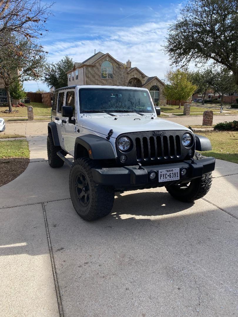

Blacked out the grill. Used the black bed liner spray. Looks good, and is very durable to rock chips and bugs. I think it could use one more coat.

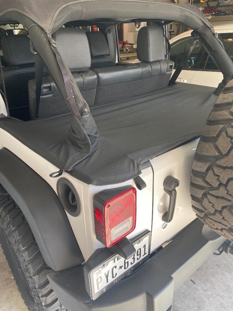

I plan on having the top off this thing majority of the time this summer so I went out and purchased a smitty bilt tonneau cover so that if in fact I do have something in the back it'll be hidden from view and when the doors are off I have a place to throw things and not strap them down. The cons are that I only have about 16 inches height under the cover so when/if I need the rear for anything bigger I'll have to remove it.

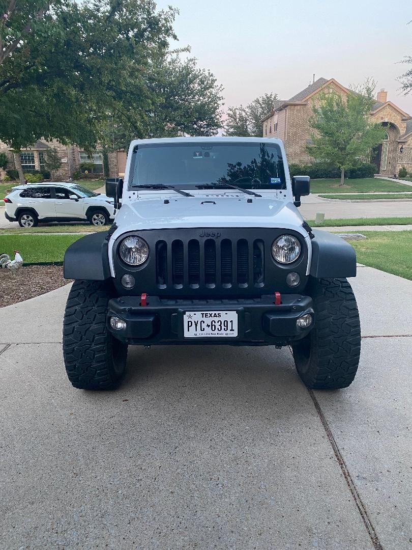

I've been on a lookout for the OEM Hardrock Steel bumper for quite some time. I like the simplicity to it and the fact that I know it'll be a quick bolt on and when I do end up adding the winch it will set below the grill. I ended up adding LED Head light bulbs and fog light bulbs which are 1000x better than the OEM bulbs.

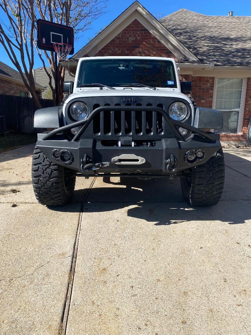

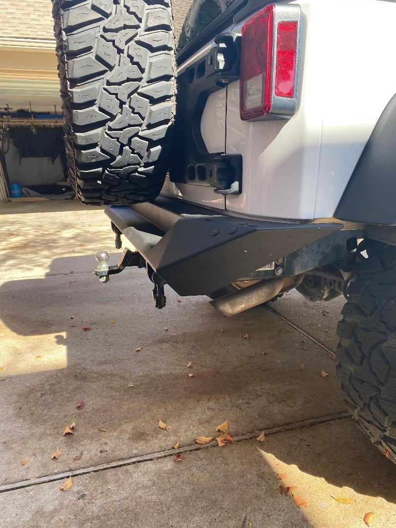

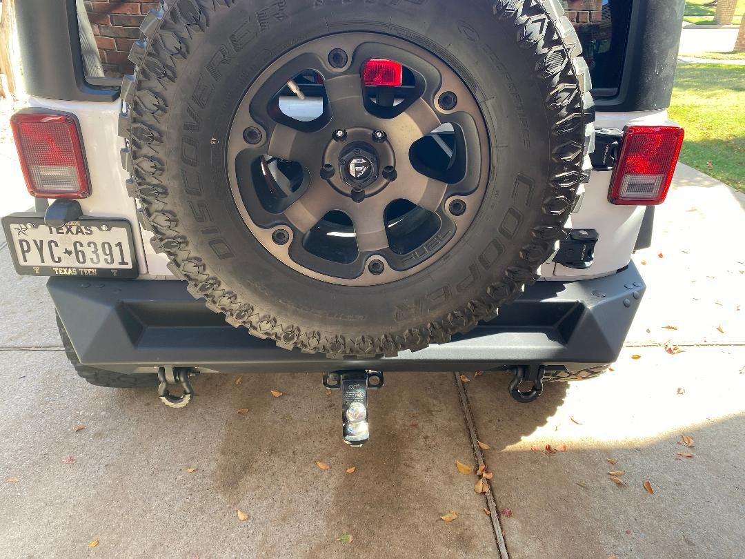

Things have been quite the past few months... have been debating the Rubicon Hard Rock Bumper. Adding the winch to that bumper plus the bull bar are not budget friendly.
One day I walked into 4WP to kill some time and I saw that they were selling their display bumpers. There's a Fab Fours bumper combo sitting there marked down to $800 for the front and $500 for the back... I thought that seems like a great deal but I don't have $1300 to throw at a set of bumpers. A few weeks later I walked in to pick up something and those bumpers are still there and the guy told me $500 for both. I laughed thought there was something wrong with them. I looked them up online and read the reviews and couldn't stop thinking about the front bumper. I called the next week and asked if they still had them, and told them I would take the front for $250 but only the front bumper... thought I'd offer them $50-100 for the rear bumper when I picked up the front. About 15 minutes later I got a call.... "the big guy said you can have the rear for FREE!" SCORE!!! Fab Fours bumper combo for $250. Yes, these were displays but still in pretty great shape but miss matching lights on the front bumper and was missing hardware for the rear.
To finish the front I had to purchase the passenger side fog light and signal light to match the drivers side.
The rear bumper was missing a couple of mounting brackets... I called Fab Fours and told them what all I had, turns out I was missing two bracket. A week later I had the two brackets and a hardware set from them for around a hundred bucks.
Then 4WP had a sale that was worth something and I picked up the Smittybilt 10k winch for $500.
That's definition of Jeep Build on a Budget!!!
